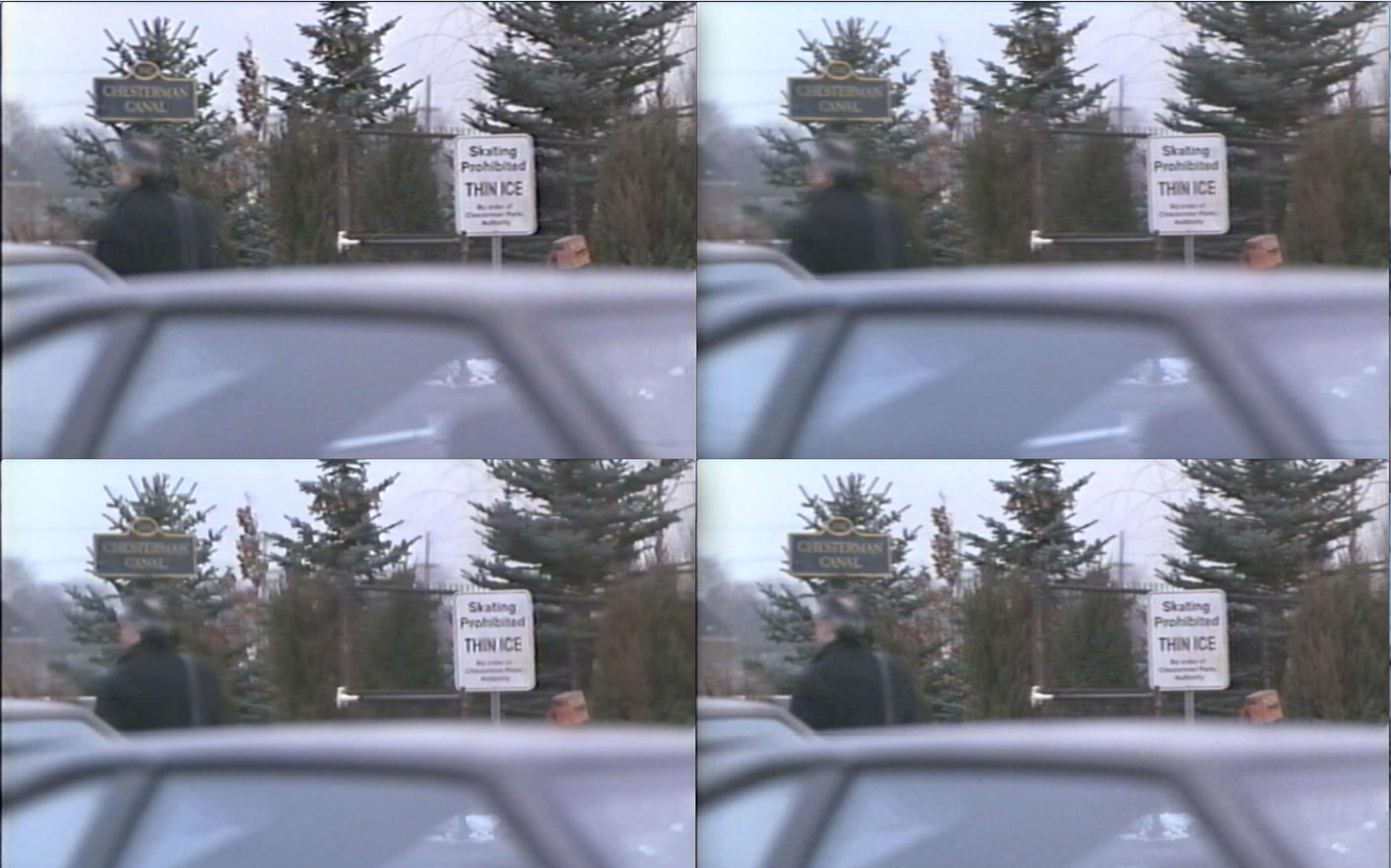

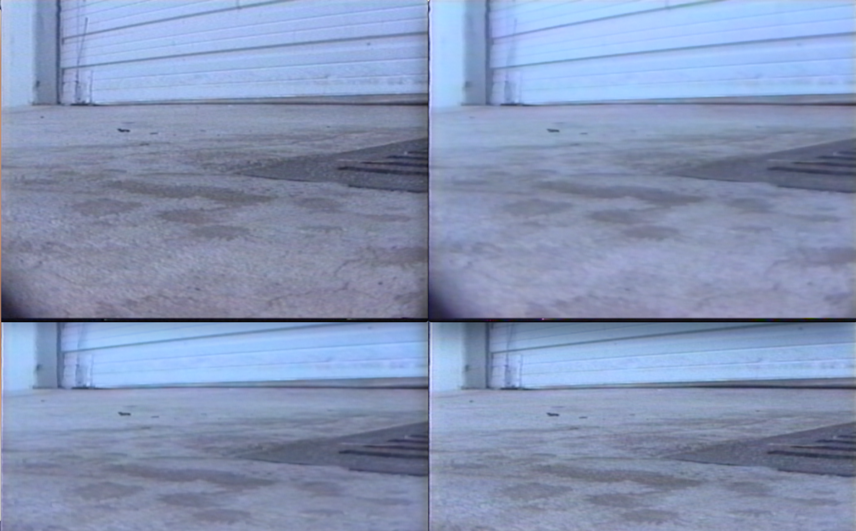

  14. Image
    [Attachment 46386 - Click to enlarge]
    [Attachment 46387 - Click to enlarge]
    I did some tests and hopefully the attached pics show up large enough to tell, but:
    UL=Mom's RCA,
    UR=JVC S-Vid NORM,
    LL=JVC S-Vid SHARP,
    LR=JVC S-Vid EDIT.
    Those modes do make a large difference. You're right lordsmurf, I now just have to choose which of the 4 bears I like best. I'm still blown away though that in side by sides it's not in any way obvious which photos are RCA and which are S-Vid. Interesting comments about NR. I think I'll play around with these clips in Premiere Pro or DaVinci to see what the overall best look I can get it. Turns out I did go through the menus before, but the manual says stuff like "Use Edit when you dub tapes" so I had no idea what that even meant. Thanks for the detailed explanations. Thanks so much for all of you who told me to check the different modes because I'd totally forgotten about that. Back when I was going through the modes it wasn't about image quality, it was to figure out why I had trouble capturing audio properly (which turned out to be Premiere Pro's problem which is why I'm using that old version of iMovie and such a ridiculous workflow.
