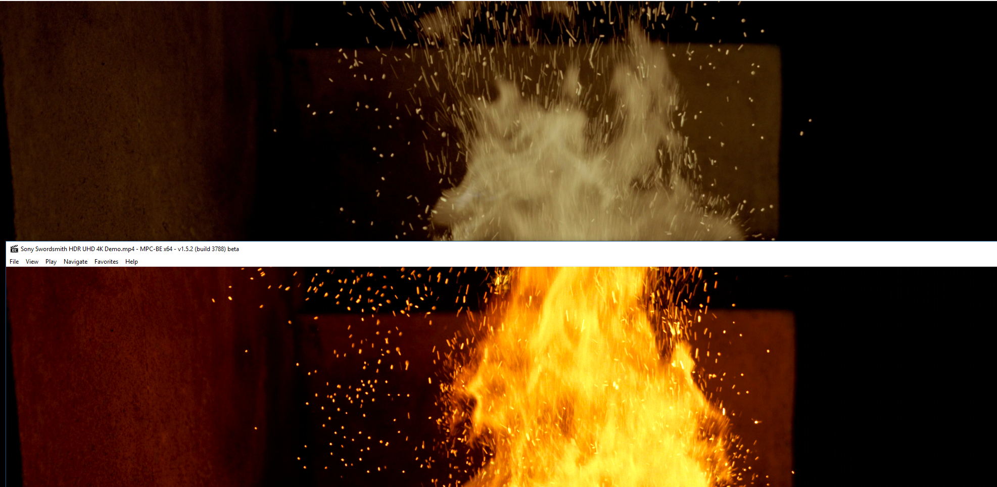

  1. I'm trying to learn how to do encode x265 through MeGUI and for some reason the color on my encodes are faded. I tried reading about it on doom9...something to do with BT.2020 and using dither to correct, but still having same issues. I uploaded a sample. The top is my encode and the bottom my source.

Name:	color discrepancy.png
  2. Not being a MeGui-user for years, here's my two cents:
    What does MediaInfo say about the output?
    What are your encoding settings?
    My guess is atm. that you are converting HDR content:
    a. to SDR without doing any HDR->SDR mapping
    b. keeping it as HDR, but forgot to set the needed
    Cu Selur
    Ps.: no clue whether MeGui even supports HDR->SDR out of the box (or if one would have to manually edit the Avisynth script), but that can probably be cleared up by someone using MeGui
  3. Dinosaur Supervisor KarMa's Avatar
    Jul 2015
    US
    Megui has no HDR-->SDR tools that I know of. Off the top of my head RipBot264 has HDR-->SDR support. I've never tried it so I can't speak more than that.
  4. Originally Posted by OrionZodiac View Post
    Mastering display color primar : R: x=1.000000 y=1.000000, G: x=1.000000 y=1.000000, B: x=1.000000 y=1.000000, White point: x=1.000000 y=1.000000
    Mastering display luminance : min: 0.1000 cd/m2, max: 1 cd/m2
    Those values are bogus, btw. Work with a non-broken source if you want to learn. (The things Selur and KarMa said apply nonetheless.),
    If you want to keep HDR encode to HEVC 10 bit and set the metadata like source. For x265:
    https://x265.readthedocs.io/en/latest/cli.html#vui-video-usability-information-options
    To convert HDR to SDR in AviSynth you can use for example:
    DGTonemap (software) or DGHDRtoSDR (CUDA/Nvidia)

  5. Originally Posted by sneaker View Post
    Or instead AviSynth a ffmpeg can be used:
    https://stevens.li/guides/video/converting-hdr-to-sdr-with-ffmpeg/
    https://forum.doom9.org/showthread.php?t=175125
  6. man, you guys are awesome. I think this is what I was looking for. I will try it and see what happens. Seems like I will need to convert HDS -> SDR...thanks for all the links. I will read those and see what I can come up with
