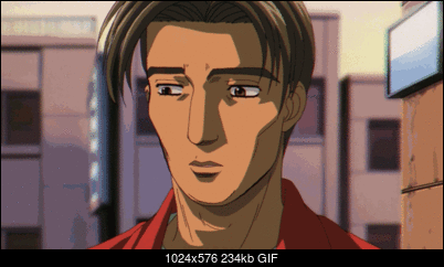

  4. The film frame was moving as it was being digitized.
    There's no way to align the two frames. Dup() converts near duplicate frames to duplicates. With a high threshold it will see those two frames as similar enough to replace one with the other. But with a threshold that high frames with true small motions are replaced too -- like frames where just a character's mouth is moving, or eyes are blinking.

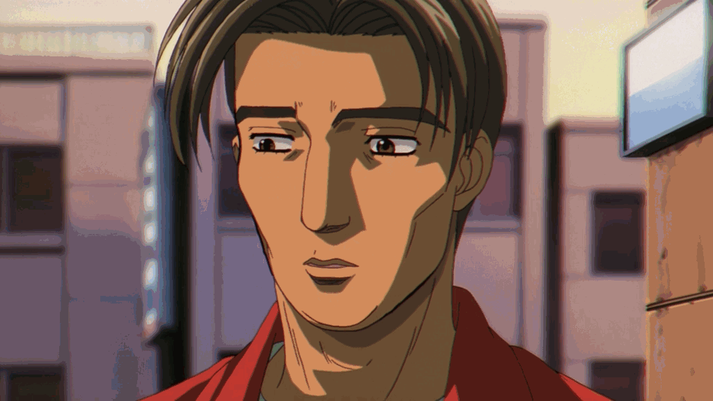

    Do you happen to know why it looks as if stab is adding artifacts to the video? It looks like it is sharpening it and adding grain or blocks on the video making them much worse than before.
    Zoom in on these 2 images to 200% - 300% and flip through them. It will be very obvious what I am referring to.
    https://mega.nz/#!EtJ3EYaZ!P3RBg7G8kpeBANzwhIQXqhHZrGIToyL8Se84KkaPLbY
    I also have these 2 video clips. One without and one with stab to show what I am talking about. The moving blocks or artifacts are more noticeable.
    https://mega.nz/#!V1RDEAJQ!l65YCOtSKO9-94cNNGnxOZ8WHICClmx0gHIrc2KF2wc
    View it in fullscreen starting at the 12 second mark and look at the left collar on his green jacket around his neck. It flickers brightly for some reason and does not in the version without stab. That flickering is very annoying and or distracting.
  25. Actually updating depan fixed both the green tint issue and the flickering I mentioned with those 2 video samples. Thanks for bringing that up!
    It still looks like it is sharpening the image and adding the grain/artifacts like in the images, but the green tint and bright flickering has stopped.
    Whats up with the artifacts?

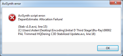

  27. Well I am trying to use stab on selected frames only. It works fine until I call it about 18+ times and then it always gives me an error. I have several trims to use it on and I certainly need to be able to call it more than 18 times.
    [Attachment 46642 - Click to enlarge]
    It seems to be this line in the stab avsi giving me all the trouble.
    mdata = DePanEstimate(inter,range=range,pixaspect=PAR,trus t=0,dxmax=dxmax,dymax=dymax,zoommax=zoom)
    and also this one (line 17) when the error changes after I exit and reopen MeGui
    DePan(inter,data=mdata,offset=-1, mirror=mirror )
    I tried stab2 as well and its giving me the same issue. Why cant I cant I get this to work?
  28. Originally Posted by killerteengohan View Post
    How exactly are you doing that? Maybe you're running out of memory. What about calling it only once and using ReplaceFramesSimple()?
  29. Originally Posted by jagabo View Post
    I am doing it like this.
    I am selecting all the frames I want to stabilize and the frames I do not want to stabilize, then I am doing the rest of the filtering once that's finished.
    __film = last
    __t0 = __film.trim(0, 834)stab()
    __t1 = __film.trim(835, 3341)
    __t2 = __film.trim(3342, 8461)stab()
    __t3 = __film.trim(8462, 11551)
    __t4 = __film.trim(11552, 21088)stab()
    __t5 = __film.trim(21089, 21741)
    __t6 = __film.trim(21742, 23979)stab()
    __t7 = __film.trim(23980, 24111)
    __t8 = __film.trim(24112, 25172)stab()
    __t9 = __film.trim(25173, 25412)
    __t10 = __film.trim(25413, 25462)stab()
    __t11 = __film.trim(25463, 25653)
    __t12 = __film.trim(25654, 26050)stab()
    __t13 = __film.trim(26051, 26133)
    __t14 = __film.trim(26134, 26407)stab()
    __t15 = __film.trim(26408, 26456)
    __t16 = __film.trim(26457, 26532)stab()
    __t17 = __film.trim(26533, 26653)
    __t18 = __film.trim(26654, 27762)stab()
    __t19 = __film.trim(27763, 27798)
    __t20 = __film.trim(27799, 27834)stab()
    __t21 = __film.trim(27835, 27941)
    __t22 = __film.trim(27942, 28099)stab()
    __t23 = __film.trim(28100, 28226)
    __t24 = __film.trim(28227, 29227)stab()
    __t25 = __film.trim(29228, 29371)
    __t26 = __film.trim(29372, 32821)stab()
    __t27 = __film.trim(32822, 33040)
    __t28 = __film.trim(33041, 33243)stab()
    __t29 = __film.trim(33244, 34013)
    __t30 = __film.trim(34014, 34061)stab()
    __t31 = __film.trim(34062, 35594)
    __t32 = __film.trim(35595, 35635)stab()
    __t33 = __film.trim(35636, 36209)
