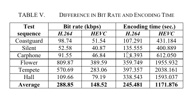

    - I read some paper on IEEE I see them compare the compression rate, when I encode av1 or vp9 I got WebM file , and for avc and hevc using (JM, HW ) I got for avc yuv and .264 and for hevc I got .bin
    so the question is the size for this files, is the final result , I mean how I can convert them to mp4 or mkv ?
    - I will compare them with the same setting and then I change QP different values, and then calculate (PSNR, SSIM, MS-SSIM, VQM,) is this right way to compare them?

    - I read a paper about Performance comparison between hevc and avc, and he was using different QP not the same, I mean avc qp=30 and hevc qp=29, is this normal?
    No clue - IMHO with different codec structure each codec may have different QP (that's why i've wrote that i would not dare to perform codec comparison without sophisticated knowledge how codec is designed - you need to understand how to evaluate codecs by understanding truly how codec process data - this is very challenging even for people with many years experience on this).

    look at this, from "Performance Comparison of High-Efficiency Video Coding (HEVC) with H.264
    AVC
    [Attachment 46174 - Click to enlarge]
    Compression factor
    How he did this from HW and JM, Did he convert them to MP4 or MKV?

  12. Originally Posted by rockerovo View Post
    AVC
    Compression factor
    all this question because I know all this coding, so we can get a file with good quilty and less bitrate, so how can I calculate the bitrate for the original yuv and output encoder file?
    Nope - just calculate raw h264 size (file size in bits - so multiply bytes by 8) divided by duration - this will give you bitrate... same as for yuv only difference is that yuv is uncompressed thus way bigger.
    mkv or mp4 are containers and they main purpose is to organise video, audio and other sub streams within single unity i.e. encapsulate multipple data within single file - each container add some amount of overhead related to own container requirements
    As you comparing only video then you can compare raw compressed video size.

  22. Originally Posted by pandy View Post
    AVC
    Compression factor
    Thank you
    but what is the bitstream for VP9, AV1? webm? I thought that webm is a container

  30. I a newbie in video coding, so I have new questions?
    I know that the quantization level or qp, when I chose the higher value you will get good compression but bad quality? I think its the same as Quantizer in PCM higher level means higher quality and less error?
    I'm still don't know how to measure bitrate for bitstream, let us say I have .265 with size 100kB and duration 3sec and 30 ms, so I need to multiply 100 by 8 and divide it by duration which is 3.33 then I will get the average bitrate, right?
    I'm using x265, x264 when I want to output the bitstream I write -o example.265 but if I change the .265 to a container like .mp4 or .mkv I got the same file size? the -o example .265 work great if I open the file with hevc analyzer, they have the same size because I don't multiplexer the bitstream with the audio file ? is this thing made the file bigger?
    which one of this two is good compression method, using fixed qp during the whole process with every codec and measure the bitrate with psnr,ssim... or using certain bitrate and compare the bitrate with psnr.ssim ?
    btw I'm using x265.x264.libvpx-vp9,aomenc av1 without ffmpeg , i don't want to use ffmpeg
    what is the lag in the frame option?
    why does some encoder ask to enter the fps with a fraction like --fps=50000/1001 not 49 to 50 ?
    whats the reason for JM and HW reference encoder?
