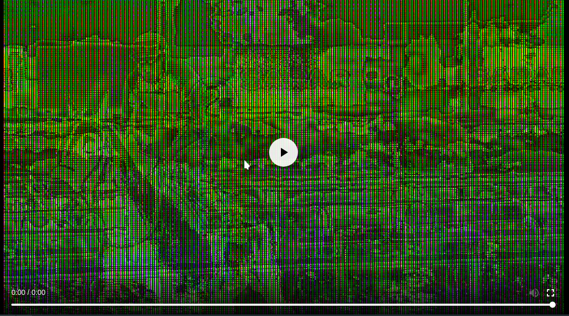

  1. I'm trying to encode 4k yuv video with webmproject VP9 I m using Linux Kubuntu 18.04 my command :
    HTML Code:
    ./vpxenc --codec=vp9  --profile=0  --fps=50000/1001 --static-thresh=0 --drop-frame=0 --good --auto-alt-ref=1  --kf-min-dist=50 --kf-max-dist=50 --min-q=32 --max-q=32 --max-intra-rate=50 -w 3840 -h 2160 --limit=1 --i420 /home/siraj/Desktop/Project/Samples/Jockey_3840x2160_120fps_420_10bit_YUV.yuv -o siraj.webm
    when trying to open webm in chrome, I got a Strange color https://i.stack.imgur.com/EYdJS.jpgImage
    [Attachment 46154 - Click to enlarge]
    Aug 2013
    Central Germany
    I guess vpxenc does not understand 10-bit-per-component YUV formats.
    Oct 2016
    Spain
    It only happens in chrome? it can be only a chrome because it looks like a video renderer issue, also can yo post a sample file?
  4. Originally Posted by LigH.de View Post
    I think I found the problem < I'm using profile 0, I need to switch to profile 2 and enable --enable-vp9-highbitdepth
  5. Originally Posted by gdx View Post
    chrome, firefox,
    and then i decode it to yuv and play it with some yuv players, all the same
    I think the problem is with the profile 0 I need to switch it to 2 and enable --enable-vp9-highbitdepth

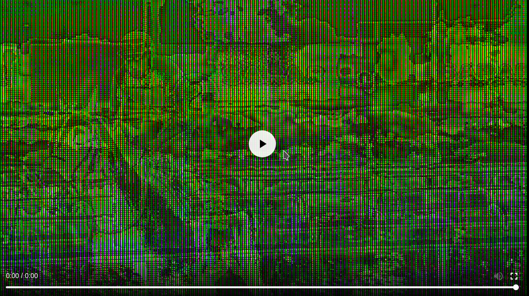

  6. I did

    siraj@RouterX:~/Desktop/Project/VP9/libvpx-master$ ./vpxenc --codec=vp9  --profile=0  --fps=50000/1001 --static-thresh=0 --drop-frame=0 --good --auto-alt-ref=1  --kf-min-dist=50 --kf-max-dist=50 --min-q=32 --max-q=32 --max-intra-rate=50 -w 3840 -h 2160 --limit=1 --i420 /home/siraj/Desktop/Project/Samples/Jockey_3840x2160_120fps_420_10bit_YUV.yuv -o siraj.webm
    Warning: Bad quantizer values. Quantizer values should not be equal, and should differ by at least 8.
    1 encoder configuration warning(s). Continue? (y to continue) y
    Pass 1/2 frame    1/2        416B    3328b/f  166233b/s  103495 us (9.66 fps)
    Pass 2/2 frame    1/1    3167674B 25341392b/f 1265803796b/s   41626 ms (0.02 fps)
    the problem still exists
    [Attachment 46155 - Click to enlarge]
    Oct 2016
    Spain
    can you post sample of your converted video?
    Oct 2016
    Spain
    Its beacuse you don't specify the input bitdepth, vpxenc don't support converting 10 to 8 bits then you need to use profile 2 and specify both the input bitdepth and the video bitdepth:
    vpxenc --codec=vp9  --profile=2  --fps=50000/1001 --static-thresh=0 --drop-frame=0 --good --auto-alt-ref=1  --kf-min-dist=50 --kf-max-dist=50 --min-q=32 --max-q=32 --max-intra-rate=50 -w 3840 -h 2160 --limit=1 --i420 --input-bit-depth=10 --bit-depth=10 Jockey_3840x2160_120fps_420_10bit_YUV.yuv -o siraj.webm
    if you want to do it 8 bits you can pipe it through ffmpeg:
    ffmpeg -f rawvideo -vcodec rawvideo -s 3840x2160 -r 50000/1001 -pix_fmt yuv420p10le -i "Jockey_3840x2160_120fps_420_10bit_YUV.yuv" -vframes 1 -pix_fmt yuv420p -strict -1 -f yuv4mpegpipe -an -sn - | vpxenc --codec=vp9  --profile=0  --static-thresh=0 --drop-frame=0 --good --auto-alt-ref=1  --kf-min-dist=50 --kf-max-dist=50 --max-intra-rate=50 --passes=1 --end-usage=q --cq-level=32 -o siraj.webm -
    But if you uses ffmpeg you have to do the 2 passes manually if you want then. Also this "--min-q=32 --max-q=32" technically that is equivalent to "--end-usage=q --cq-level=32"

    ffmpeg version 3.4.2-2 Copyright (c) 2000-2018 the FFmpeg developers
      built with gcc 7 (Ubuntu 7.3.0-16ubuntu2)
      configuration: --prefix=/usr --extra-version=2 --toolchain=hardened --libdir=/usr/lib/x86_64-linux-gnu --incdir=/usr/include/x86_64-linux-gnu --enable-gpl --disable-stripping --enable-avresample --enable-avisynth --enable-gnutls --enable-ladspa --enable-libass --enable-libbluray --enable-libbs2b --enable-libcaca --enable-libcdio --enable-libflite --enable-libfontconfig --enable-libfreetype --enable-libfribidi --enable-libgme --enable-libgsm --enable-libmp3lame --enable-libmysofa --enable-libopenjpeg --enable-libopenmpt --enable-libopus --enable-libpulse --enable-librubberband --enable-librsvg --enable-libshine --enable-libsnappy --enable-libsoxr --enable-libspeex --enable-libssh --enable-libtheora --enable-libtwolame --enable-libvorbis --enable-libvpx --enable-libwavpack --enable-libwebp --enable-libx265 --enable-libxml2 --enable-libxvid --enable-libzmq --enable-libzvbi --enable-omx --enable-openal --enable-opengl --enable-sdl2 --enable-libdc1394 --enable-libdrm --enable-libiec61883 --enable-chromaprint --enable-frei0r --enable-libopencv --enable-libx264 --enable-shared
      libavutil      55. 78.100 / 55. 78.100
      libavcodec     57.107.100 / 57.107.100
      libavformat    57. 83.100 / 57. 83.100
      libavdevice    57. 10.100 / 57. 10.100
      libavfilter     6.107.100 /  6.107.100
      libavresample   3.  7.  0 /  3.  7.  0
      libswscale      4.  8.100 /  4.  8.100
      libswresample   2.  9.100 /  2.  9.100
      libpostproc    54.  7.100 / 54.  7.100
    [rawvideo @ 0x556b2d70ac60] Stream #0: not enough frames to estimate rate; consider increasing probesize
    [rawvideo @ 0x556b2d70ac60] Estimating duration from bitrate, this may be inaccurate
    Input #0, rawvideo, from 'Jockey_3840x2160_120fps_420_10bit_YUV.yuv':
      Duration: 00:00:05.00, start: 0.000000, bitrate: 23887872 kb/s
        Stream #0:0: Video: rawvideo (Y3[11][10] / 0xA0B3359), yuv420p10le, 3840x2160, 23887872 kb/s, 120 tbr, 120 tbn, 120 tbc
    Stream mapping:
      Stream #0:0 -> #0:0 (rawvideo (native) -> vp9 (libvpx-vp9))
    Press [q] to stop, [?] for help
    [libvpx-vp9 @ 0x556b2d7187e0] v1.7.0
    Output #0, webm, to 'jockey.webm':
      Metadata:
        encoder         : Lavf57.83.100
        Stream #0:0: Video: vp9 (libvpx-vp9), yuv420p, 3840x2160, q=-1--1, 49.95 fps, 1k tbn, 49.95 tbc
        Metadata:
          encoder         : Lavc57.107.100 libvpx-vp9
        Side data:
          cpb: bitrate max/min/avg: 0/0/0 buffer size: 0 vbv_delay: -1
    frame=  250 fps=0.8 q=0.0 Lsize=   18395kB time=00:00:04.98 bitrate=30222.2kbits/s speed=0.015x
    video:18392kB audio:0kB subtitle:0kB other streams:0kB global headers:0kB muxing overhead: 0.014676%
    siraj@RouterX:~/Desktop/Project/Samples$
    the pass 2 command works great, Thank you

    Please check if your version of ffmpeg supports 10 bit with VP9:
    ffmpeg -h encoder=libvpx-vp9
    At the top there is a line named "supported pixel formats". Look for: yuv420p10le -> if it's not there, then you need a more current version of ffmpeg. The newer versions have 8 bit and 10 bit support.
    With 10 bit support for VP9 simply repeat the pixel format behind the input file. "Profile 2" will then be selected automatically. This makes the encoding strings looking as follows.
    1st pass
    ffmpeg -f rawvideo -c:v rawvideo -s 3840x2160 -r 120 -pix_fmt yuv420p10le -i jockey.yuv -pix_fmt yuv420p10le -vf fps=fps=49.950 -keyint_min 50 -g 50 -pass 1 -passlogfile jockey-2160 -c:v libvpx-vp9 -threads 8 -cpu-used 4 -tile-columns 3 -frame-parallel 1 -b:v 0 -crf 32 -an -f webm -y NUL
    2nd pass
    ffmpeg -f rawvideo -c:v rawvideo -s 3840x2160 -r 120 -pix_fmt yuv420p10le -i jockey.yuv -pix_fmt yuv420p10le -vf fps=fps=49.950 -keyint_min 50 -g 50 -pass 2 -passlogfile jockey-2160 -c:v libvpx-vp9 -threads 8 -cpu-used 3 -tile-columns 3 -frame-parallel 1 -auto-alt-ref 1 -b:v 0 -crf 32 -an -f webm -y jockey.webm

    siraj@RouterX:~/Desktop/Project/VP9/libvpx-master$ ./vpxenc --codec=vp9  --profile=2  --fps=50000/1001 --static-thresh=0 --drop-frame=0 --good --auto-alt-ref=1  --kf-min-dist=50 --kf-max-dist=50 --min-q=32 --max-q=32 --max-intra-rate=50 -w 3840 -h 2160 --limit=1 --i420 --input-bit-depth=10 --bit-depth=10 Jockey_3840x2160_120fps_420_10bit_YUV.yuv -o siraj.webm
    Error: Unrecognized option --input-bit-depth=10
    Usage: ./vpxenc <options> -o dst_filename src_filename
    Use --help to see the full list of options.
    It appear that the build of vpxenc don't support 10 bits.
    Originally Posted by rockerovo View Post
    and output for the second command :

    Yo didn't add the"-" add the end that indicates to read the pipe to the encoder.
    For you question fornit had responded quite well, but in the case of av1 the av1enc is far superior as the ffmpeg integration is quite lacking for now.

    Thank you! everything works like a charm, I was using the old version for FFmpeg, I followed this guide and now I'm using the latest version with 10-12 bit support
    the guide :
    https://trac.ffmpeg.org/wiki/CompilationGuide/Ubuntu
    and when I type ffmpeg -h encoder=libvpx-vp9 i got :
    iraj@RouterX:~/bin$ ffmpeg -h encoder=libvpx-vp9
