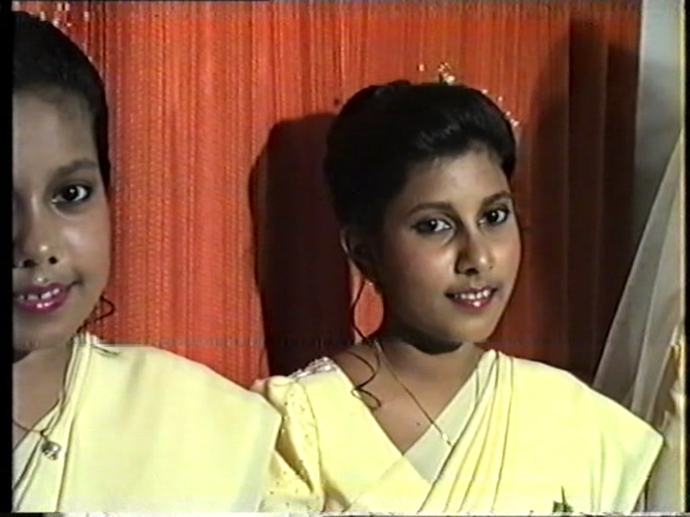

This is the sample of capture frame with Amarectv
[Attachment 46134 - Click to enlarge] -
This is the sample frame I converted from a studio, I have no idea about their technology,
[Attachment 46135 - Click to enlarge]

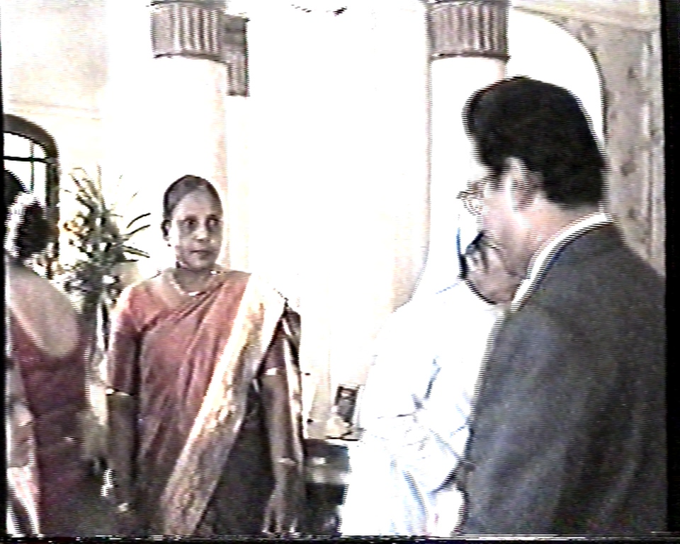

I post a sample frame of converted video using VC500 in the above reply, and my VCR is HITACHI M70EM, when I connect it to TV, It gives above quality, so it is impossible to think my VCR or VHS tape is the problem.. I may misuse VC500, but how? -
Adjust the brightness and contrast before capturing, so it matches that for the 'good' picture. Don't ever just use the default settings and hope to get something decent.
And for more informed advice, post an untouched sample from your source, ten seconds or so, as already requested. A VIDEO sample, not a picture. -
VHS is about the lowest quality source. Even in the best of circumstances it has only half the resolution of broadcast TV or DVD. But start by adjusting the capture driver's video proc amp to get your brightness and contrast right (your sample has badly blown out brights and the black level is too high). Capture to AVI with a lossless codec like huffyuv and no audio compression.
For best captures you need an SVHS deck with a line TBC and maybe a full frame TBC (if your tapes are in bad condition). In lieu of that you can use a good VHS deck and an external line TBC like an old Panasonic ES10 or ES15 DVD recorder (don't record to DVD, just pass the signal through the recorder). If your VHS deck has a sharpness setting turn it down or off. Once you have a decent capture you can start thinking about filtering it, and finally encoding it.
