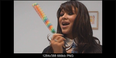

  1. I have some videos, which seems to be that someone who converted these videos from interlaced ones to progressive, forgot to add deinterlacing into a process.
    As result now video is progressive, but "lines" in motion are still present.
    There are similar topic, and no simple solution in every situation.
    Video has no/minimal artifacts when player window is downscaling movie, but when its 1:1 - issues are eye catching.
    Files are NSFW, and I made SFW 5 seconds sample, to represent problem.
    Here is comparison - https://forum.videohelp.com/images/imgfiles/ptWAEow.png both files are stored on different sites, and you can see that an approach in converting them is different.
    So what I'm asking for, what are main steps would be, to re-encode video and get rid of interlaced video artifacts? (If it's possible)
  2. In the top image the interlaced video was scaled without consideration of the interlacing. The two fields can no longer be cleanly separated. About the best you can do is blur them together to look like the bottom image.
  3. Originally Posted by jagabo View Post
    Bottom image has totally fine quality for me. So, maybe you can give some advice where to start/what software is appropriate and will do the job.
