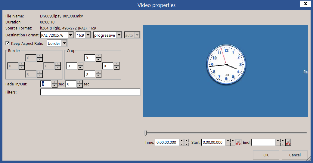

I would just use DVDStyler to make the cuts and fade using the AVCHD files as source and then encode using 2-pass VBR.
[Attachment 46088 - Click to enlarge] -
