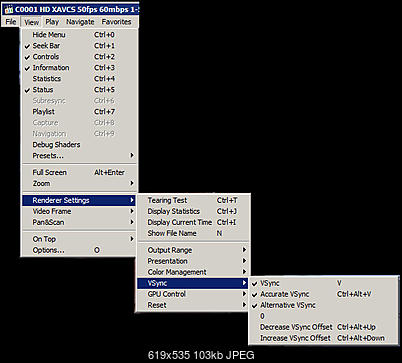

    looked at MPC-HD settings, this being the video player I use along with Jaksta. I find the picture is best in MPC-HD, black is black, saturation correct etc.
    VLC also gives tearing as does Windows Media Player, both worse than MPC-HD
    In MPC-HD it has View>Renderer Settings> VSync V or AccurateVSync Ctrl Alt V or Alternative VSync nothing shown for turning that on.
    Options>Output has Alternative VSync as a tick box, says Reduces tearing by bypassing the default VSync built into D3D.
    I have tried all these and not a scrap of difference do they make.

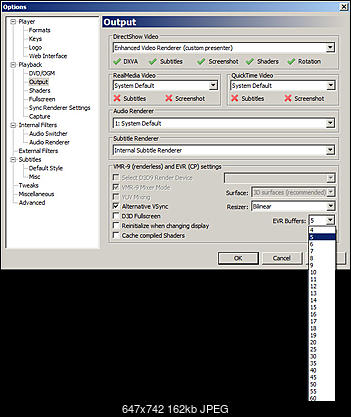

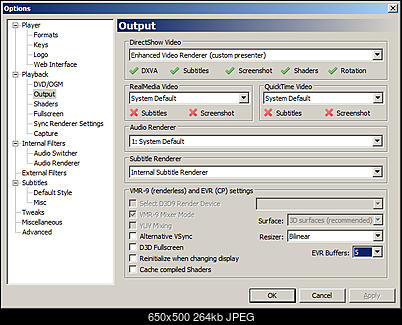

    AS for Buffers there is a section says VMR-9 (renderless) and EVR (CP) settings and in there is EVR Buffers 5 and if I click it there is a great long list of numbers to choose from.
ID:	46196Click image for larger version
Name:	MPC-HD Buffer.jpg
ID:	46197Click image for larger version
Name:	MPC-HD V sync.jpg
    here are the settings I see, I dont see where it might overide the graphics card but maybe the settings as they are do so. I see no setting to 'use graphic card'.
