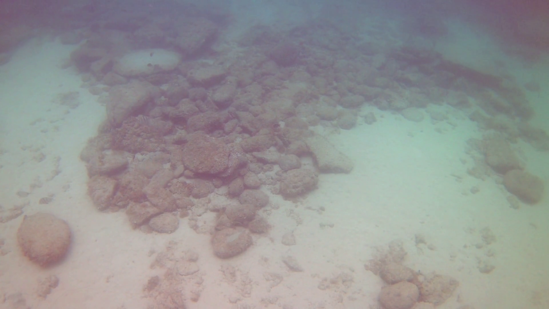

I recently made my first diving videos and they all have this greenish touch. Could you please recommend a video editor to fix this?
Googleing I found a video tutorial for GoPro Studio which looks promising but it's discontinued :/
On Ubuntu I tried AviDemux and Shotcut, but with both I couldn't get good results.

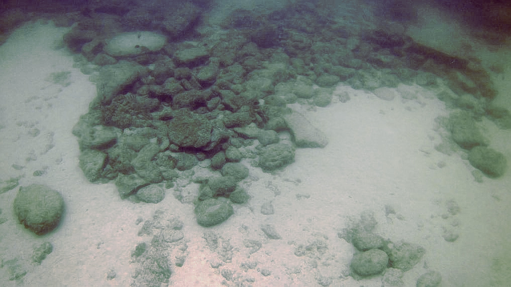

On Windows I haven't found any free tools, but opening a frame from a video in paint.net and using the Auto Level feature (I guess it fiddles with the histogram) leads to very good colors.
[Attachment 46061 - Click to enlarge]
[Attachment 46062 - Click to enlarge]
Unfortunately I wasn't able to get even close with any video editor I tried so far.
Thanks for any suggestions, kopi

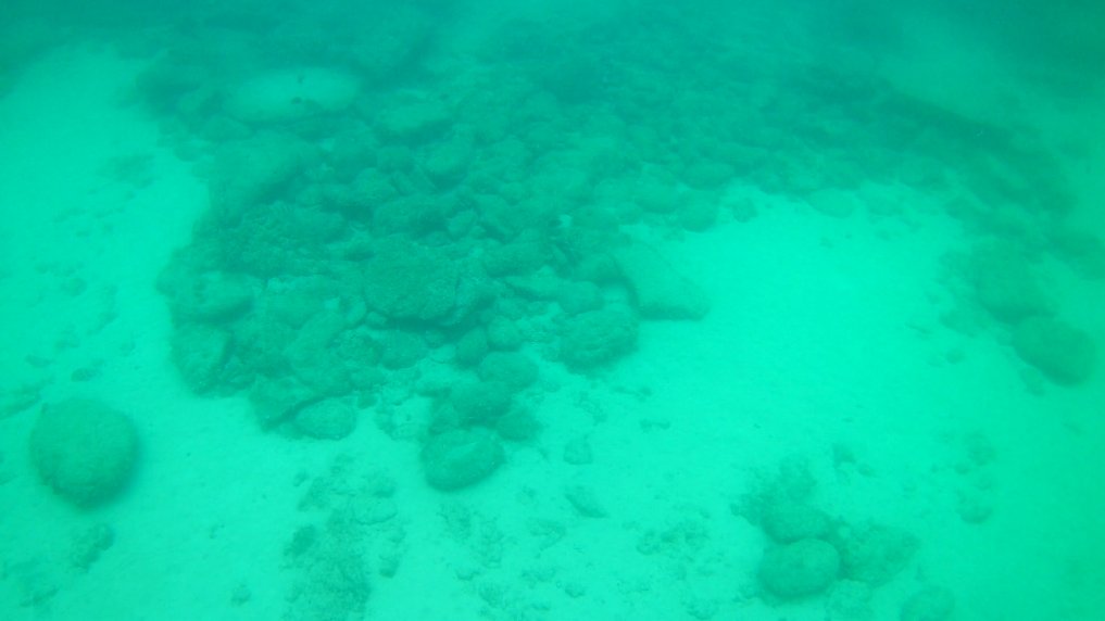

Hello and thanks for your tipps. All those programs offer some kind of color correction, but I couldn't find one that does it automatically for each frame. Since I've different depth in my video, the color correction would have to adapt quite often. So I tried AviDemux again and clicked through every filter. The Avisynth color filter has an option for AutoWhite. With this option the videos are not perfect, but ok.
[Attachment 46096 - Click to enlarge]
Would you know another program with such a feature that fixes every frame itself and not by setting a filter for a sequence or even a whole video? Tanks, kopi -

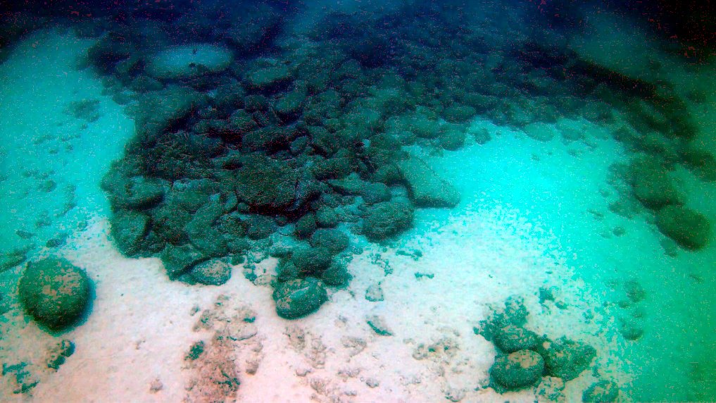

Edit: After looking at the photo there is very little Red information in comparison to the Green and Blue.
2nd Edit: Messing around in Rawtherapee I came out with this. There is just so little Red information, the rocks themselves have about zero Red info, with the white sand having a bit more.
[Attachment 46111 - Click to enlarge]Last edited by KarMa; 17th Jul 2018 at 22:20.

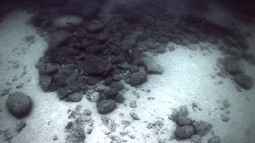

Davinci does this quite easily, checking the Parade and Vectorscope, you'll get similar results, there's no much color information to work with.
BEFORE
AFTER
RESULT
I'm using GIMP as the next example, sorry I'm kind of busy right now, you can also do this in Davinci, to create your Red, Green and Blue channels or layers to subtract the diference between then to find your white, restore some of the details.
Then working layer by layer to reconstruct the shot, os do a post production to do a blue casting to it, colorize the sand, etc.
