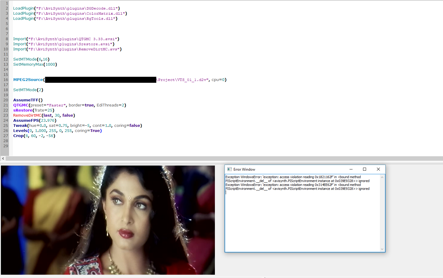

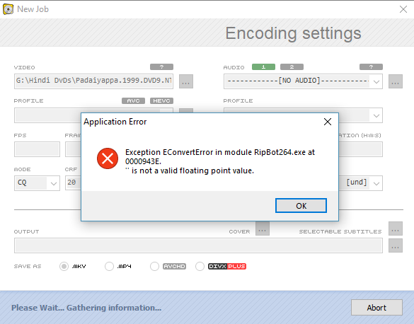

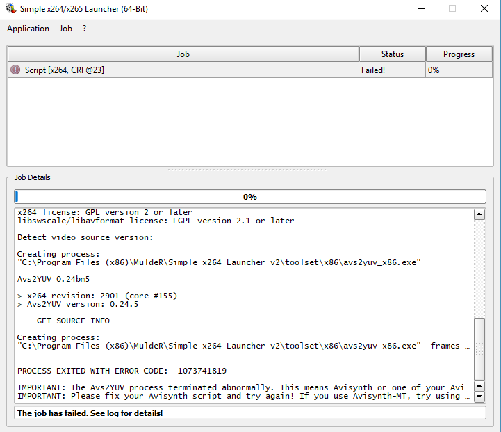

    I try to clean a DvD using RemoveDirtMC but I keep getting the same error message and whenever I try to import the avs script into RipBot264 or Simple x264 Launcher it doesn't start, any suggestions? Thanks!

  2. I don't use bob/Srestore in the same script as RemoveDirtMC as it always crashes for me.
    Can you open the script in VDub? If so, I'd suggest making a lossless AVI without RemoveDirtMC followed by using that lossless AVI in the next script with RemoveDirtMC.

    Thanks, manono for reply I will make a lossless copy if the problem remains. I imported it into VD it opened for some seconds then crashed as following:

  4. 16 threads with QTGMC(), SRestore(), and RemovedirtMC() is going to run out of memory if you're using 32 bit AviSynth.

    Yes, you're right! I shouldn't, although I tried less threads but the same problem. as manono advised I will do it, thank you Jagabo
  6. You might be able to get the sequence to run if you run single threaded (or just a few) and reduce SetMemoryMax. But then processing will be slow slow you might as well run sequential scripts with a lossless intermediate instead.
