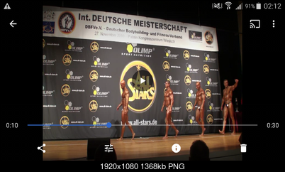

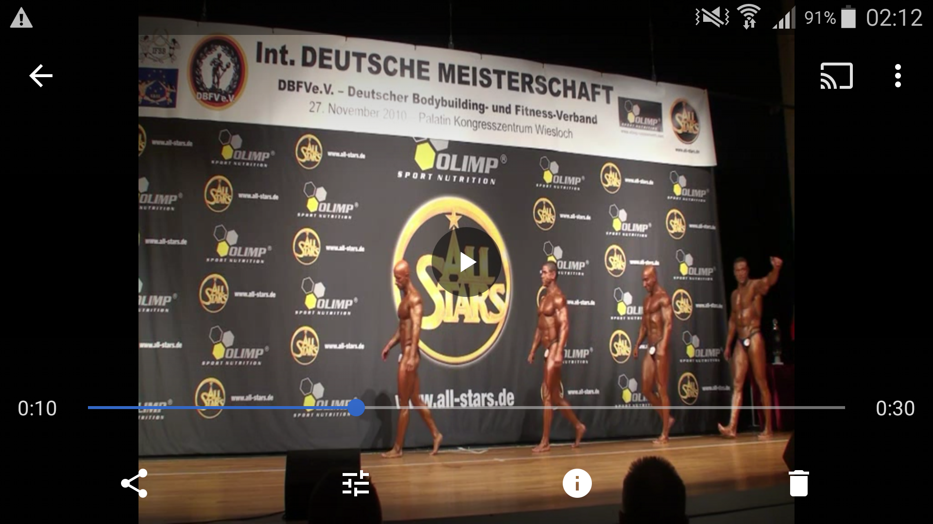

    I'm not sure whether really nothing is obsolete keeping it anamorphic. I've just tested an anamorphical x264 encode on the mobile devices, I've lying around here in my office.
    On the iPad it plays fine.
    On my older Samsung S5 (Android 6.0.1) it is squeezed when opened with the standard player.
    On my newer Android device (7.1.1) it starts squeezed for a second but is then corrected to the right dimensions. But if a pause the video, switch to another application and back, then it's squeezed, too. And I must restart it to get the correct dimensions again.
    I've then tried to "beam" it to my TV with Google Chromecast. Again it appeared squeezed.
    This is far away from a broad research. And of course there is a lot of video players that can be installed on mobile devices. But isn't it fine if things work out of the box?
