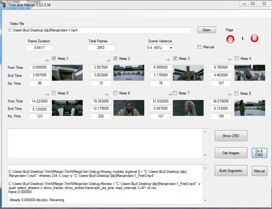

    There are literally thousands of internet hits Suggesting how to cut videos using FFmpeg and almost all of them have comments afterward that the methods do not work. Since I am working on a utility to cut and join videos at Key Frames and perhaps re-encode cut portions that are not at key frames, I have done extensive testing with the one of the latest FFmpeg FFprobe FFplay versions. I use FFprobe on all the results as well as MediaInfo. They may not be accurate but as far as I know these have worked well in the past.
    The only variations I have found is that FFprobe used to represent a cut preceding an I-Frame as a minus number but now starts the cut at 0 (since -ss Input now frame accurate) and show frame 0 as a plus number. Also the 64 bit MediaInfo CLI later versions lost the ability to output some information. Both of these were not a major problem as far as my results showed.
    I am sure there will be many comments and I welcome them since there is much that I wish to learn even though I have read and tested as much as I can. I have also tested such as AVIDemux and others and they achieve the approximately the same results as below although the offset is difference in the final cut's frame 0 PTS.
    I still do not know if a frame 0 PTS of say 2+ seconds causes a problem when joining.
    I used the following video as the main reference but used other formats for testing just to confirm the actions of cutting.

    If anyone's findings are different, or if anyone has an explanation please let me know. As I mentioned, I need all the information I can
    get in order to create a working program that addresses the 1000's of comments of FFmpeg cuttting failures.
    So far I have been able to create segments that appear to be the correct length and play correctly with no sync problems.?????

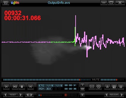

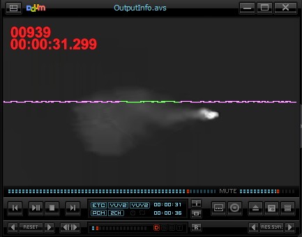

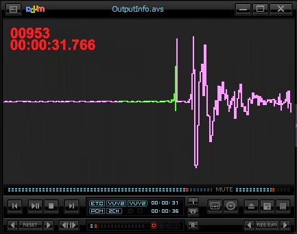

    Update:
    Looks like the leading preroll, even on non-AVC/AAC videos causes delay. Tests below, all done with copy, no re-encoding, were as follows:
    1. I used a Gunshot video (MKV) of short duration and joined it to itself for a total of 8 segments. Left the +DTS of Frame 0
    2. I converted the MKV to MP4 and joined the MP4 to itself for a total of 8 segments. Left the +DTS of Frame 0
    3. I converted the MKV to MPE$, reset the Frame 0 DTS to 0.00000 and truncated the 133 frames to 132 to remove the longer Audio
    RESULTS:
    1.
    Gunshot.mkv= frame 0= 0.003000, 133 frames, Video=vp9= 4.500 seconds, audio =vorbis=4.483 (2 frames delay to start)
    8(x)Joined.mkv =frame 0= 0.003000, 1064 frames, Video=vp9= 35.824 seconds, audio =vorbis=35.888
    2 frames delay start, 13 frames delay finish
    2.
    (fFFmpeg -i Gunshot.mkv -c copy Gunshot.mp4)
    Gunshot.mp4= frame 0= 0.003000, 133 frames, Video=vp9= 4.433 seconds, audio =vorbis=4.500 (2 frames delay to start)
    8(x)Joined.mp4 =frame 0= 0.003000, 1064 frames, Video=vp9= 35.934 seconds, audio =vorbis=36.000
    1+ frames delay start, 13+ frames delay finish
    Segment 1 (Below) and Segment 8 for attempts 1. and 2.
    [Attachment 46040 - Click to enlarge]
    [Attachment 46041 - Click to enlarge]

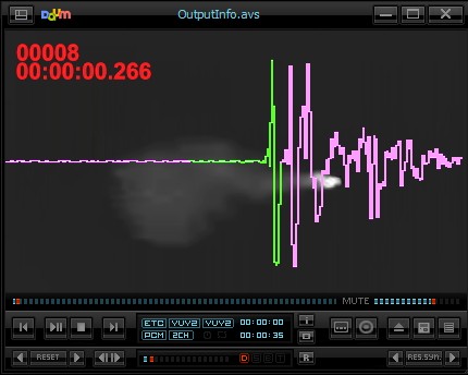

    3.
    Start with MP4/Set Frame 0 = 0.00000 truncate to 132 frames to remove excess audio (Algorythm-via FFmpeg)
    Gunshot.mp4= frame 0= 0.000000, 132 frames, Video=vp9= 4.400 seconds, audio =vorbis=4.381 (1 frames delay to start)
    8(x)Joined.mp4 =frame 0= 0.000000, 1056 frames, Video=vp9= 35.201 seconds, audio =vorbis=35.181
    less than 1 frames delay start, less than 1 frames delay finish
    Segment 1 and segment 8 from attempt with reZero Frame 0 DTS
    [Attachment 46042 - Click to enlarge]
    [Attachment 46043 - Click to enlarge]
    I will attempt other formats and codec to see if the result hold true, but this might account for why many cut/join operations fail with generic FFmpeg scripts.
