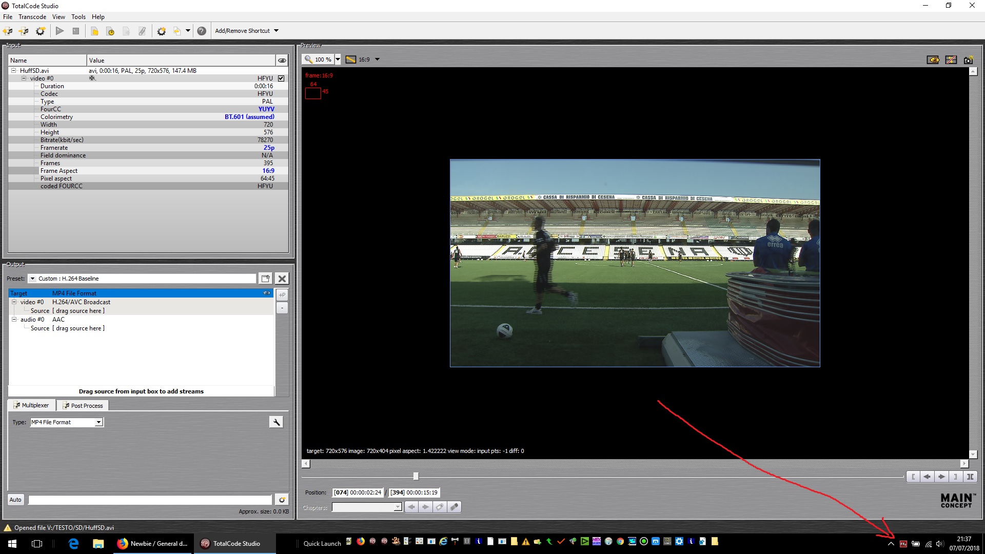

    please I wonder if is there a way to verify, via batch mode, if a specific program (in my case Mainconcept totalcode) is using a specific Directshow filter, in my case FFDSHOW as shown
    Is it possibile? thanks
    [Attachment 45996 - Click to enlarge]

    You can set FFDshow to put an icon in the lower right area
    when it is is in use. When the icon appears, it's in use
  3. yes, already do thanks but I need to confirm his use via batch mode, as effective process in background
