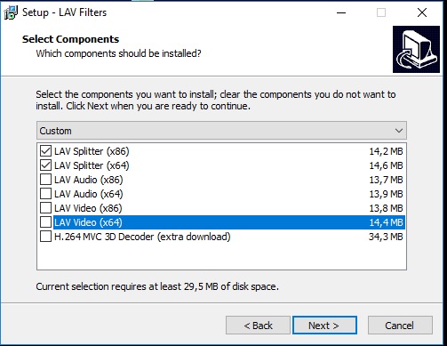

I wonder if exist an installer package of LAV filter that - using the default settings - install only the splitter and not also the VIDEO/AUDIO filters:
I know that if during the installation I manually uncheck the VIDEO/AUDIO filters I can only install the splitter. But I wonder if is there a way to install the splitter without manually uncheck the other option than the splitter. I would like to have as default, this situation if possible
[Attachment 45995 - Click to enlarge]

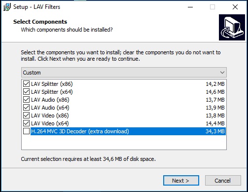

to avoid mess: I don't wont install LAV VIDEO AND AUDIO FILTERS. By default the installer suggest to install all (except the H.264 MVC 3d Decoder). I need install only the splitter and this procedure have to be done from another cats that they are very ignorant. So I try to take to they the installer that suggest the installation of the splitter only, and not all the rest

MPC-BE is a player? I don't need a player, I need to install in the system the LAV splitter, but only the splitter and not also the video and audio filter. If I execute the installer, as default it suggest to install the video and audio filters:
[Attachment 46001 - Click to enlarge]
simply I need a solution that suggest to install only the splitter and not also all the rest:
[Attachment 46002 - Click to enlarge]
I know that is enought uncheck what I don't wont to install: but I need to pass some procedure to many cats, that they are not good with computers. So I prefer an installation that suggest as default the right choice without manually check or uncheck what I need to install... if possible -

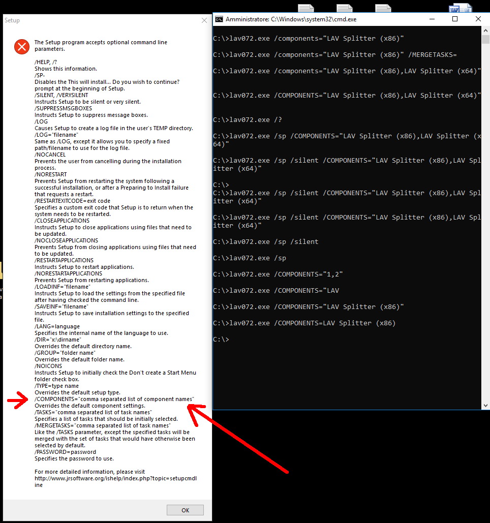

I need to change the default options in the InstallShield Wizard, or retrive a package of lav filters that install only the splitter in the default options
I have try to execute the executable via dos-commandline with any options that seems suitable, but in my proof the don't work. Simply I want to tell to the installer that the components to install have to be only the "Lav Splitter (x86)" and "Lav Splitter (x64)". And not all the rest
[Attachment 46003 - Click to enlarge]
what mean "comma separated"?Last edited by marcorocchini; 7th Jul 2018 at 17:32.
Oh, solved cat
however thanksCode:LAV072.exe /silent /COMPONENTS="lavsplitter32,lavsplitter64"
