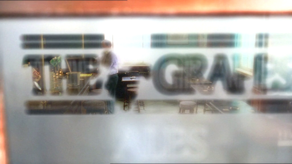

  4. Is this too blurry for you?
  5. Originally Posted by jagabo View Post
    Yeah a bit, i guess there's no way of getting rid of the aliasing without reducing the detail. Spline seems to be the best compromise and also sharpens things up a bit giving a crisper picture. I think on this occasion the aliasing is being caused by the lack of resolution and maybe compression to a degree.
    Also is there a standalone border=true script or equivalent like QTGMC has, in order to fix the border and straighten the two half fields on the top and bottom?
    [Attachment 54562 - Click to enlarge]
  6. I used both Blur(0.5, 0.0) and dehalo_alpha(rx=2.0, ry=1.0). You don't need to blur or dehalo if you don't want. Here's one with just Santiag() to smooth the aliased edges.
