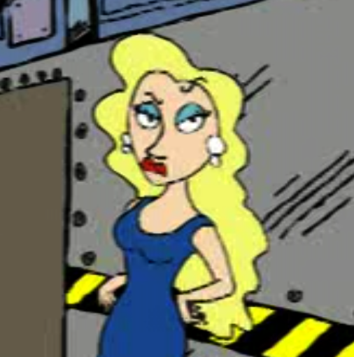

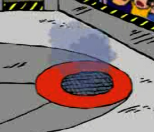

  1. I've been ripping some DVDs lately and would like to know if there's a way of removing the compression artefacts that come with the format, in AviSynth or such?
    This particular animated DVD for example, exhibits some horrid artefacts in a few frames.
    [Attachment 45973 - Click to enlarge]
    [Attachment 45974 - Click to enlarge]

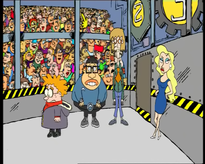

  4. Cheers fellas! Getting a much better picture now Regarding deblock_qed(), tried so many times, but can't seem to get it to load. The avsi file is in the Plugins folder but keep getting the following error..
