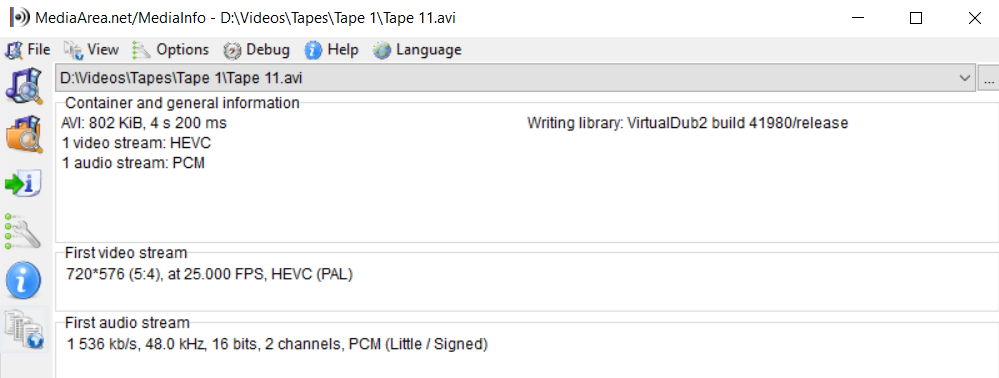

    With MediaInfo i get:
    [Attachment 45954 - Click to enlarge]
    My PC has KLite Codec pack installed, should know how to decode it?
