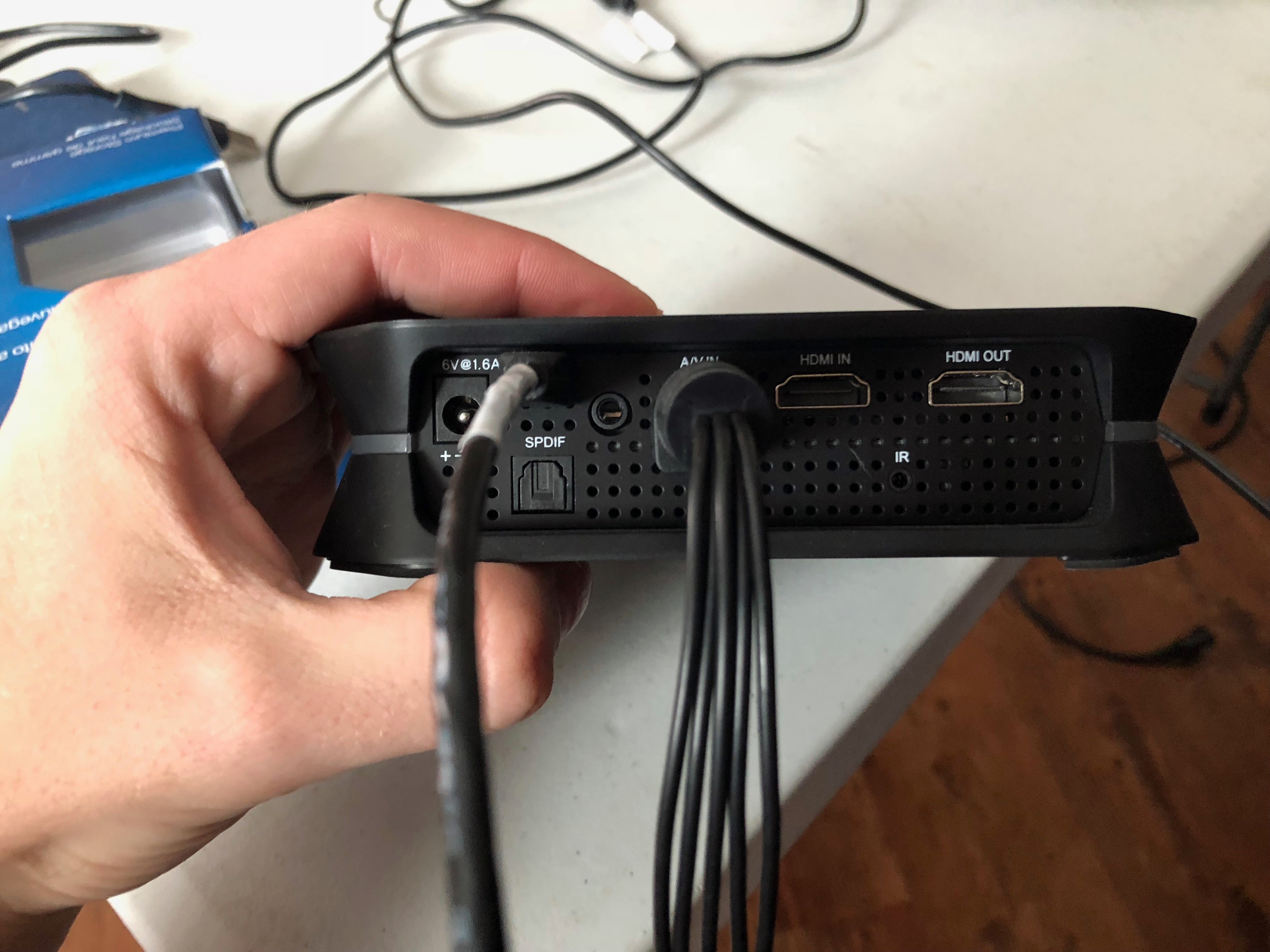

    I have the 1512 as well. This is what the back looks like.
    There are some variations on the models of the Hauppauge boxes including the 1512 depending on when it came out. For instance mine has a slot type connector for the A/V in like the one shown by redwudz even though it's also a 1512 while yours is rounded but that doesn't matter.
    Make sure you don't connect both a component and HDMI cable on the back of your Genie box. Most if not all newer devices will disable the component if an hdmi cable is connected.
    Surely you've solved the female out component from the Genie to the female in component on the HDPVR2 issue all you need is a regular common male to male component cable to bridge them. Just keep the colors straight.

    Your image doesn't show what's at the end of the pigtail adapter. But I'm guessing it's the normal five female RCA connectors for component video and stereo audio. All you need is a normal component video cable:
    https://www.amazon.com/Monoprice-1-5ft-22AWG-Component-Coaxial/dp/B01ELS2HW0/
    Or, if you can place the capture device close enough to your source, five male/male RCA adapters:
    https://www.amazon.com/RCA-Male-Audio-Coupler-Adapter/dp/B004HRB7C2/

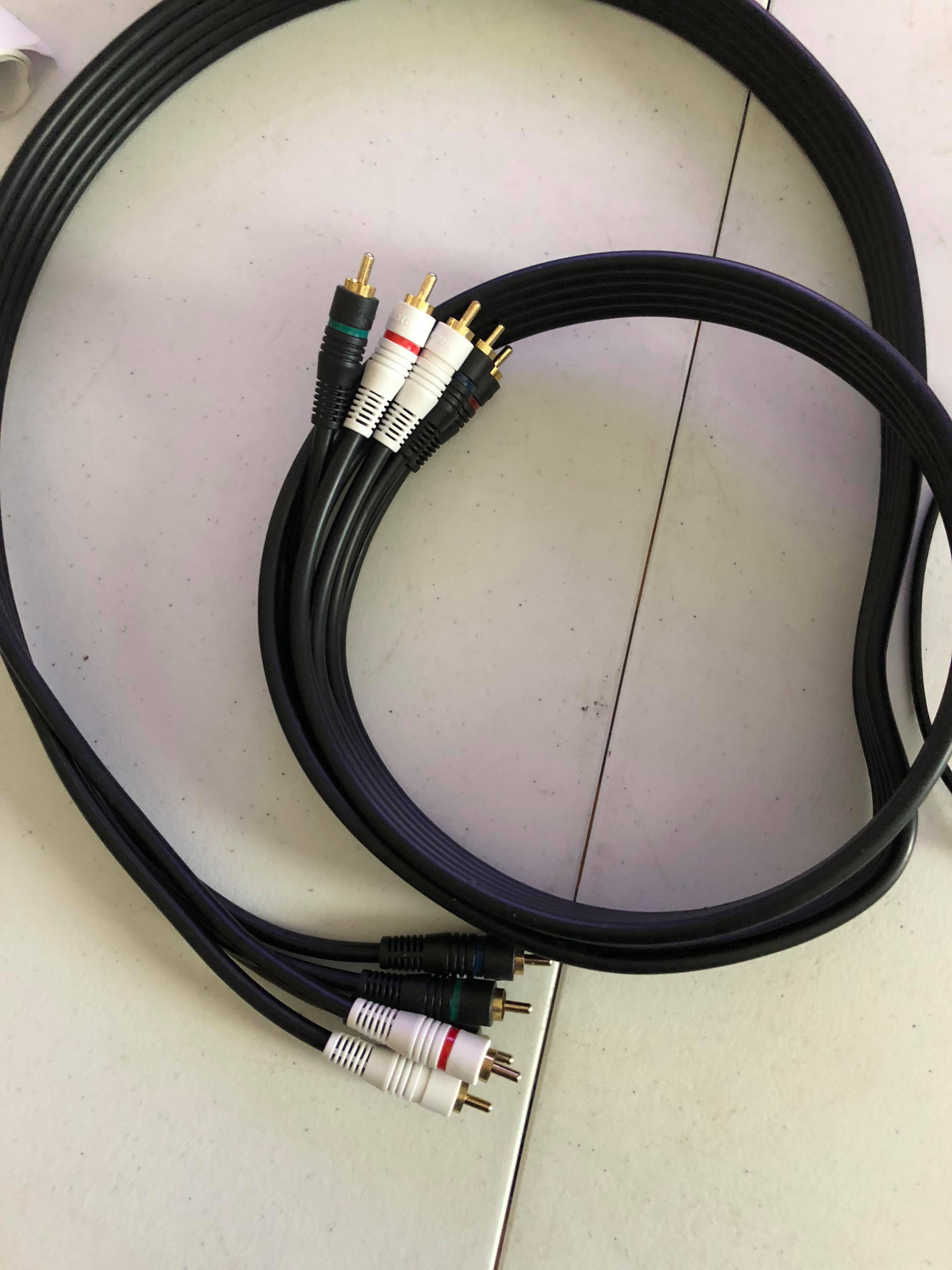

    These are the component cables I hooked up to the HR24/200. The picture is of the HR54/700 Genie. The HR24/200 had component plugs I could directly attach to while the Genie doesn't. Hope this clears things up.

  16. Originally Posted by HPJoker View Post
    Sorry. I thought the image in post #7 was the back of the Genie with a pigtail adapter that you already have. I see now that it was the HD PVR 2 and its adapter. So yes, you need another adapter for the Genie. Be sure that the adapter is made specifically for the device you have as there is no universal standard for such adapters.
