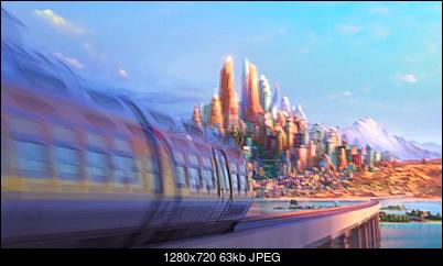

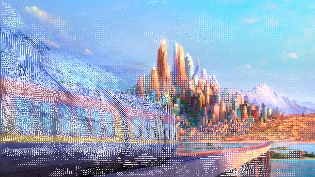

  21. Here's what frame rate converter gives for that frame:
    FrameRateConverter(Preset="normal", BlkSize=8, NewNum=60000, newDen=1001)

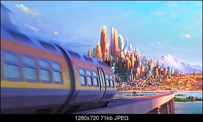

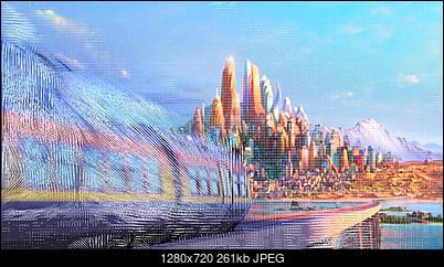

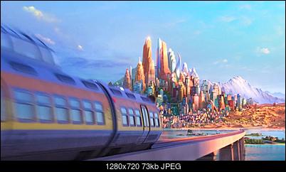

    It delivered a simple blend of the two original frames around it rather than giving weird distortions from bad motion vectors:
    When FrameRateConverter() can't make sense of the motion vectors it resorts to blending rather than motion interpolation.
    Motion vectors from SVP:
