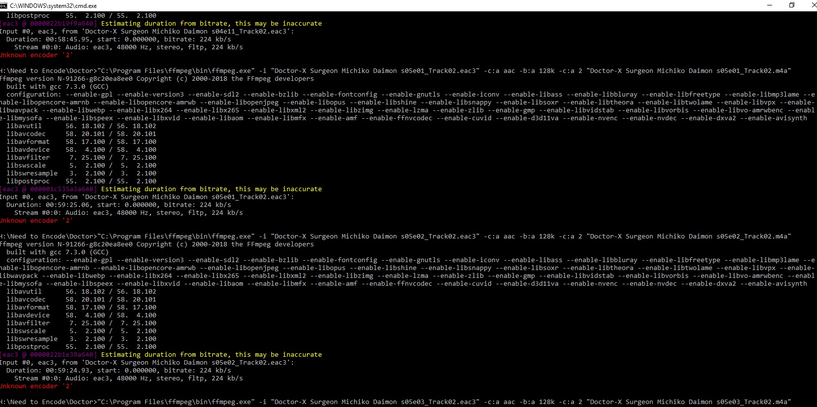

    hold on a second.. Ok, I am getting an error, please see the picture "unknown encoder '2'Image
    [Attachment 45874 - Click to enlarge]
  7. Sorry, my bad.
    -ac 2 is stereo downmix, not -c:a 2
