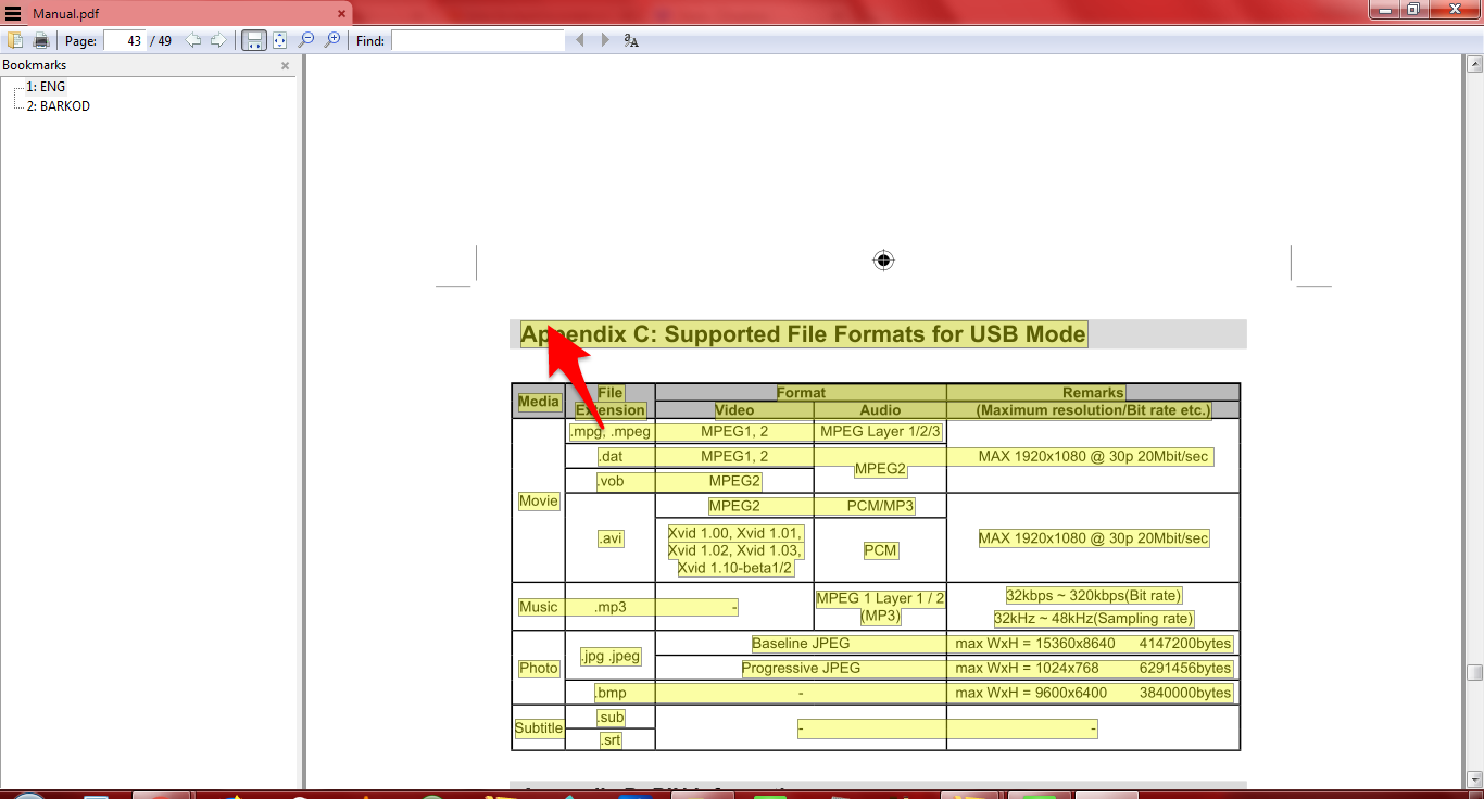

    Jun 2018
    Hi. Brand newbie here, I googled 'tv only plays MPEG files' (via USB) and landed here.
    I have the same problem as the OP. Not a huge issue really but I use Freemake (an old version as I REFUSE to upgrade to the crap it is now) to convert my files and they are always larger than the input file, sometimes double the size.
    I attach the relevant details from my TV manual. Most of this is to me but I managed to gather enough info to convert into larger files, which are now eating up my HDD. Any advice?
    [Attachment 45940 - Click to enlarge]
    Thanks in advance.
    Jo

  22. Originally Posted by thea-belle View Post
    Go for XVid - bitrate should be lower than MPEG-2 - personally i like ffmpeg but it may be not the best option for you (command-line but some GUI's exist)..
