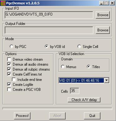

  11. Does this thing have more than a single VOB ID? You can find out in PGCDemux. The reason I ask is if each has delays, those delays will accumulate as the video goes on. If, for example, each cell (chapter) is also a VOB ID with delays for each, then that's the cause of your problem. I've never examined a DVD made from a DVD recorder so I don't know.

  13. No, not what I meant. The VOB ID. Open the IFO in PGCDemux and tick 'by VOB id'. In the drop down box you can see if there's more than one and the 'Check A/V delay' button will show you the delay for each. Admittedly, I'm clutching at straws here because I don't understand the cause of the problem. A bunch of VOB IDs with delays will definitely cause it. The most I've ever seen is 2 VOB IDs (except in episodic television shows), and it messed up both the audio synch and the subtitle timings after the change of VOB IDs.
    I don't have an example to show you because retail DVDs don't often have problems like this. But I know nothing about how DVD recorders behave.
    Image Attached Images
  14. Each IFO lists VID 01 (01), with a delay of "0x80 --> 0msecs".
