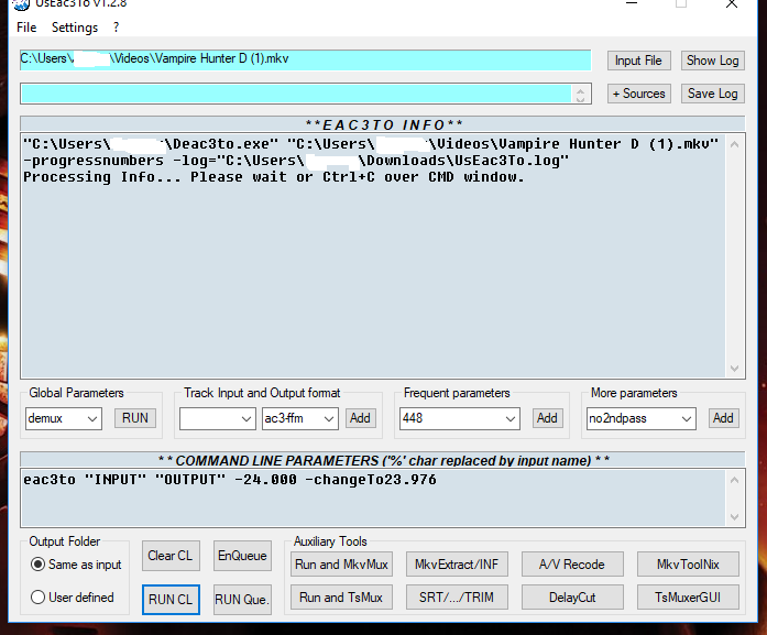

  11. I'm feeling very stupid. How do I get eac3to gui to run the audio correction? I've never used it before. I first place my muxed mkv as the input file and while waiting for it load I entered Sneaker's command line exactly as written. The program still said had the Processing info message so I let it run.... for 3 hours. When nothing changed, I decided to click the run cl button and still nothing happens.
    I've included a screenshot showing what I entered in eac3to gui. Is there something else I need to do first? Should I be using the extracted AC-3 file instead of the muxed mkv?

  12. My example was for the command-line, not for entering into the GUI. The GUI will fill most of that automatically.
    [Attachment 45850 - Click to enlarge]
    1. Select the audio track
    2. Select desired output format
    3. Add
    4. Manually enter "-24.000 -changeTo23.976"
    5. RUN CL
