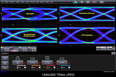

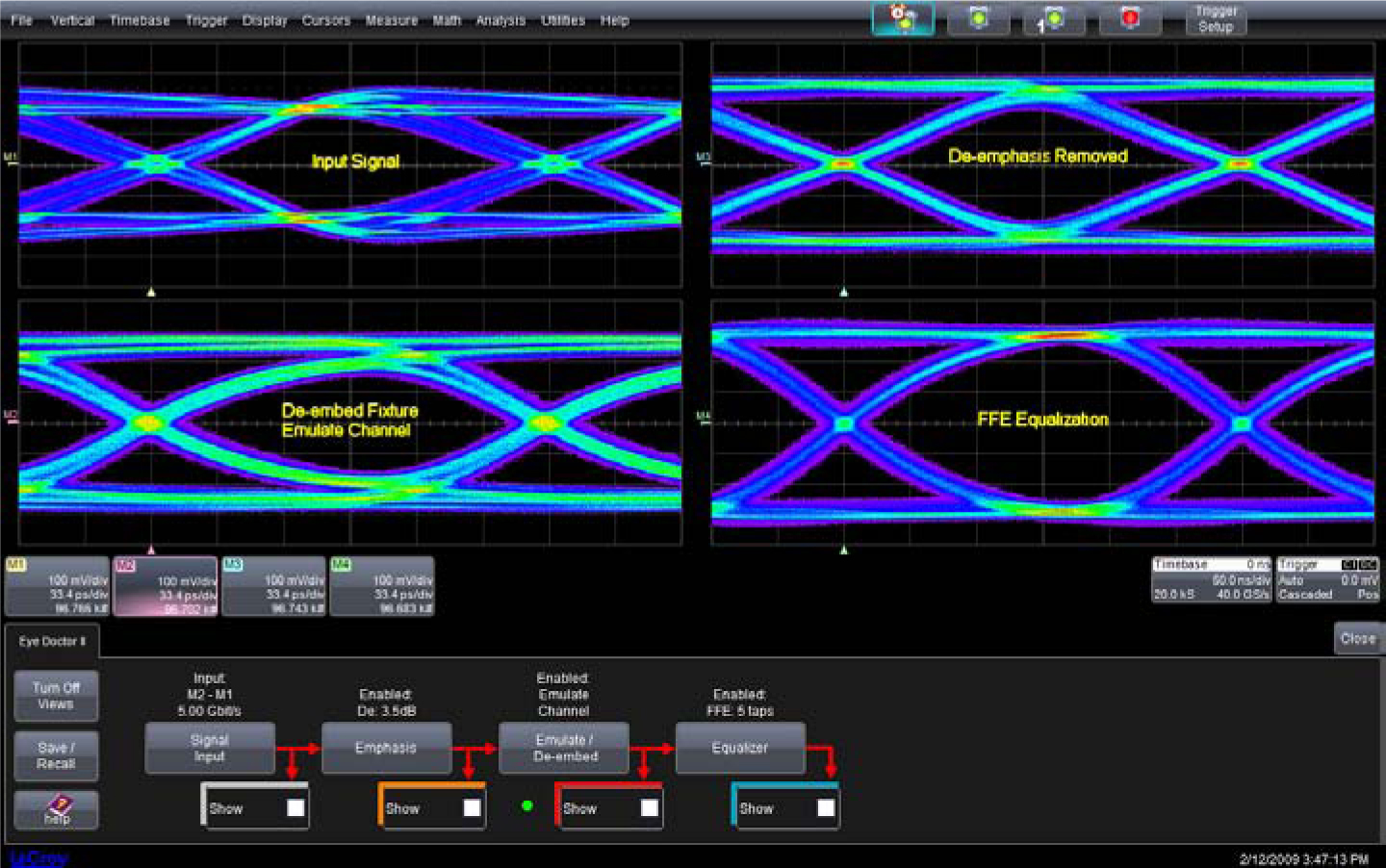

    Eye pattern looks like this and sane HDMI switch may improve digital data levels and apply re-clocking and some equalization to deal with long cables loss but it is unable to modify data especially in intelligent way (so keep image structure but alter sharpness) especially when data are HDCP protected (they are scrambled so video looks like colour RGB/YCbCr noise):

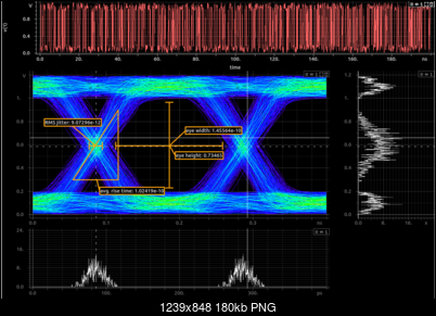

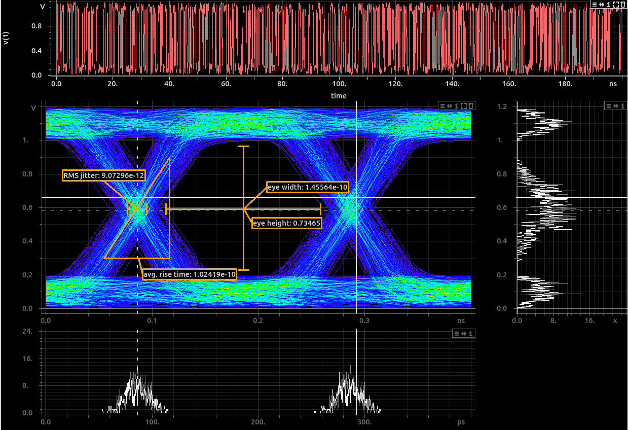

    Another example of eye pattern diagram:
