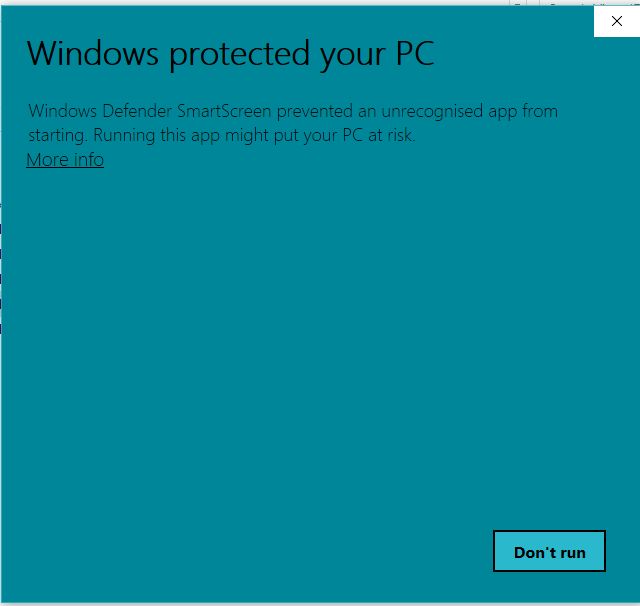

    OK! I did as suggested and then rebooted and problem was solved. But I need some of those filters, so I unzipped the latest version (VirtualDub2_41882) and when I ran the exe file, Windows Smart Screen / Defender thingy popped up warning there was something amiss. I selected "run anyway" and got the green line / no dialogues problem again.

    However, it is still being flagged in Windows Defender, although if I allow it to run (the Windows Defend dialogue only appears the first time VD2 is run) it works normally (i.e no more green border, file dialogues work, etc).
    Here are some screenshots of Windows Defender issue.
    Thanks for your help you guys.

    Mar 2008
    Interesting i'm running WD and it does not complain about Vdub2
