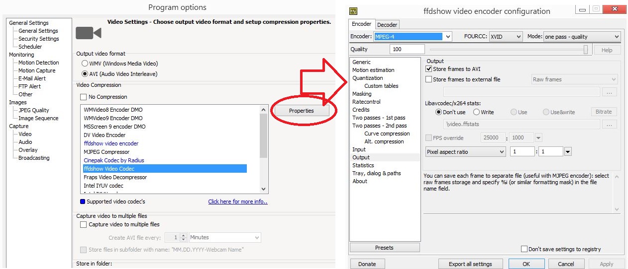

I'm using a video surveillance software called Webcam Surveyor. I need help regarding its video quality settings. There are two video formats in its settings that it can save the videos in, which are .wmv and .avi.
.wmv isn't that much customisable and saves the videos in 480p. So, I prefer .avi. When I select .avi, this is where all the confusion begins! There are numerous video codecs to choose from and each of them can be further customised. Each of those codecs have vast individual settings (makes me feel like I am lost in a forest without GPS!). There are countless combinations of video settings that can be made!

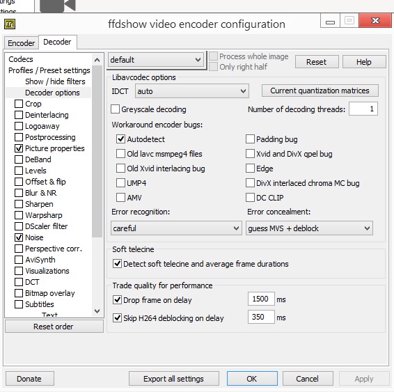

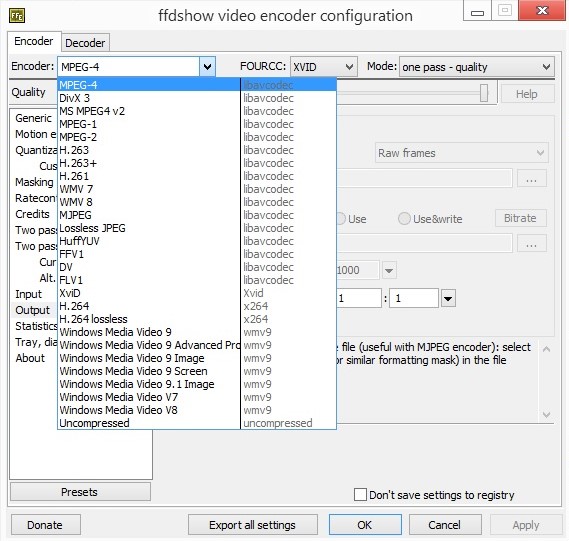

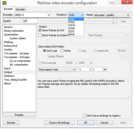

When I select .avi, the default settings are as follows:
[Attachment 45803 - Click to enlarge]
[Attachment 45804 - Click to enlarge]
[Attachment 45805 - Click to enlarge]
[Attachment 45806 - Click to enlarge]
The codec that is selected by default is ffdshow video codec, screenshots of the properties of which is also attached above.
When captured on these settings, the size of the video file is is too high. For 1 hour of footage, it takes on an average of 1.5 GB of space (size varies between 1.1 GB to 1.9 GB, depending on the lighting; the lower the light, the lesser the size). I've tried many different settings but can't decide which is better as I'm kind of an intermediate to video formats, codecs and stuff. So I didn't change anything after choosing .avi.

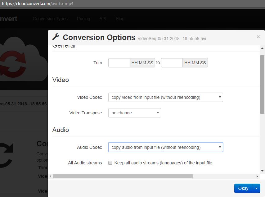

Recently, I recorded a 10 minute footage with the same software, same settings and same webcam and tried cloudconvert.com to convert it from .avi to mp4 with the following settings:
[Attachment 45807 - Click to enlarge]
And to my surprise, the size of the converted mp4 was almost the half of the original avi file.
I compared the quality on both of them, and there was no change. I even took a screenshot from both the original and converted videos at exactly the same frame and compared both the frames. There was not even a slight change in the quality.
