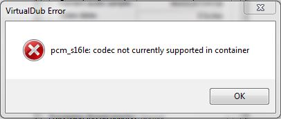

    I'm trying to convert/compress a 2GB AVI file to a ~120MB h.264 MP4 file using Virtualdub. I've done it before about a month ago, but now when I try to do it I get this popup:
    [Attachment 45802 - Click to enlarge]
    After looking it up I understand that PCM is the audio codec the original AVI file is using, but I don't see an option to convert it to another type of audio, the only option being to use no audio compression whatsoever. Is there a way to convert the audio using a command in an AviSynth text file, or is there a software I should download that will allow VDub to process PCM audio?

    As the message reads, PCM is not an audio codec supported for mp4. Only mp2 or aac are supported.
    You have two options. Check the audio codecs available under the audio >> compression menu and select one of the above. I guess you have direct stream copy checked at present.
    If you do not have either of these codecs installed you would have to install at least one to proceed.
    Or, if you are only converting, use a different program such as avidemux which has the appropriate codecs within the program.
    Avisynth will not help since it only processes the frames and you still need an external program such as vdub to process the script which gets you back to square one if you do not have the appropriate codecs.
    Ah, I did have it in direct stream copy mode. I switched it over to full processing mode and was able to access a different compression, which seems to have fixed the issue. Thanks! :)
