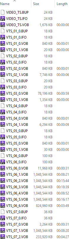

    I ripped the DVD using DVD Decrypter and this is what I get:
    [Attachment 45762 - Click to enlarge]
    However, the large VOB files (where the main video files are) are all mixed up inside.
    For example, VTS_06_2.VOB (15m 44s) contains parts of various episodes, as do the other large VOBs.
    There should be 6x 21-minute (roughly) episodes, with the fifth episode having audio commentary.

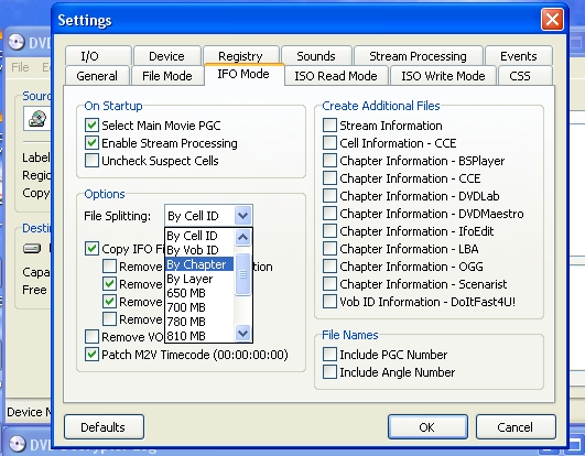

  5. Member Cornucopia's Avatar
    You ripped using DVDDecrypter in FILE mode. Should have used IFO mode, then you'll get a breakdown of chapters (by number, will list time each).
    From there, what I usually do is demux to raw streams and then later mux whichever combination of streams (e.g. V + A1 + A2) I want.
    Not only does this get you exact lengths you want, but it seamlessly stitches appropriate VOBs together behind the scenes, so don't have any breaks or glitches.

    Here:
