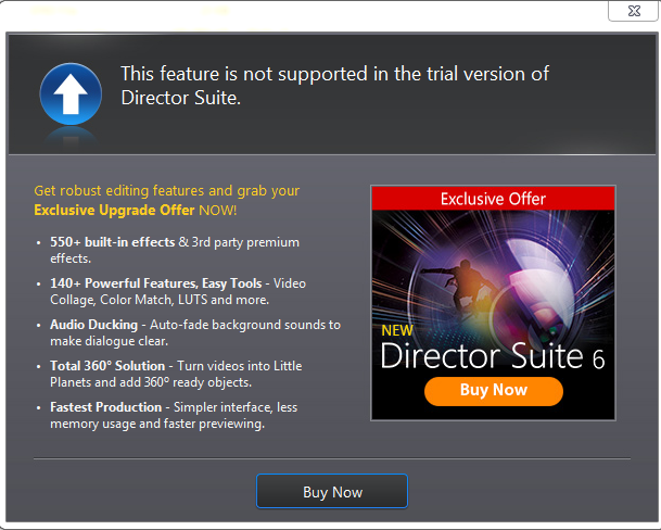

Installed PowerDirector trial.
It kept crashing within like 5 seconds of launch.
Emailed them a dump and awaiting a reply...
Until then...
In properties I set it to launch in compatibility mode... Windows 7... still crashed.
Changed to Vista version 2... not it launches and is stable.
HOWEVER!!
Upon dragging a video to the timeline from Explorer I get a popup
[Attachment 45931 - Click to enlarge]
HOW IS THIS A FEATURE... putting a video on the timeline is the most basic thing you can do!!
Shoot me. -
