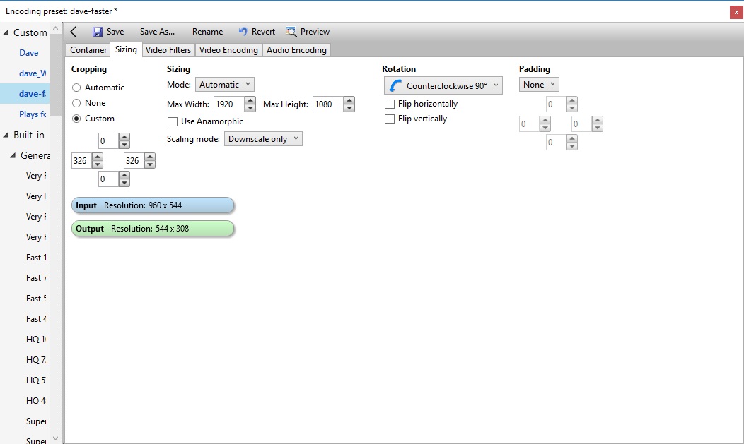

    I used Vidcoder to crop and rotate. Most of the settings in this program can be left as default.
    Oops - jagabo beat me to it!

  8. Thank you both of you, actually, very much indeed.
    @davexnet Pointing out which piece of software to use and how to set it up properly was exactly what I was looking for (so I could manage and rotate/crop 5 files for overall 4h30m on time for viewing it today)
