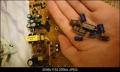

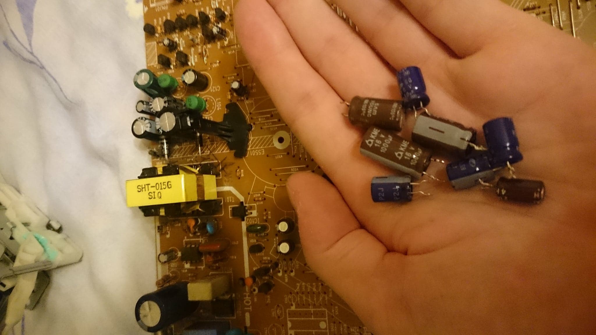

  7. I've removed the mechanical drive, got out the PCB and replaced all the electrolytic capacitors on the power supply secondary and some large electrolytics near the SCART connectors and now the picture is clean, no more noise.
    Thanks for the effort anyway, especially LMotlow, i'm sure I'll use some of that script anyway.

  9. Did you replace it with the correct types?
    Since this switched-mode power supply works with high switching clocks, is mandatory to use a low ESR type 105 ºC capacitors, otherwise this components will heat up with time because of the internal resistance, making matters worse, they can leak, pop, explode, etc. There is a second option if you want to keep this for life, use a polymer electrolytic capacitors, they use a dry polymer instead of a wet one, it has the exact same look as an standard electrolytic type.
    You can use a standard electrolytic capacitor on the signal path for video and audio, but never on the power path.
  10. Just curios... Did any of the replaced caps show obvious signs of problems? Bulging tops, for example.
  11. If the capacitors just dried out, there will be no external signs to be seen.

  13. No external signs of bad caps. I don't really care which of them were bad or why, I just replaced all of them (10 caps) and it cost me 1$. I don't have an ESR meter so I don't know.
    I was careful to replace them with 105ºC types and I put a little extra voltage ones, like 35V instead of 25V and 16V instead of 10V.
    I don't know about their ESR, the store only had 1 type of electrolytics of this temperature.
    I'll just use this VCR for a little time to convert a few tapes and then nobody will ever use it again, so I don't really care about long term. But for now, the picture looks noise free and is fine for me.
