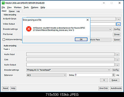

    Hi again.
    I have reinstalled MEGUI 2836 x64 as well as Debugmode Frameserver.
    The frameserver works. MEGUI x64 at least starts.
    I've tried frameserving from Vegas 15 using that avs script.
    Here's what MEGUI says:
    Help will be greatly appreciated. Thanks in advance.

  4. Member Cunhambebe's Avatar
    Mar 2004
    São Paulo - Brazil
    Hi there.
    amaipaipai, thanks so much for taking your time to respond and help me. I din't know you are displeased with x264 version available in MEGUI. Sorry to hear that,
    Anyway, let's see what I've got here.
    First: I am aware that most people I know runs MEGUI 2836 x32 on their w10 with no problems. Same thing is not happening here
    Second: I have tested AviSynt version (2.6.0) and it's working.
    Third: I have installed Debugmode Frameserver. It's working.
    About your DFSC problem, the author say that it doesn't work with Windows 10
    https://github.com/satishsampath/frame-server/issues/28
    -I guess that information is outdated. On their site they show a message for Vegas 13 + users to download a certain version (that I gues is x32, but works with Vegas x64).
    Debgmode is serving OK from Vegas to VirtualDub, VirtualDub2 and VirtualDub_FilterMode (all x32). Important: it doesn't work on VirtualDub x64 and other x64 versions, because the frameserver is 32, not 64, so that's why (I guess) MEGUI x64 (x86 is not running here, remember?) pops up that warning sign about fourcc DFSC Codec. In fact, the frameserver might be incompatible with MEGUI x64. So there's nothing to do with fourcc DSFC codec.
    Fourth: finally I've found out that MEGUI x64 works OK if an intermediate file is rendered (such as avi uncompressed) due to Debugmode being 32 and incompatible with MEGUI x64 version that runs here. The screens that pop up, as mentioned on my last post, may be related to automatic and/or auto render settings (one click button), that creates extensions such as ".lwi" files.
    Well, based on all this data, I relly don't know what's worong with my OS and what the problem might be.
    Your system log should point it out what is wrong and why MeGUI 32x is not working for you.
    Where can I find that, please? lol
    Thanks in advance.
    Cheers,
    Mark.
