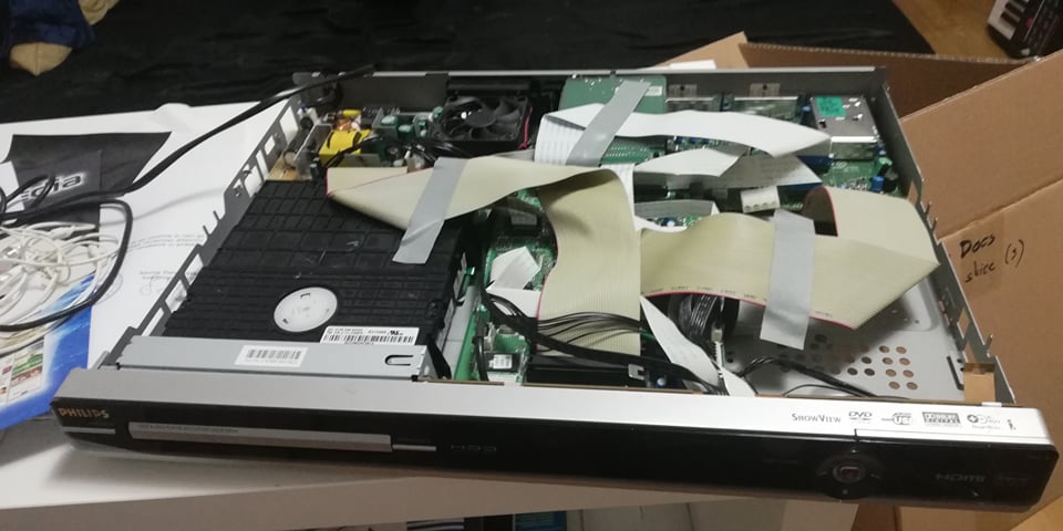

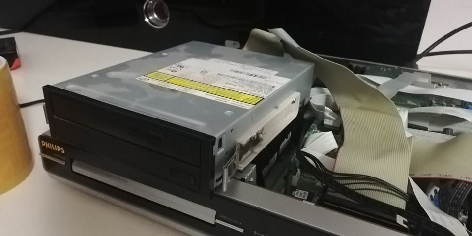

    Sollution is actualy very simple... I got Philips DVDR 3595 for free, in order to digitize my VHS tapes. Unfortunately DVD drive was busted. I checked all sollutions here, also with iso buster and HDD connected to PC and found out it is not needed. First of all, I connected IDE DVD+R drive to open DVD Recorder (see pic)
    [Attachment 55297 - Click to enlarge]
    [Attachment 55298 - Click to enlarge]
    I got plenty of those, ask friends, for sure there's someone having it. Next, then, Philips did record DVD on DVD+R put as suplement. IsoBuster would read it no problem, but it costs 49$ and you actualy don't need it.
    DVD disc, comming out of Philips DVDR is ordinary video DVD with VOBs, just not closed, that means, only Philips can read it.
    If you write on rewriteable DVD RW, PC can see it, but out of 20 RWs discs, actualy all were over 15 yrs old and full of errors when burned again (empty circles due to faulty material).
    Then I tried to burn ordinary DVD+R with my videos and PC would not recognize it. There's function Finalize disc on PC (any recording software, I use Nero / i guess even Philips recorder has it, but didn't check into menus...) and voila, after that, everything I burned on recorder, was available as DVD video to PC... You just have to use DVD Ripper software or copy VOBs and edit them by hand in Video software...
