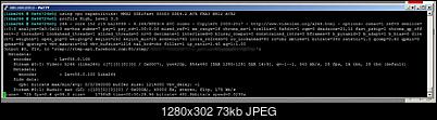

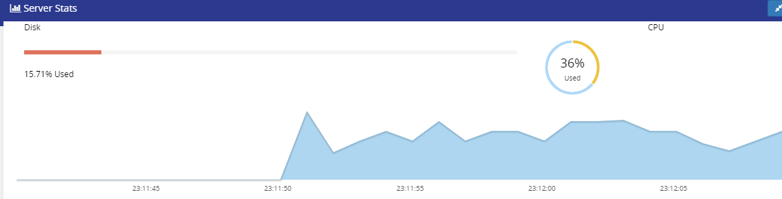

  1. Hi since weeks I'm trying to reach best and fast method to transcode Full HD h264 online media source to SD output with no success .
    I'm using rented VPS that have `Intel xeon E3-1240 v5`
    The video transcoding start fast at 1x speed "Im using -r option" but after few seconds it drop to 0.02x with ~ 0.6fps
    this is transcoding parameters I use
    ffmpeg -re  -i  https://someurl/test.ts  -i  logo.png  -filter_complex "crop=iw:ih-100:iw:-100:keep_aspect=1,scale=w=854:h=480,overlay=x=(main_w-overlay_w)-20:y=40" -bufsize 1216k -c:v libx264 -preset ultrafast -qscale 0 -vb 290k -c:a aac -ab 35k -f flv "rtmp://rtmp-api.facebook.com:80/rtmp/ssssssssssss"
    do I need to add/remove any more tweaking codes , and do you thing is't CPU throttling (form my host ) prevent me from having needed CPU resource ?

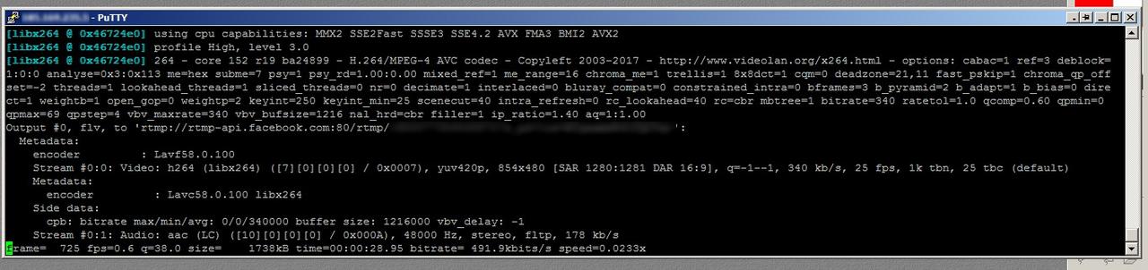

  5. I'm doing rebroadcasting of live stream my current home connection can't allow me to do the same commands (since I only have 1Mbit Internet connection ),
    My suspension is on Video filter I use could increase CPU usage or the VPS single Virtual cores , didn't have the power to handle Full HD stream (even I face same problem with SD stream now ) frame rate dropped a lot
    This is my last code :-
    ffmpeg -thread_queue_size 2612 -re -i https://someurl/test.ts -i /root/small.png \
    -filter_complex crop=iw:ih-33:iw:-33:keep_aspect=1,scale=w=854:h=480,overlay=x=(main _w-overlay_w):y=(main_w-overlay_w)-12 \
    -x264-params nal-hrd=cbr -vb 280k -minrate 280k -maxrate 280k -bufsize 300k -c:v libx264 -c:a aac -ab 38k -ar 44100 -f flv rtmp://localhost/hls/live
    Here I tried my best decres CPU usage
    BTW I have tow VPS do you agree with the idea that I do video filter on first VPS and send the output to the second one (VIA Nginx RTMP ) , to reduce CPU usage .

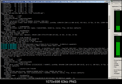

    --- Update I completely remove all video filters and the transcoding continued for ~ half hour with no frame dropping
    This is my code and ffmpeg output
    root@:~# ffmpeg -thread_queue_size 2612 -re -i http://someurl/test.ts -x264-params "nal-hrd=cbr" -vb 280k -minrate 280k -maxrate 280k -bufsize 300k -c:v libx264 -c:a aac -ab 38k -ar 44100 -f flv rtmp://localhost/hls/live

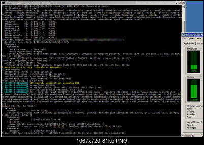

  8. Originally Posted by pandy View Post

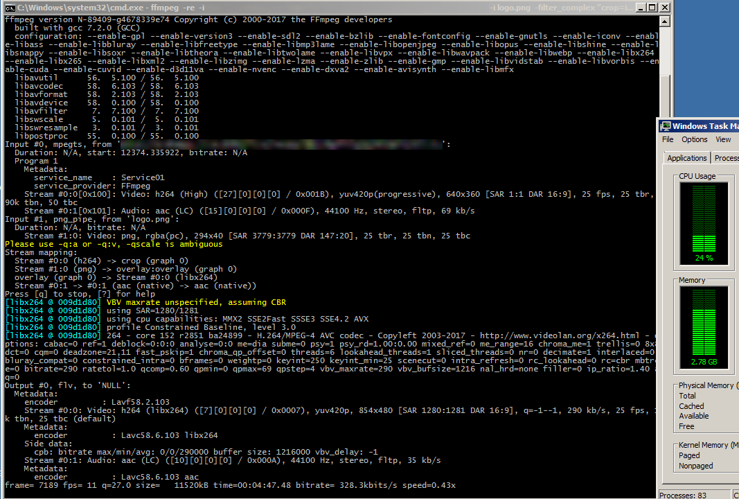

    Are you able to run same command on local computer (you can redirect output to null or file)?
    I use the first on my laptop ant reach 0.43x after few minutes
    when I use my second code it drooped to 0.74x with 16% CPU usage
    ffmpeg -thread_queue_size 2612 -re -i https://someurl/test.ts -i small.png \
    -x264-params nal-hrd=cbr -vb 280k -minrate 280k -maxrate 280k -bufsize 300k -c:v libx264 -c:a aac -ab 38k -ar 44100 -f flv NULL

    filters in ffmpeg are mostly single thread type... they may be explanation of the slow encoding - particularly overlay may be an issue - check color space, perhaps you can use https://www.ffmpeg.org/ffmpeg-filters.html#movie-1 instead two inputs, you may try to experiment with threading type.
    But not with my laptop CPU (core i5 3210m) I test it with the SD source and cpu usage were ~16% only .

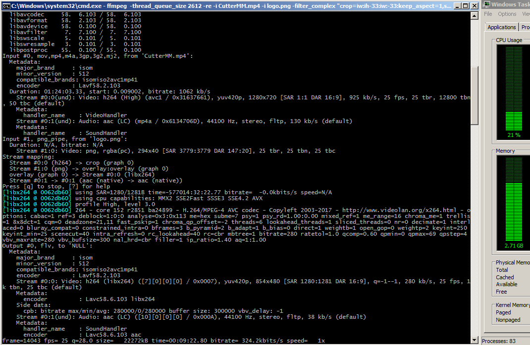

  10. Originally Posted by poisondeathray View Post
    Where is https://someurl/test.ts from ? Your local home connection to the VPS ?
    Maybe your bottleneck is your 1Mbit bandwidth. Next, test a local file input instead of https, locally on your laptop
    It's from live video source from Internet it has 600 kbs bitrate ,, anyway I did like what you said when I use local file framerate didn't drops at all it at 1x all the time even I notice q value showed on ffmpeg command at 29.0 , CPU usage were at 25% (I was keep Opera browser open while encoding )

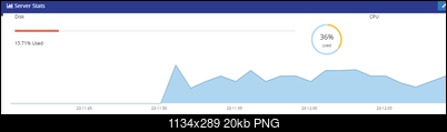

    My VPS have no network issue I reach 20MB/s download speed and it have 100Mbit/s upload line , - I have two sources one with ~ 5Mbits bitrate speed (The Full HD) and the other source with ~600Kbit/s (SD ) and I don't think the source dropping connection as I was able to download the SD source with my home connection (IDM) and the file were played with correct framerate .
    Lat CPU usage on my VPS was always at 100% when I use filter (both codes) but when I use the transcoding without any filters I was able to continue the transcoding for more then hour with few dropping farms from time to time (I guess that from the source ) since my VPS CPU usage were less than 50% .
  13. Where is someurl ? Where is the live stream being sent from?
    Laptop some url => 11fps
    Laptop local file => 25fps no drop. Perfect.
    Both same commandline, same hardware otherwise
    This means problem is the source "some url" bandwidth either server up , or down for you locally . At least for your laptop.
    Then the VPS is also bottleneck if it's pegged at 100%. Pay for a better VPS. Pay for better service, or complain to the host
    But if you are using "some url" to feed the VPS, then it has 2 bottlenecks
