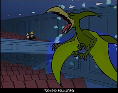

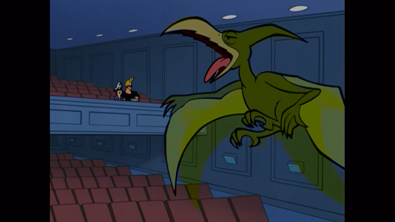

    Here is my problem:
    [Attachment 45692 - Click to enlarge]

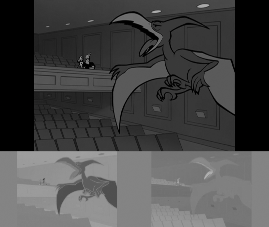

    Here is how the Chroma and Luma channel appear:

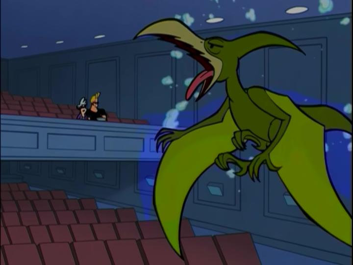

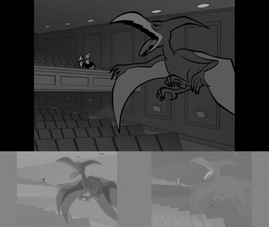

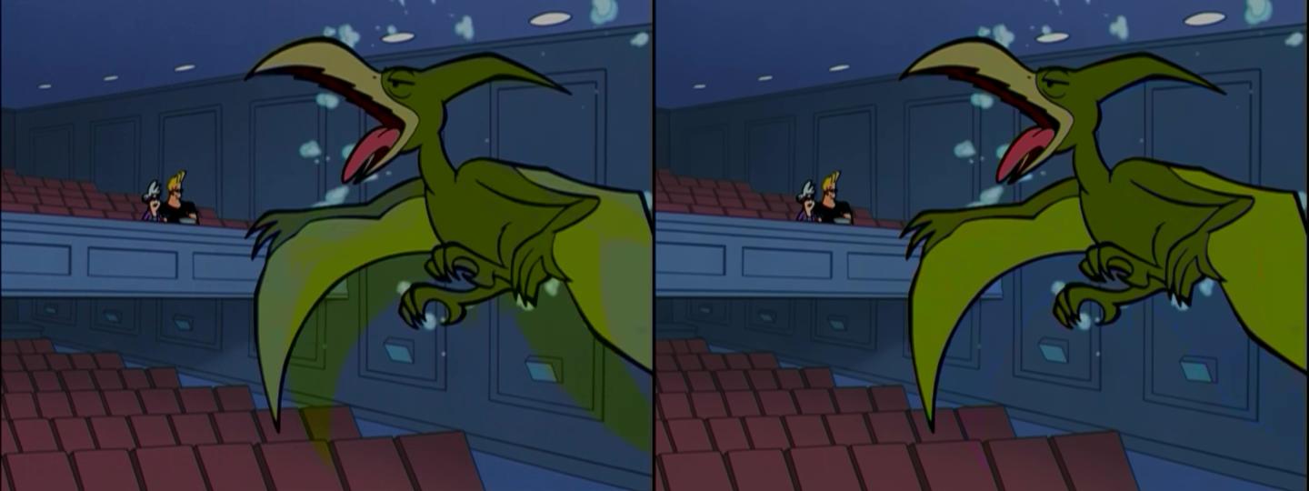

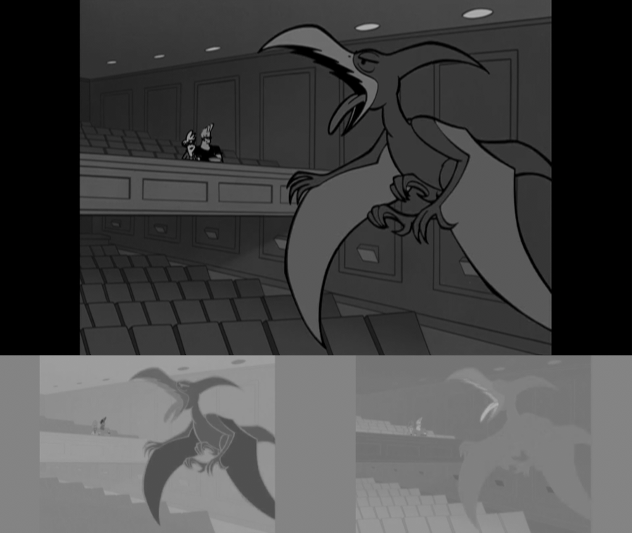

    Frame 0 (Ghosting has yet to occur)
    [Attachment 45693 - Click to enlarge]
    Frame 1 (Ghosting first appears)
    [Attachment 45694 - Click to enlarge]
    Frame 2 (Ghosting still present, appears to be an exact duplicate of Frame 1)
    [Attachment 45695 - Click to enlarge]
    Frame 3 (Ghosting is gone)
    [Attachment 45696 - Click to enlarge]
    This is the pattern in which the ghosting appears through the video.
    Please guys this has been driving me nuts.
  2. Common problem caused by treating interlaced YV12 chroma as progressive. Could be in your source or the way you're handling it. What's your source? What are you doing with it? Upload a sample of your source, not re-encoded.
  3. It's definitely the source, downloaded the clip from YT, All I want to do is actually remove the ghosting itself. Here is the clip completely untouched.
  4. Yes, the problem is definitely in your source, and from the bad interlaced YV12 treatment I described earlier.

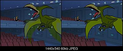

    On the left is the original frame, on the right the unblended frame. Unfortunately, applying that same manipulation to frames without blending messes them up:
    So some way needs to be developed to figure out which frames have blending and only replace those frames.
