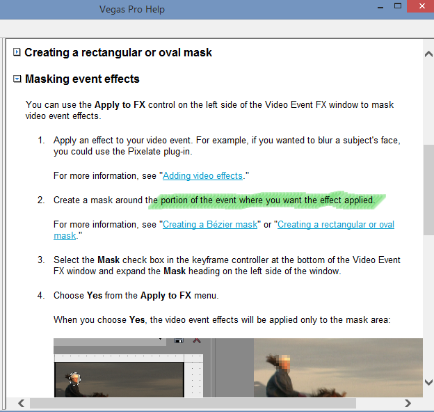

>there is a rectangle shaped section that has not been chroma keyed.
>It goes away if I move the clip around in pan/crop
If I understand you, it sounds like you have a mask in the filter chain.
It limits the effect to only part of the frame.
[Attachment 45671 - Click to enlarge] -
The order of fX in Vegas is also extremely important. You need to make sure that any resizing operation or any other fX that might resample the video not be done in the middle of the Vegas key operation.
