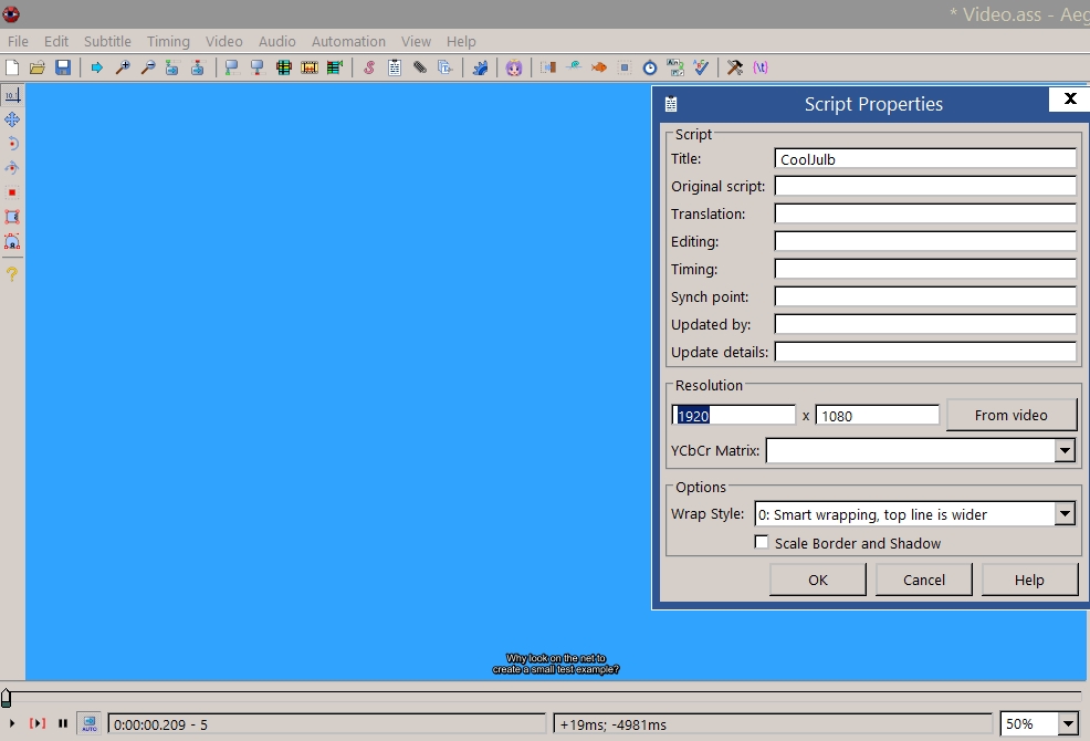

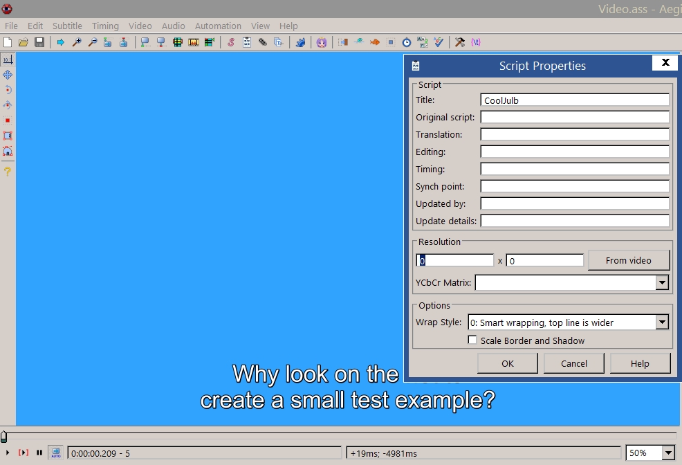

    As I see it you have two options. You could could use PlayResX/PlayResY of zero in which case a font size of 20 would look like:
    [Attachment 45686 - Click to enlarge]
    Or you could specify PlayResX/PlayResY in which case a font size of 20 would look like:
    [Attachment 45687 - Click to enlarge]
    There is no right or wrong here - it's for you to decide what you want.
