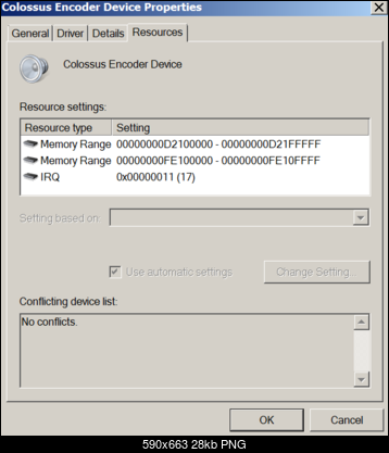

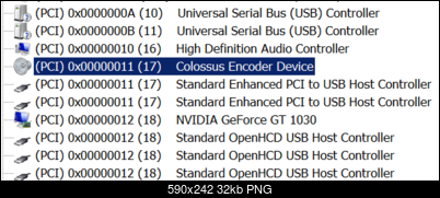

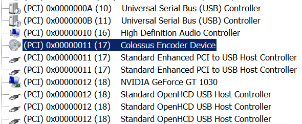

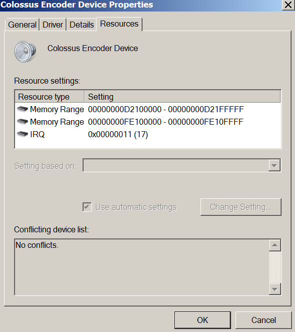

    I did take anti-static precautions when installing the card as I always do when opening up electronics. I did not check for IRQ conflicts, I actually hadn't considered that because I've never run into a problem like this before. I see a few entries with the same IRQ number, does this look like a problem?
    EDIT: Looks like no conflicts are reported

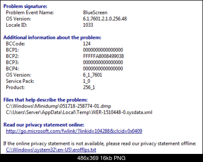

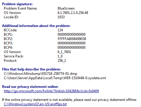

    Also, when Windows boot back up it displays a "Windows has recovered from an unexpected shutdown" message with the following problem details:
    [Attachment 45667 - Click to enlarge]
    You could try the "Generic Troubleshooting Strategy" a little way down on this page.

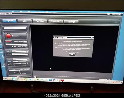

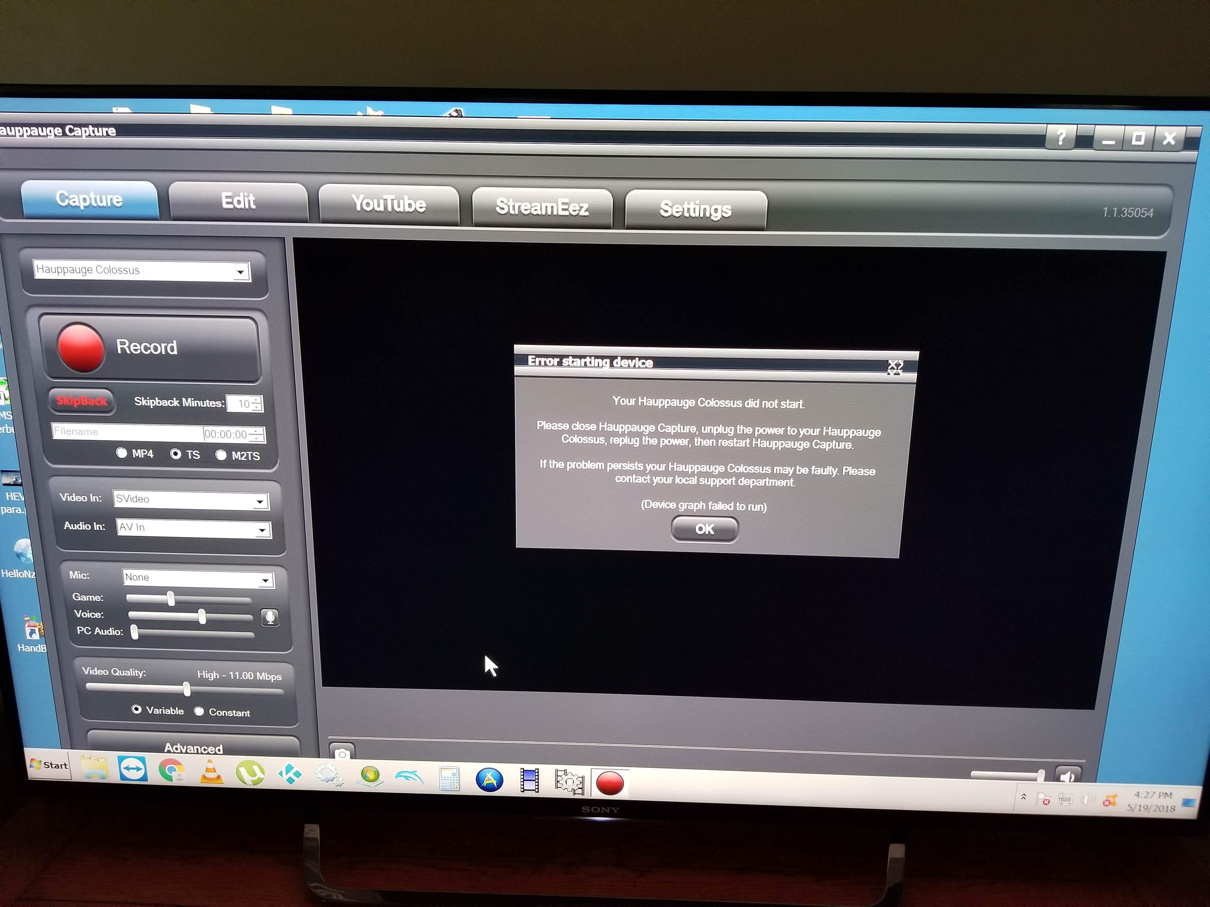

  6. With Capture4Me, I see the same issue. Occasionally I can view the signal for about 5 seconds before my computer reboots. Other times it does't work at all and says "waiting for s-video signal", even though there is one.
    I cleared the CMOS and saw this error in Hauppauge Capture for the first time. I think I've exhausted my options and I'll just call the card faulty.
  7. FYI: I wanted to provide an update just in case anyone in the future finds themselves in the same situation. I can confirm that the card was faulty. I ordered another Hauppauge Colossus (same model, version 1) and swapped out the defective one. It worked right away and I've been capturing my VHS tapes without issue.
