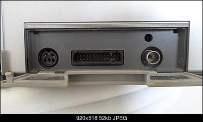

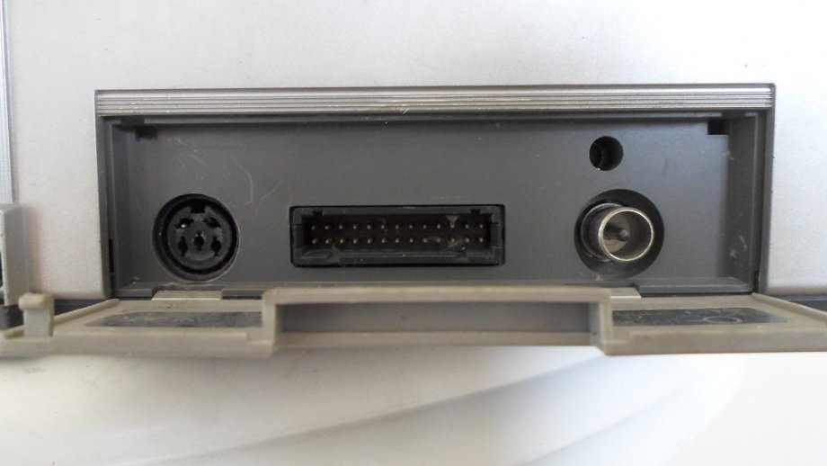

    What's the name of these connectors, the left and the middle? Does this S-Video-like connector carries Y/C separately, is there an adapter cable from that to S-Video input socket? What's the middle SCART-like conenctor? Anything to begin with that in a PALaland?

    the one on the left
    looks like a 5 pin 'DIN' connector, ?
    the DIN standard has been around forever , does NOT have to be 5 pins, there are pin configurations

    What is this device and what does it do?

    The one on the right looks like a coax jack for an antenna.
    Edit: I see you're only asking about the left and middle connectors

    Claimed a portable Betamax. Now I know some more info; apparently this DIN is a power-in, and the AC-in must come from a spearate unit that comes with this one, but sold separately, sounds crazy, ha ha. And the SCART-like socket is an A/V-out, something that needs some kind of adapter to carry on the A/V further separately. But still don't know if it's a Y/C capable.

    On the inside of the cover there seems to be a explanation for what the connectors are used for? can you take a picture from that?

    I don't have it myself, found the info here but nothing on the Y/C:
    https://www.palsite.com/slf1ovi.html
    And back panel input description visible:
    http://vintage-technics.ru/Sony_SL-F1E_TT-F1E/P1016292_Sony_SL-F1E_TT-F1E.JPG
    Just found the SCART-like connector description there as well, seems no Y/C
    http://vintage-technics.ru/Sony_SL-F1E_TT-F1E/Sony_SL-F1E_Connector.jpg

  8. The 'SCART' like connector looks like a standard 26 way Molex socket. The sort used on IDE disk drives but with 2x13 pin arrangement instead of 2 x 20. They are IDC (Insulation Displacement Connector) so a flat ribbon cable can be quickly attached without soldering but individual wires can be fitted or the ribbon rolled up to make it fir the round sleeve in the pictures.
