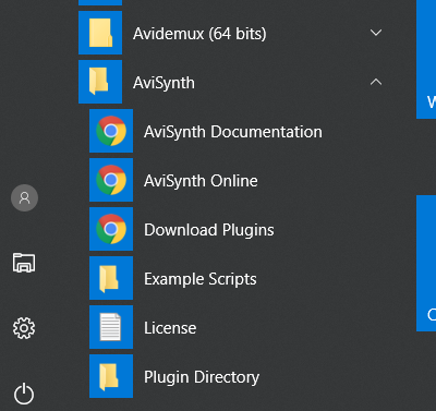

    Just installed AviSynth for the first time but can't for the life of me find the program to run, anywhere on my machine.
    Here's how things appear on my Start menu.
    [Attachment 45577 - Click to enlarge]
    Am i missing something?

    You certainly are. First clue is in JVRaines' reply, above. Second clue: didn't you see "Avisynth Documentation" big as all heck on that Start Menu? Wonder what would happen if you click on that menu item?

    Brief addition: AviSynth is/has no application; being a "video frameserver", it supports other video applications by reading media sources for them (and possibly filtering the decoded source).

    Oh i see, it's not an actual program but works through using Text Documents.. clever! Does it only work with AVI files though? I'm trying to open MP4 files, as i want to deinterlace alot of them and maybe edit/join without needing to render it all in a video editing program, but the files don't seem to open.
    Looks like a very complex thing to get your head round.

    I know exactly where the program file is installed, I was just confused as to why there was no .exe file, but now learned there shouldn't be one.

    Avisynth has some built-in functions and external plugins for importing various media formats. One of the first things to learn is that mp4 is a container, not a format, and it can be encoded in many ways. Try this guide from the extensive Avisynth wiki: http://avisynth.nl/index.php/Importing_media
    The primary deinterlacer is QTGMC, but you can use the yadif plugin -- the latter ain't as good, but better than your typical editor.
    When you open a file in AVisynth it is decoded and uncompressed. The results have to be re-encoded. Avisynth is not an editor.
    The file that actually "runs" Avisynth is avisynth.dll.
    In 32-bit Windows it's in System32.
    In 64-bit Windows the 32-bit version of avisynth.dll is in SYSWOW64.
