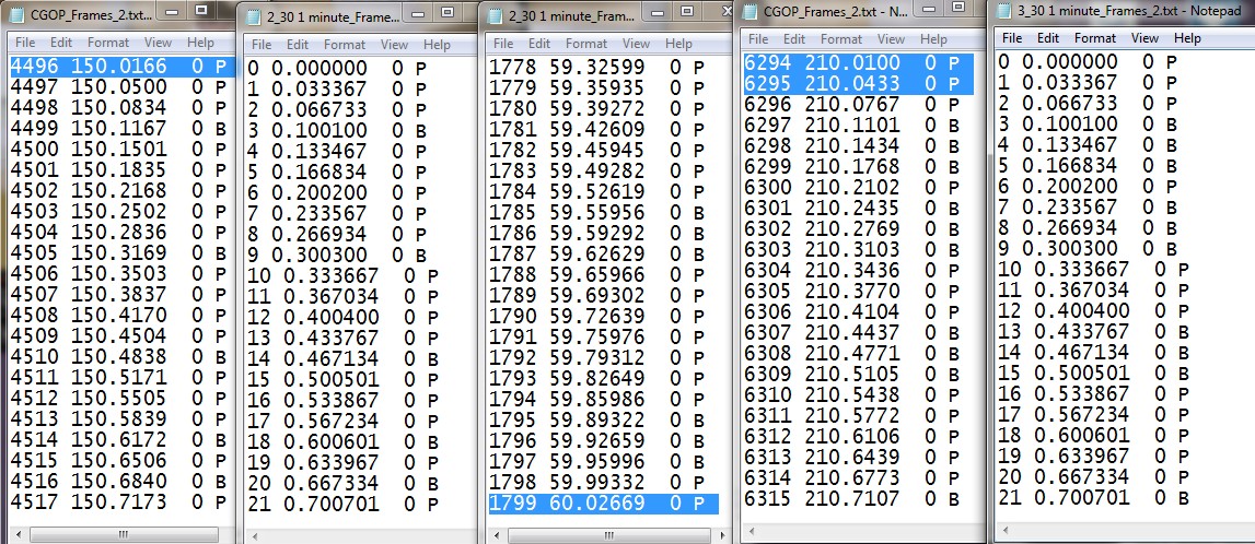

    UPDATE:
    After testing a video cut from 2:30-3:30 and another cut at 3:30-4:30. I got 2 playable videos. However, they overlap by a frame or 2 since the frames do not start on an even time boundary since my test video is 29.970 FPS and each frame is 0.033367 seconds long. I have shown the results of the Open GOP video I used and the times of the frames that correspond on the output video to the first start time of 02:30.000 (150 seconds) and 03:30 (210 seconds). Notice the first video output is 1800 frames (0-1799). If you add 1799 to the frame number cut Point of the original video (Frame 4496) you get 6295 or the second frame of the second minute.
    If this is acceptable, it seems like it shouldn't be too hard to come up with a batch file that would do this for you by someone better at batch files than I am. What happens when you convert or repack them to an MP4 with no leading I-Frame, I do not know. I use Potplayer and these 2 videos play without an abnormalities that I can see. The durations are 1 minute 2 seconds and 1 minute 1 second.
    [Attachment 45565 - Click to enlarge]

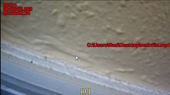

    AFAIK... The other types of frames can be found by using AVISYNTH to check as the video is playing. I have not verified this because I don't seem to have any Videos with these Transition type of frames. I use:
    FFmpegSource2("C:\Users\Bud\Desktop\FramesCuttingJoining\Beta Test\temp\CGOP.mp4", atrack=-1).Crop(0,0,-0,-2).LanczosResize(720,404)
    ScriptClip(Last, """Subtitle("[ "+Chr(FFPICT_TYPE)+" ]", size=(Height*56.0/720), align=2)""", after_frame=true)
    Subtitle("C:\Users\Bud\Desktop\FramesCuttingJoining\Beta Test\temp\CGOP.mp4", x=720, y=202, font="Arial", size=24, text_color=$ff0000, align=3)
    ShowFrameNumber(scroll=true, x=10, y=27, font="Arial", size=24, text_color=$ff0000)
    ShowTime(x=72, y=44, font="Arial", size=24, text_color=$ff0000)
    ShowSMPTE(fps=29.97, x=68, y=61, font="Arial", size=24, text_color=$ff0000)
    These are what is SUPPOSED to be shown:
    I: Intra
    P: Predicted
    B: Bi-dir predicted
    S: S(GMC)-VOP MPEG4
    i: Switching Intra
    p: Switching Predicted
    b: FF_BI_TYPE (no good explanation available)
    ?: Unknown
    Playing the AVS script gives something like below, but I have not verified this.
    [Attachment 45572 - Click to enlarge]
