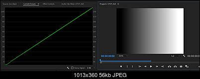

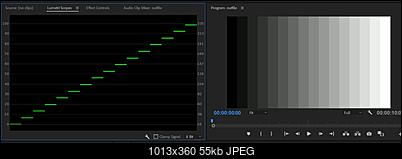

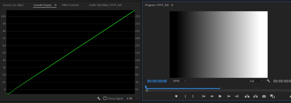

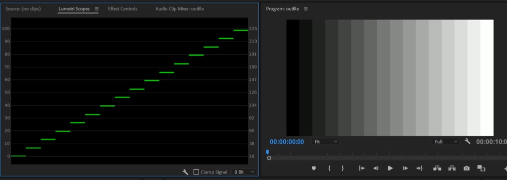

  3. Originally Posted by chris319 View Post
    Note that in all of your scope shots there are no graticule lines for digital 0 or 255.
    IRE 0 to 100 is same thing as Y=16 to 235 . You can change the "look" if you want
    This is a YC waveform (shown here without the "C", since it's greyscale pattern)
    outfile.mp4
    true full range example
    Obviously if I push "clamp signal" button, nothing will happen to outfile.mp4, because it's limited range. There are no values below Y=16, or Y=235 . That is why lutyuv is doing nothing when you set it to clip <16 , >235 .
    Note that "previews" are not always accurate, because they are RGB converted representations for the YUV data. And there are many processes and settings and color profiles that can affect how preview is rendered. But the waveform is supposed to be measuring the YUV data directly . It's 1 step closer to the true values of what you're measuring

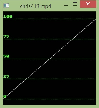

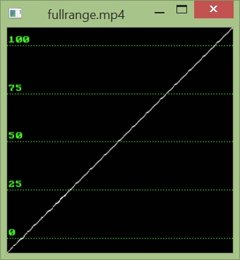

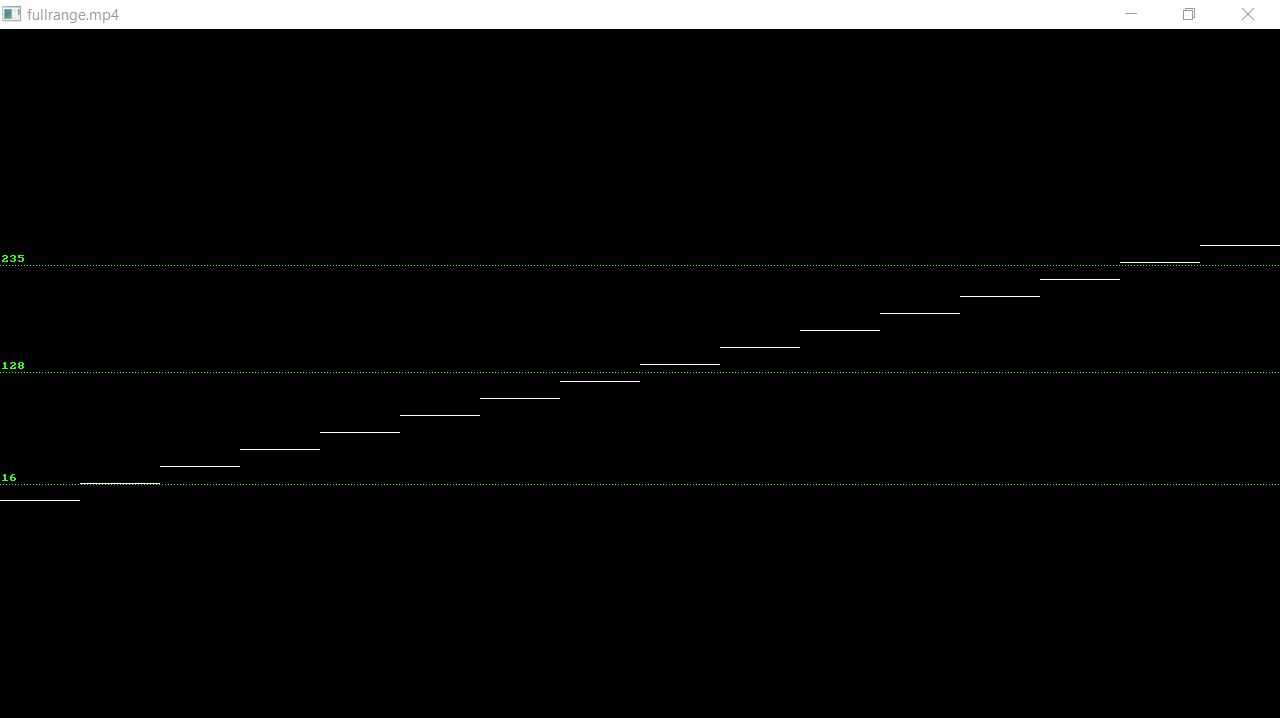

  9. Again, the problem is stairstep.mp4 has Y = 16-235 levels . Your commandline never specified full range to produce full range. You're essentially "mapping" RGB 0-255 to Y 16-235 (standard range) , instead of RGB 0-255 to Y 0-255 (full range) . Thus there is nothing to clip with lutyuv .
    Here is a demo, all files are included in the zip
    Here is a greyscale test pattern image 0-255 RGB "greyscale.png"
    Here are 2 videos, one uses your commandline which uses standard range (you need to specify full range to get full range).
    chris219 standard range
    ffmpeg -r 24 -i greyscale.png -pix_fmt yuv420p  -crf 17  -c:v libx264  -vf scale=out_color_matrix=bt709  -color_primaries bt709  -color_trc bt709  -colorspace bt709 -an chris219.mp4
    fullrange
    ffmpeg -r 24 -i greyscale.png -crf 17  -c:v libx264  -vf scale=in_range=pc:out_range=pc,format=yuv420p -x264opts colorprim=bt709:transfer=bt709:colormatrix=bt709:fullrange=on -an fullrange.mp4
    Notice the metadata is correct too, indicating full range. The metadata does not affect the actual video bitstream levels, but it's more proper to use correct signaling. The receiving application might use it to convert back to RGB for display properly. Recall I said there were many factors affecting the preview, this is one of them. You can have full range video, but "labelled" as limited, or vice versa. They are just "labels" and can be wrong. "Don't judge a book by it's cover"
    chris219
    Color range                              : Limited
    Color primaries                          : BT.709
    Transfer characteristics                 : BT.709
    Matrix coefficients                      : BT.709
    full range
    Color range                              : Full
    Here is the ffmpeg scope.
    ffplay chris219.mp4 -vf waveform=filter=lowpass:scale=ire:graticule=green:flags=numbers+dots
    ffplay fullrange.mp4 -vf waveform=filter=lowpass:scale=ire:graticule=green:flags=numbers+dots
    chris219
    full range
    And you can verify the levels in professional applications. They all say the same thing

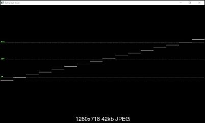

  11. Congratulations! It works now that you've added the full-range filter. You were right; the default is TV range (16 - 235) after all.
    This code works,too. Note that it does not specify an in_range, only an out_range:
    bin\ffmpeg -y  -r 24 -i stairstep.bmp -crf 17  -c:v libx264  -vf scale=out_range=pc,format=yuv420p -x264opts colorprim=bt709:transfer=bt709:colormatrix=bt709:fullrange=on -an fullrange.mp4
    There is another caveat: with the stairstep signal, the top and bottom steps get lost in the window borders, so it is necessary to expand the window vertically or maximize it to see those steps.

    The good thing is that the artifacts are invisible. However, technically it won't pass QC if the artifacts are too high.
    Typically they "legalize" video with a hardware legalizer:
    https://mixinglight.com/color-tutorial/legalizing-video-harris-dl860-part3/
  21. Originally Posted by chris319 View Post
    This is after some high-frequency rolloff (unsharpening). There was much more ringing coming straight out of the camera.
    The idea is to get rid of the artifacts without reducing the overall level of the picture. Unsharpening is the only way I've found so far to do this. Do you have any other ideas?
    I don't know what you're talking about exactly, what artifacts exactly . You're going to have to post some videos or more information or better descripton
    In video, "ringing" is a typically a term reserved to describe oversharpening halos. They are the high contrast edges, made worse by sharpening. They literally look like rings or halos.
    A hardware or software legalizer does many things, but sometimes it's not a good way of tacking some problems. For example, sometimes they clip values, sometimes a linear shift. Often that's not ideal, it's more of a shortcut or time saver. Sometimes highlights look terrible after passing through a legalizer, you get splotches or banded transitions

  26. [QUOTE]Essentially it's Y 16-235 => RGB 0-255 . So you don't even "see" Y<16 or Y>235 , the "superdark" or "superbright" full range values
    So fix this to be YUV?
    FILE *pipein = popen("ffmpeg -i outfile.mp4  -f image2pipe -vcodec rawvideo -pix_fmt yuv24 -", "r");
  27. Originally Posted by chris319 View Post
    It looks like the ringing is being caused by contrasty edges, so something that would smooth them out. It would have to look at neighboring pixels. I could try this with Ted Burke's code, but I'm not sure how to handle the audio. I also have Matlab.
    If pixel > 235 and neighbor < darker shade, then blur them.
    I tried to get avisynth working last year but was never able to. Can it do pixel-by-pixel manipulation?
    If you can't describe it accurately, post a video sample , someone will look at it. Maybe in a new thread with descriptive title is a better idea. As you can imagine you wouldn't be the first trying to deal with video problems - there are specific filters and workflows designed for specific types of artifacts and problems. I'm guessing it's some type of general noise and exposure problems, along with sharpened edges. A video is worth 10,000 words.
    You can probably get avisynth to do almost any type of manipulation . There are probably filters and scripts already made for whatever your problem is. But if you wanted to, you can piece together any math operation with masktools2 and it will evaluate all pixels and apply whatever you specify . It's really a variation on a LUT . You can use ffmpeg LUT filter too, but masktools2 has more defined accessory functions and operators
    A potential problem and massive headache with that Ted Burke code is the RGB step. Especially if it's automated without user entry or manipulation. -pix_fmt rgb24 uses swscale for RGB conversion, and Rec601 by default, but ffmpeg behaviour now is partially modulated by flags. eg If you had unflagged or flagged limited range video with overshoots (e.g. 90% of regular consumer video is actually 16-255), it will clip usable values (the vast majority have usable signal you can rescue). A full range example works only if it's flagged correctly as full. ie. Full range YUV gets converted to RGB using full range. But if it was full range, but unflagged, you would get the wrong standard range conversion to RGB. Moreover, sometimes you have wrong flags like standard range video flagged full (e.g. somebody messes up somewhere, or some software just automatically tags, or some video is resized but colormatrix isn't adjusted for) . If ffmpeg (or any program) paid attention to flags, you'd get incorrect results. If you don't control exactly what the in/out range and matrices are for the RGB<=>YUV conversions, you're going to get burned at least some of the time. In that respect , you can see why some programmers choose to ignore flags for their software . It's even worse now, because of Rec2020 and various HDR flags and metadata. There are about a dozen new ones and it's becoming more mainstream
  28. I don't know why you're making such a big deal about YUV -> RGB conversions. Recall that I asked about making Ted Burke's code be all YUV. If that can happen then conversion to/from RGB is moot.
