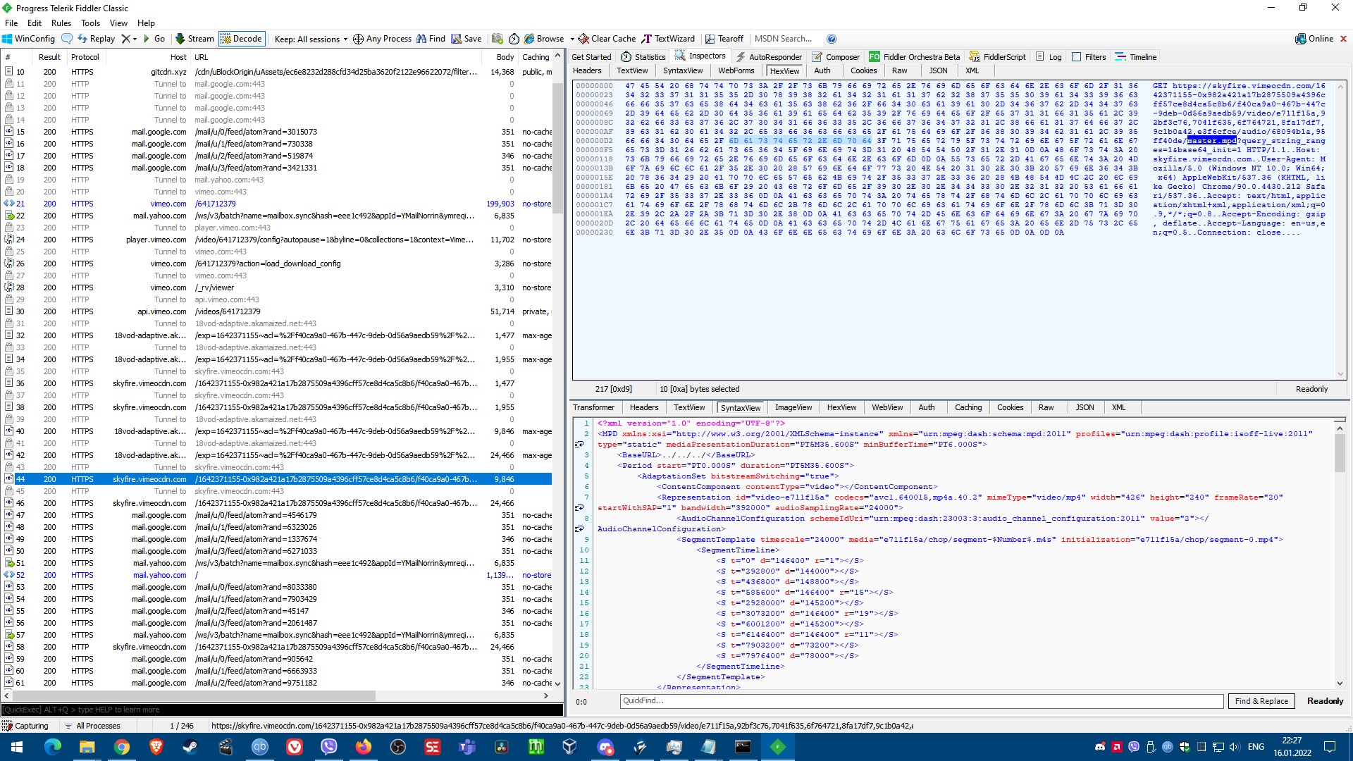

  7. Originally Posted by Gew View Post
    Hmm, guys, has Vimeo started using another name than ~MPD for the manifest, lately? I'm trying to retrieve a Vimeo video that does not appear to be DRM-protected, I can fetch it using free web utilities such as savethevideo.com/ without any problems, so I sort of have it worked out already, but just out of pure stubbornness, I'd like to know that I can process it manually, too, using nothing but a web browser and ffmpeg binary for utilities. However, running the Developer debugger in my browser, watching the Network section, I get all these segment-<no>.m4s files spitted, but when I filter for "mpd" I get nothing, so I'm kind of dazed and confused at the moment Ideas?
    Vimeo never really had clearly visible mpds.
    You can find out the mpds if you use Fiddler and ytdlp -F "link".
    [Attachment 62935 - Click to enlarge]
    You should definitely switch to using ytdlp for downloading.

  9. Originally Posted by [ss]vegeta View Post
    I have understood that this piece of free software is widely used and considered neat in all ways.
    I will start using it for sure, but I still like to know if there's a way to get the MPD link manually.
    Fiddler is not freeware and I'd rather just use GNU/GPL stuff for my workflow.
    However, I guess Developer console in Firefox or Chrome would work as well?

  10. Originally Posted by Gew View Post
    I'm not talking about Fiddler Everywhere.
    Fiddler Classic is freeware and that's what I use.
    Not sure about that, I couldn't find MPDs via the developer tools. They are probably there, somewhere, but hidden inside something else.

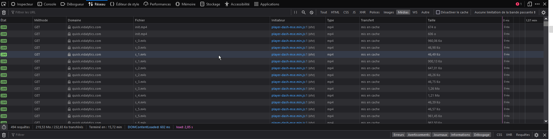

  11. Hello, i would like to download a video with several m4s segment in network but i can't find any mpd file on it to download it with youtube-dl...
    [Attachment 63109 - Click to enlarge]
    Here is the video link : https://numadeo.com/machine-typ50654536
    Thank you very much
