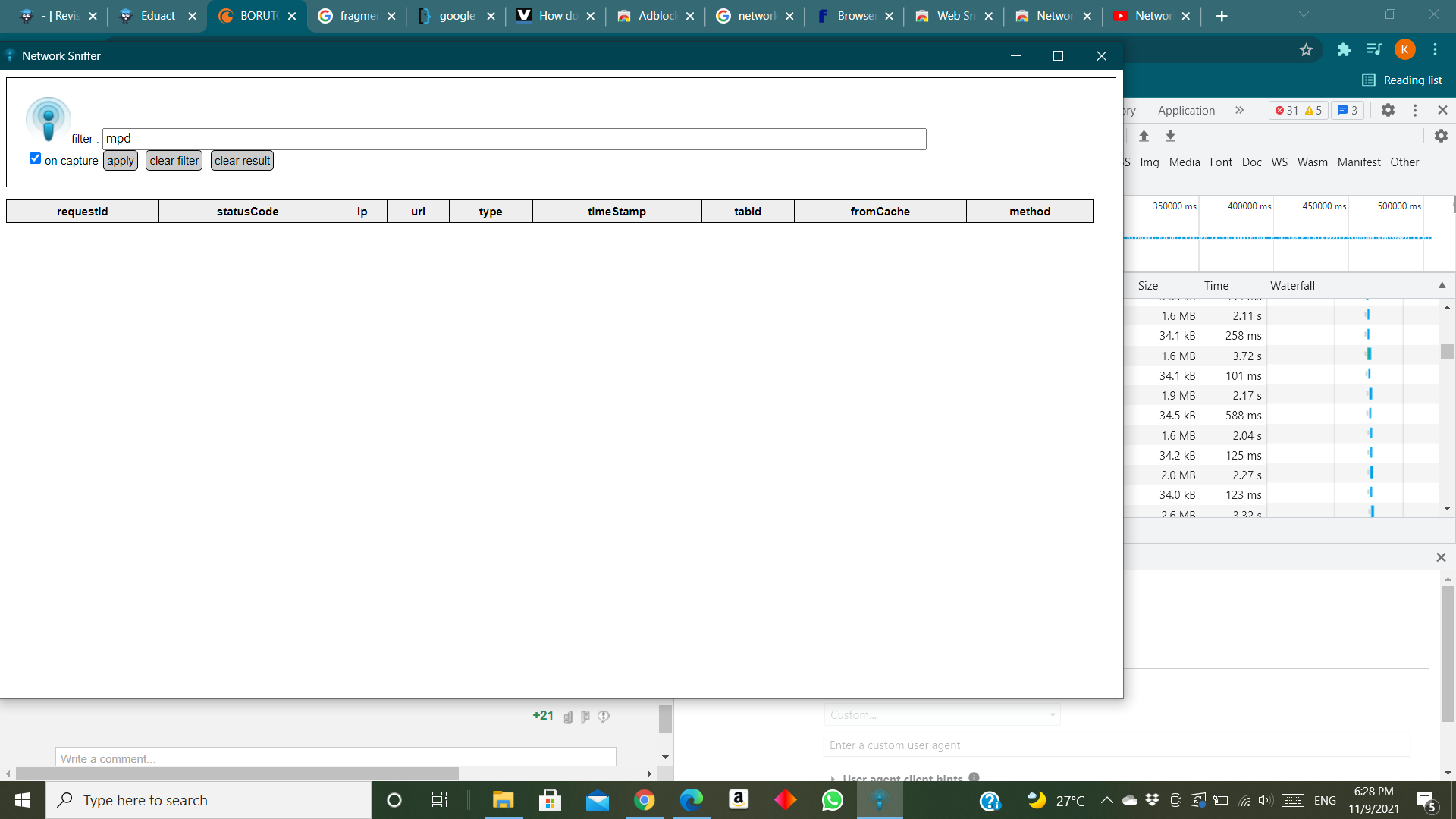

  20. Hii guys,
    I can't find any mpd master files with network sniffer, any help?
    No need for help problem solved!
Name:	Screenshot (2338).png
  21. Open the developer tool before you load play the video
    discord=notaghost9997

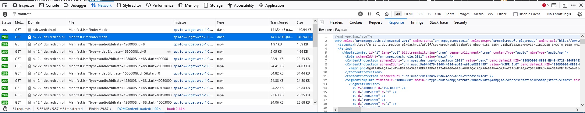

  24. Hi, I need your help to download these video file from polish vod page. I can't see any .mpd file in edge (f12 + network).
    I'd appreciate it if someone can help me out.
    Thanks in advance
  25. Originally Posted by Piksel View Post
    This manifest is your mpd
    [Attachment 61826 - Click to enlarge]
    use ytdlp to download
    use this key
    WidevineDecryptor: e809d0600b56e9499723564f8483d1bf:12d0fc6f7e20cb2e867261b67624b4e5
    to decrypt with mp4decrypt
    use ffmpeg to merge video and audio
    read/search the forum, you'll find these stuff explained a lot of times
