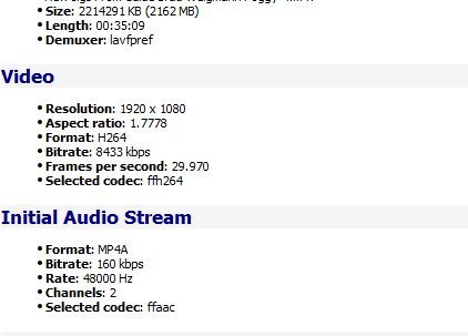

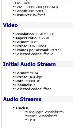

    Thanks for the replies. I tried it with the h265 and it went from 4.200 to 3.600 gb. I'm attaching the video stats from this and another one I did with Handbrake that went from 4.2gb to 2.2. Not sure if this gives a hint as to what I did different.
Name:	4.2gb to 3.6 apr.28 handbrake h265.jpg
Name:	HD earlier 4200 to 2200 Handbrake 30 min.jpg
