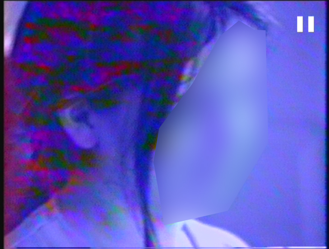

The unit seemed to be doing a good job of it (Source is a Hi8 deck in good condition with S-Video out), except that it kept on starting to make the picture go horribly blue with tons of artifacts, like these red bits on the picture I uploaded (audio & video dropouts are fixed by the DMR's Time Base corrector though, but at what cost...).

ps: Here is a still frame (I blurred the part in the middle), so you can see what I am talking about
[Attachment 45392 - Click to enlarge]
