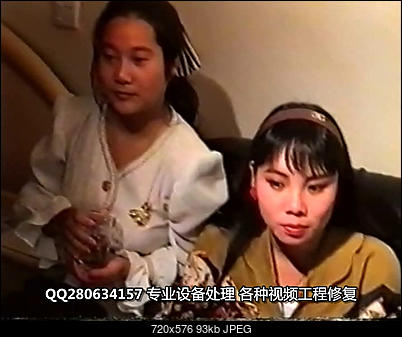

    Hello, I am in China. Chinese VCR players have no concept of TBC. In fact, the biggest problem with capture devices is the color problem. For example, conpus's ADVC series, there is always the problem of lack of color through the monitor. In fact, if we can achieve the perfect TBC pass on the color reproduction of the digital miniDV of the AV cable at the terminal device? I found a USB device that seems to be the ideal workflow. After watching the youtube video, I discovered that it did not have problems with insufficient color or darkening.
  5. Originally Posted by lordsmurf View Post
    Is it good? Nope.
    Mixers tend to have weak TBCs (if any at all), and then they expect broadcast sources. At worst, S-VHS, as you (used to) find in high schools, colleges, and local cable companies. But it was more ideal with Betacam. These days, everybody is using HD cameras, DV SD at worst. Yes, DV processed on an analog mixer, if for no other reason than teaching purposes + budget constraints of the program.
    Bit precision means squat with VHS/S-VHS or Video8/Hi8. As long as it has 8 bits, you're fine.
    If you want a mixer, fine, get it, great mixer. If you want a TBC, then get a TBC.

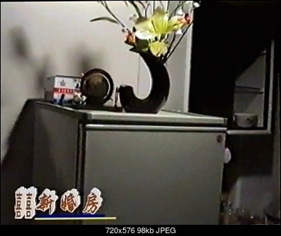

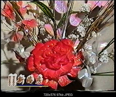

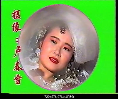

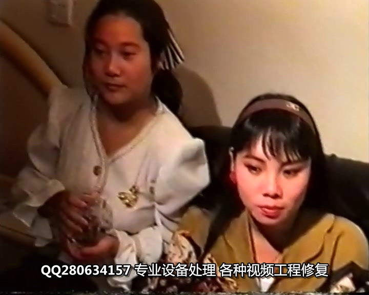

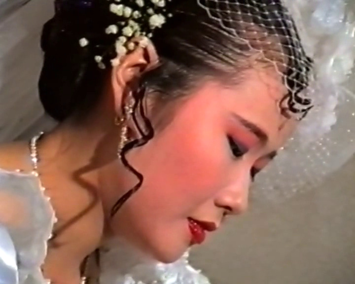

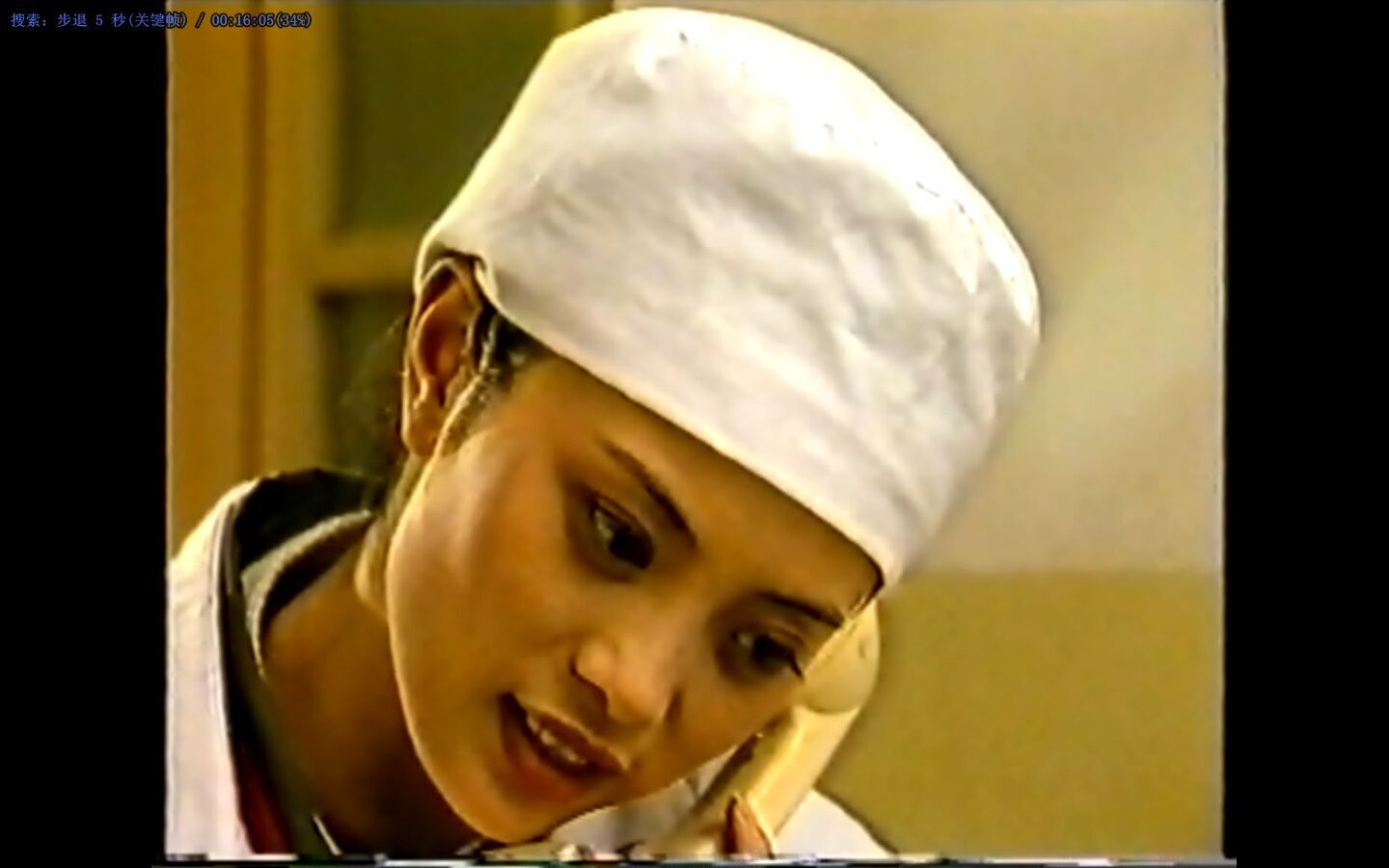

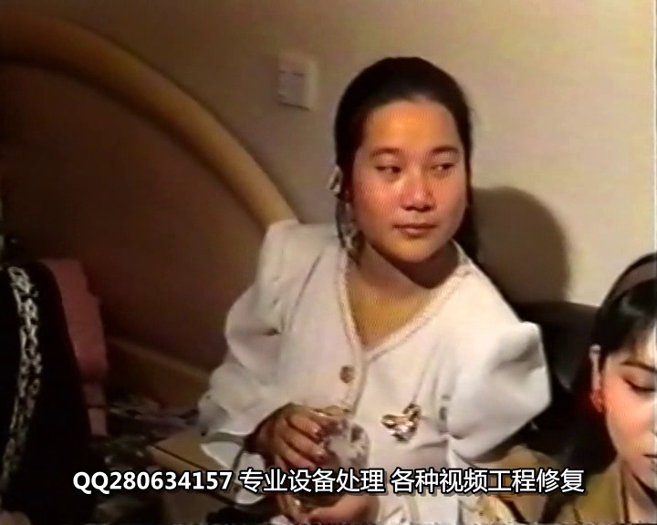

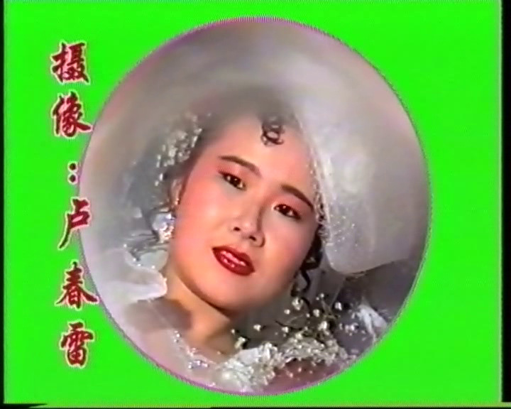

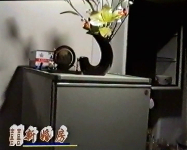

    There is already enough test data to show. The digital camera is more capable of correcting the edge image, but because the digital camera is not S-VIDEO transmission, the color and contrast will decrease. But recently I have seen a satisfying color in China. I think it should be a pinnicle device. Its parameter is mpeg2(8000 rate)
    But it is the most perfect color I have ever seen. Although it has a certain TBC problem, it has no problem with its color.

  6. Should we critically update our concept of capture and use color capabilities as an important basis for assessment? This tape is PAL common format. But it is already the best color recovery level in the world.
    You must be nearly blind and have been looking at some godawful ugly color. Those women have skin that looks as if they have critical liver disease. Pumpkin colored skin? Crushed blacks? Smeary blurry image?
    The more I look at the images the more I realize that you're joking.

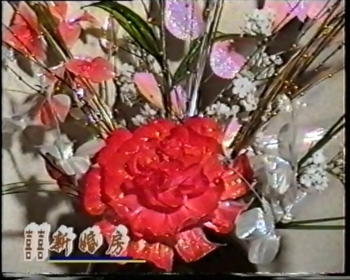

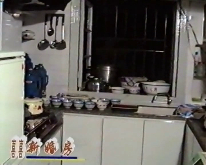

    This is Panasonic's CVC technology. At the same time it has DNR, haha. CVC is characterized by jelly color.

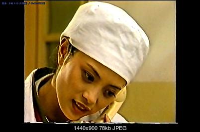

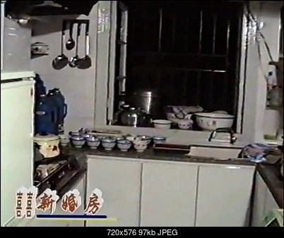

  12. Click image for larger version
ID:	45412Click image for larger version
ID:	45413Click image for larger version

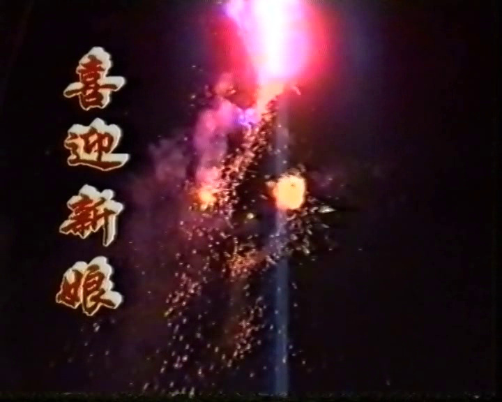

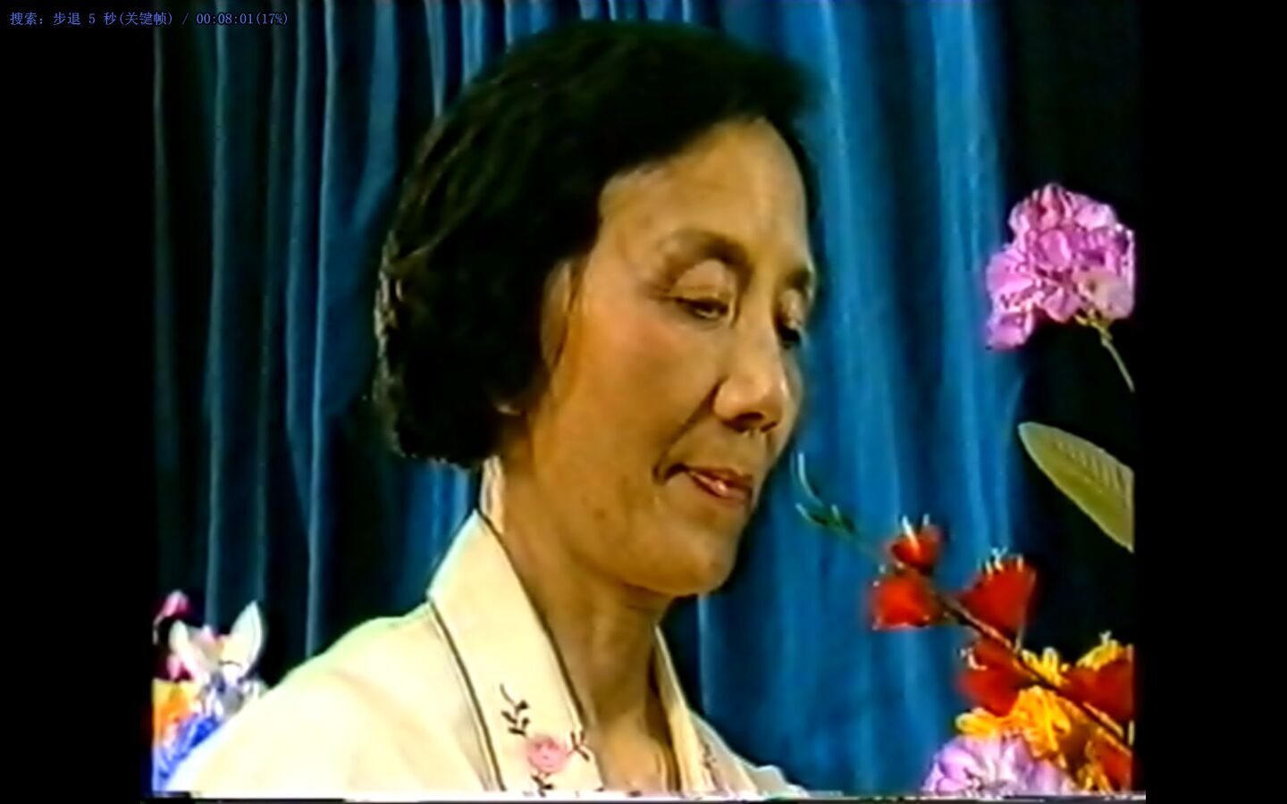

    Equipment AVerMedia C725 effect

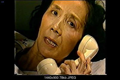

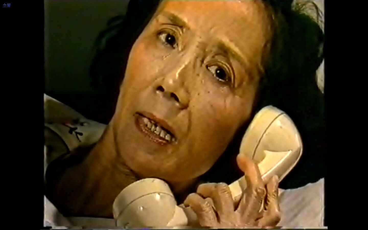

  13. Click image for larger version
ID:	45415Click image for larger version
ID:	45416Click image for larger version
ID:	45417Click image for larger version
ID:	45418Click image for larger version
    Equipment AVerMedia C725 effect +1999 12 AG 4700 PAL VHS 1993 remaster by me(made in china)
    NDR on TBC on
