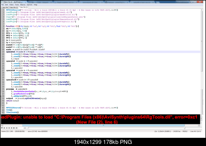

    For x64 it's available through RgTools . It's a re-write of the original RemoveGrain . But you still call it in the script RemoveGrain(whatever settings) ; it's just that the .dll is RgTools.dll
    There it is -- it was RgTools.dll, that is what's making RemoveGrain work. And that in was the hidden jewel that "completely" remove those DCT ringing artifacts.

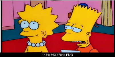

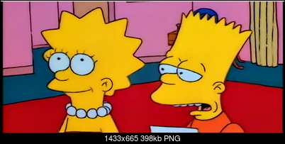

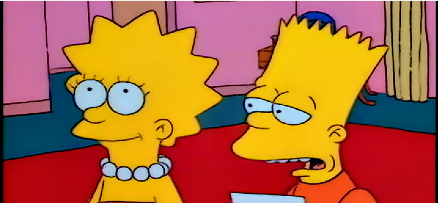

    You weren't kidding about NLmeans. About 1 FPS with means vs around 10 FPS without.

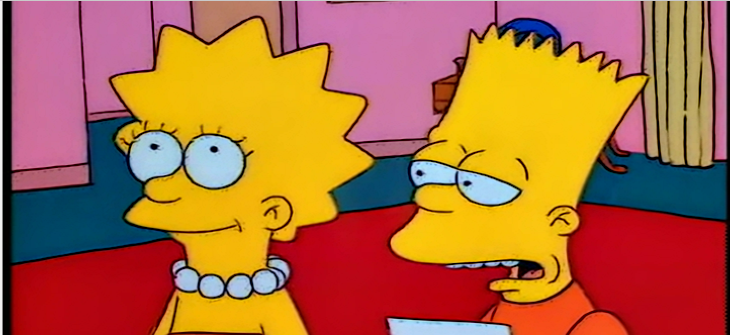

    Looks like the ability to remove those pesky DCT ringing artifacts was already present with RemoveGain. Internet research, experience from some users say to not fiddle with the default values much, thus I left RemoveGain's setting on default. Amazingly enough changing the "mode" to either 3 or 4 almost almost "completely" remove them. Not really completely, but much much better.
    RemoveGrain(mode=4, planar=false)
    Anything above a 4 and the DCT ringing artifacts returns. Mode 1 and 2, were very subtle. Modes 3 or 4 are probably best at the expense of some details. Bumping up the value of FastLineDarkenMOD helps to counter the loss in details.
    All four images have filters applied. The only difference is changing RemoveGain's from mode=1 to mode=4
Name:	DCT ringing artifacts a (dots).png
ID:	45484Click image for larger version
Name:	DCT ringing artifacts b (Mode=4).png
ID:	45485Click image for larger version
Name:	DCT ringing artifacts c (plane=4).png
ID:	45487Click image for larger version
Name:	DCT ringing artifacts d (Mode=4 Planer=false).png

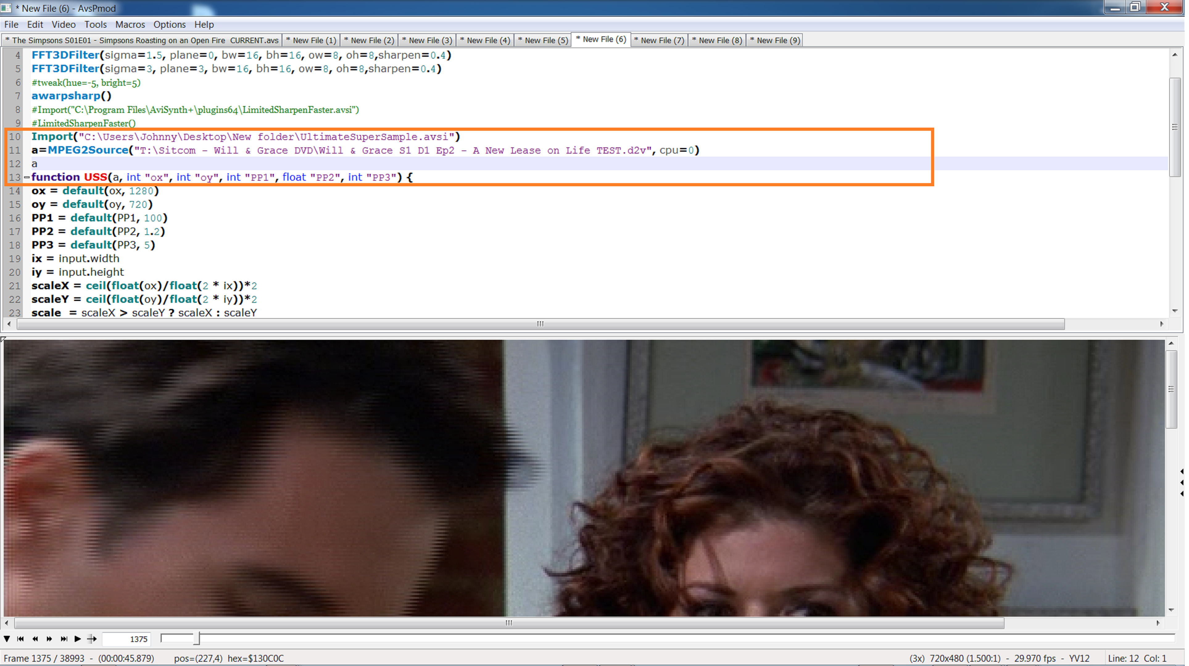

    So I found this code and I'm at a lost. I'm not exactly sure what digits to change. Change digits to 800 doesn't do anything. F5 on the keyboard and there are no errors. Not sure how to use "these" types of scripts/codes.
    https://forum.doom9.org/showpost.php?p=993939&postcount=2
    function Linedarken_toon(clip orig, float "sstrengtha", "sdboost", int "srange", "warpdepth", bool "fast")
    ###### parameters ######
    sstr	= string(default(sstrength, 180)/255.0)
    srange 	= default(srange, 0)
    sdboost = default(sdboost, 1.0)
    wdepth	= default(warpdepth, 8)
    fast	= default(fast, false)
    ###### filtering ######
    sharp	= orig.Unsharpmask(00, 4, 0)
    orig.mt_edge(thy1=3,thy2=255,mode="prewitt",Y=3,V=1,U=1)
    mt_lut("x "+string(srange)+" + 195 / 1.0 "+string(sdboost)+" / ^ 255 *",U=1,V=1).mt_inflate().mt_inflate().mt_inflate()
    linemask = mt_lutxy(orig, last, yexpr="300 1 x 255 / - 255 y - * x 1.14 ^ + - "+sstr+" *", uexpr="x", vexpr="x")
    fast==false ? mt_merge(orig, sharp, linemask, Y=3, U=2, V=2) :
    \	mt_lutxy(orig,sharp,"x y < 40 y < | x y x - 1 x 255 / - 2 ^ * 1 y 128 / - 4 ^ * "+sstr+" * x + ?",U=2,V=2)
    final	= wdepth<=0 ? last : awarpsharp(last,cm=1,depth=wdepth,blurlevel=1)
    return 	final

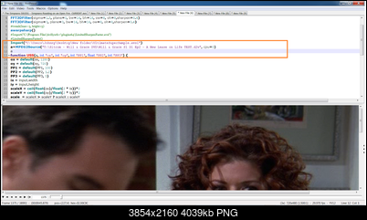

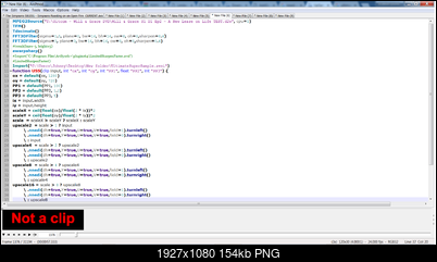

  10. Just call the function. Either Import("whatever.avs") , or copy function to the script
    eg.
    WhateverSource()
    Linedarken_toon(sstrength=180)
    A good way is to compare different scripts in different tabs. Hit the number keys to swap. E.g. tab 1 might have strenght of 10, tab 2 might have strength of 200, etc... in avspmod , the frames are aligned if you have to same dimensions, same framecount so the images are superimposed and aligned. You can seek to different times and they will keep alignment
    There are some spelling errors/typos in that script, there should be errors.
    float "sstrengtha" shouldn't have an "a" at the end ; or sstr = string(default(sstrength, 180)/255.0) should have an "a" at the end of strength
    If you look at the parameters, the strength range is only up to 255 (which is expected for 8bit) , but it does not have error logic to spit out a warning or error
    This looks like a line thinner mostly, but if your lines are from HD source you might not notice as much of a difference .

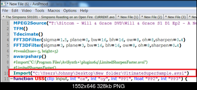

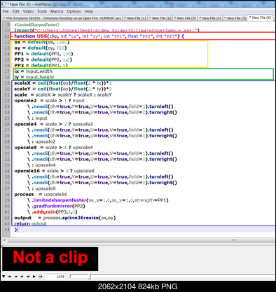

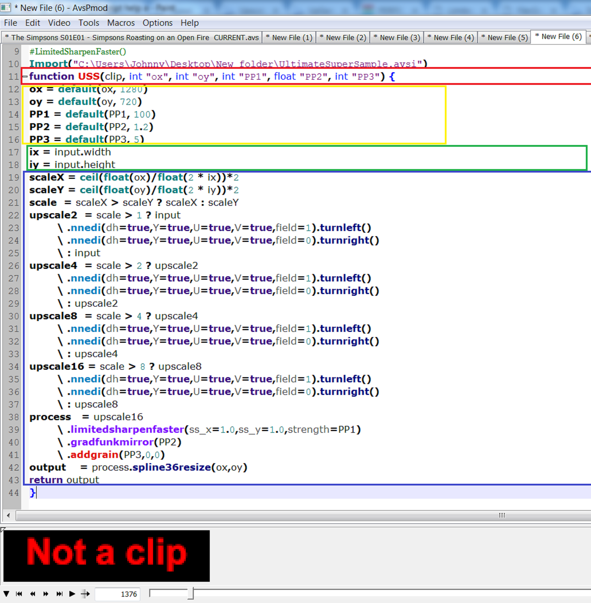

    So I'm still kind of confused with these "function" scripts. What I see is this in my brain. I see multiple variables (notice all the color locations) that I can change. My brain is basically all over the place, not sure where to start and end.
    In the following thread, a person mentioned, "Addborders" and where would I "addborders".
    USS(1232,688)
    Addborders(24,16,24,16)
    https://forum.doom9.org/showthread.php?t=138285
    Do I even touch anything in the bright green color?
    Do I change the blue "?" to a number, a word?
    Do I change the red numbers next to the blue "?" to a different number?
    Do I just everything inside the "function" parenthesis ( ) and leave everything inside the { } alone.
    function USS(clip input, int "ox", int "oy", int "PP1", float "PP2", int "PP3")
    Do I change the above string of function code to something with numbers
    function USS(clip input, 5 "ox", 6 "oy", 44 "PP1", 8 "PP2", 12 "PP3")
    Or Do I delete the "ox" "oy" "PP1" "PP2" "PP3" and go with something like this:
    USS(clip input, 5,6,44,8,12)
    And then with the word "clip," do I go about it this way:
    function USS(MPEG2Source("T:\Sitcom - Will & Grace DVD\Will & Grace S1 D1 Ep2 - A New Lease on Life TEST.d2v", cpu=0), int "ox", int "oy", int "PP1", float "PP2", int "PP3")
    Then with this section of the code:
    ox = default(ox, 1280)
    oy = default(oy, 720)
    PP1 = default(PP1, 100)
    PP2 = default(PP2, 1.2)
    PP3 = default(PP3, 5)
    Do I change them to something like so where I'm basically changing the numbers)?
    ox = default(ox, 9999)
    oy = default(oy, 888)
    PP1 = default(PP1, 700)
    PP2 = default(PP2, 600)
    PP3 = default(PP3, 500)
    Then there's this section of the code,
    ix = input.width
    iy = input.height
    scaleX = ceil(float(ox)/float(2 * ix))*2
    scaleY = ceil(float(oy)/float(2 * iy))*2
    scale = scaleX > scaleY ? scaleX : scaleY
    Do I change it like so ...
    1920 = input.width
    1080 = input.height
    scaleX = ceil(float(ox)/float(15 * ix))*60
    scaleY = ceil(float(oy)/float(25 * iy))*75
    scale = scaleX > scaleY 4 scaleX : scaleY
    Do I do anything with the nnedi location:
    .nnedi(dh=true,Y=true,U=true,V=true,field=0).turnright
    Do I change to something like this:
    .nnedi(dh=false,Y=false,U=true,V=true,field=15).turnright
    What about the word input, do I input something there?
    upscale2  = scale > 1 ? input
            \ .nnedi(dh=true,Y=true,U=true,V=true,field=1).turnleft()
            \ .nnedi(dh=true,Y=true,U=true,V=true,field=0).turnright(do I put anything in here?)
            \ : input
    What about the number "1' and "?' . Do i change these to different values
    upscale2  = scale > 10 50 input
            \ : input
Name:	AVSI script help b.png
Name:	AVSI script help d.png
ID:	45498Click image for larger version
Name:	AVSI script help a.png
ID:	45499Click image for larger version
Name:	AVSI script help c.png

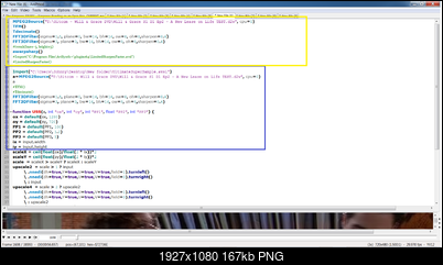

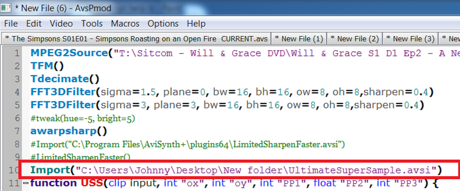

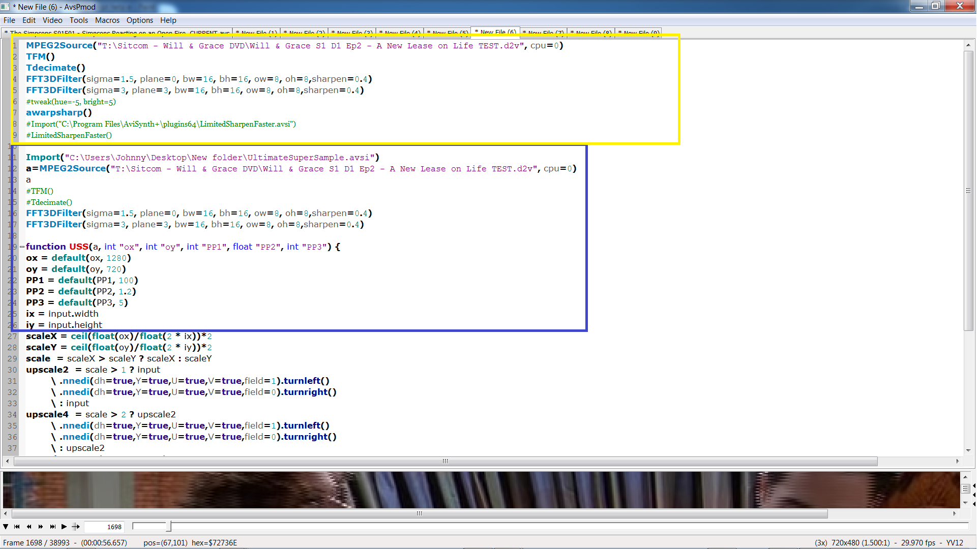

    Here's an example where everything above the orange rectangular box no longer applies to the imported video Will & Grace. TFM() and Tdecimate which is further up no long inverse telecines the Will and Grace. When I finally moved TFM() and Tdecimate below a=MPEGSource but above "function," then TFM() and Tdecimate would work. Do that mean this the following Import("C:\.......\UltimateSuperSample.avsi") must be on line 1 at the very top of the script? What if I have two types of these function scripts? Do I then have to put both MUST be at the top lines
    Line 1 MPEG2Source("T:\Sitcom - Will & Grace DVD\Will & Grace S1 D1 Ep2 - A New Lease on Life TEST.d2v", cpu=0)
    Line 2 Import("C\...\UltimateSuperScript.avsi")
    Line 3 Import("C\...\PerfectDENOIERScript.avsi")
    Line 4 TFM()
    Line 5 Tdecimate()
    Import("C:\Users\Johnny\Desktop\New folder\UltimateSuperSample.avsi")
    a=MPEG2Source("T:\Sitcom - Will & Grace DVD\Will & Grace S1 D1 Ep2 - A New Lease on Life TEST.d2v", cpu=0)
    a
Name:	AVSI script help e.png
ID:	45501Click image for larger version
Name:	AVSI script help 00.png
    And that is my brain all over the place with these "function" scripts. Not exactly sure where to start.

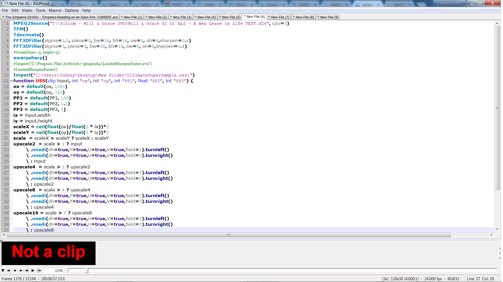

  18. You don't want to change function at all. You just include it within the body of your script. Then you call it from the main flow of your script:
    # this creates a function called USS
    function USS(blah...)
        blah...
    # You then call it just like any other function (filter):
    Mpeg2Source(blah...)
    TFM()
    TDecimate()
    USS(whatever options you want)
    Or you could save all the text of the function in an AVS script and import it rather than duplicating it all within your script.
    Import("\path\to\USS.avs")
    TFM()
    TDecimate()
    By the way, be careful with your use of Hysteria() with very strong settings like in your earlier scripts. Strength values like 10 will create lines in places where there were none before -- like any sharp boundary between a dark and light color.

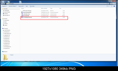

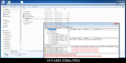

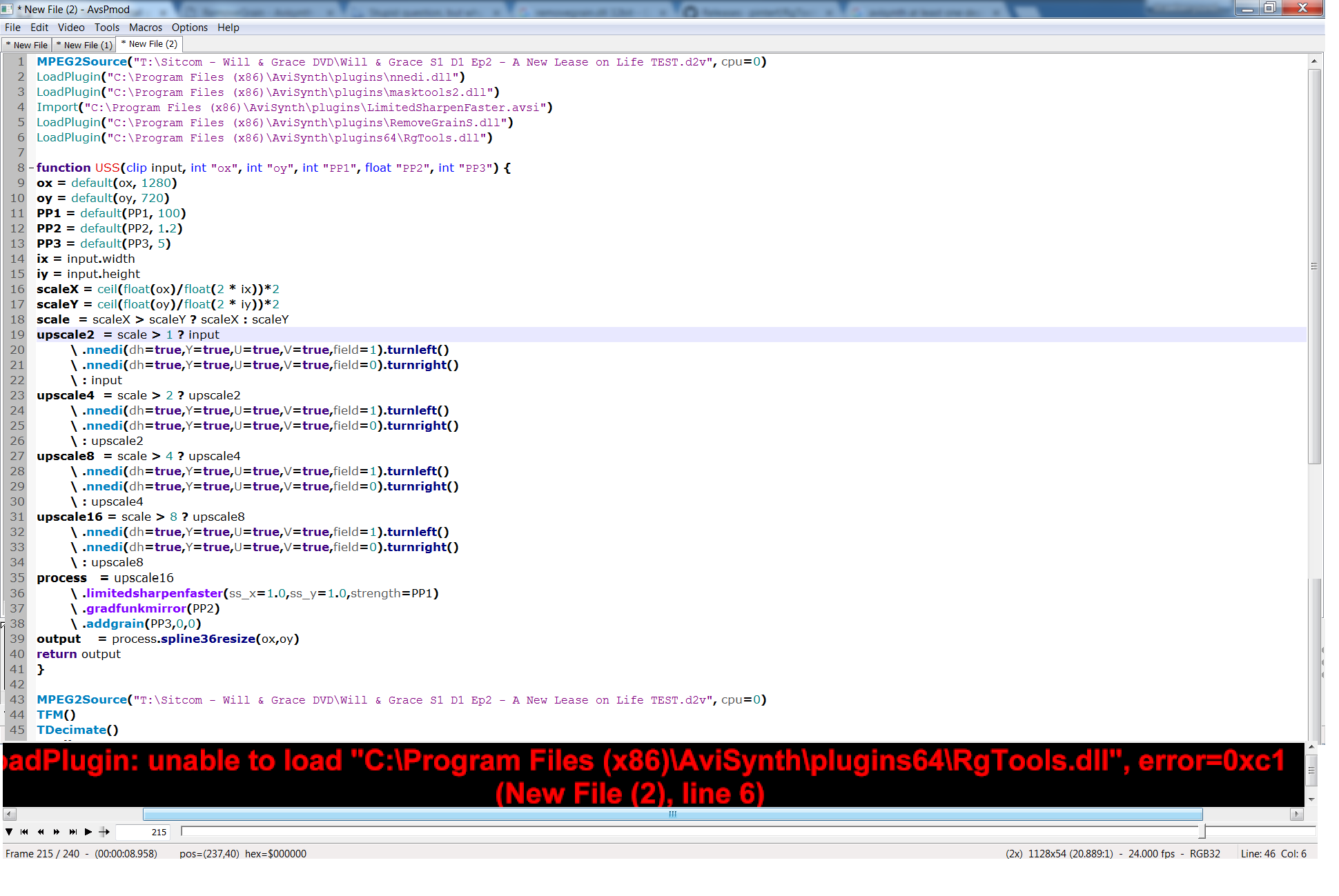

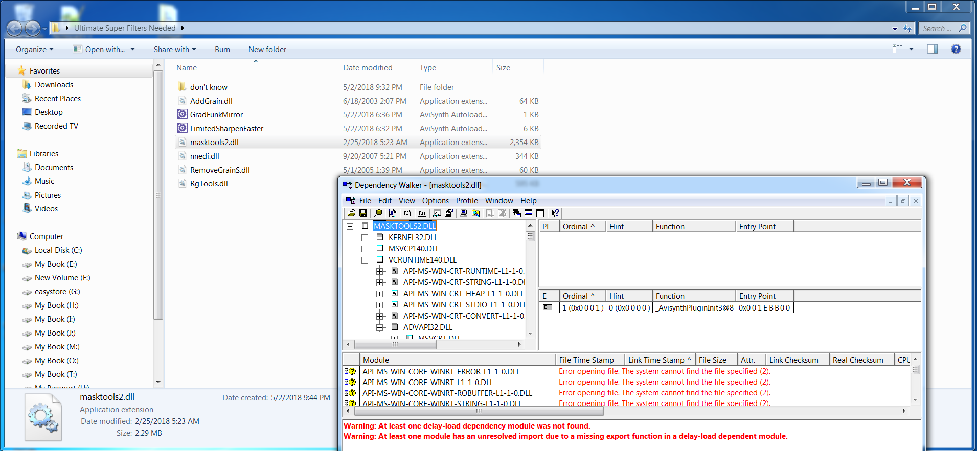

    As far as the "function" script goes, I think I may have entered it correctly, but then plugin requirements are throwing me off. I may just have to revisit this over the weekend or something. But the general gist of the problem is, I have both the Walker Dependancies 32bit and 64bit. What I think I'm suppose to do is just drag the .dll file extension onto either the 32bit or 64bit Walker Dependancy. 32bit .dll onto 32bit Walker; 64bit .dll onto 64bit Walker. If it prompts a red warning message, then it's probably not going to work unless I have some other "stuff" to make it compatible.
    Do you personally (or anyone else wants to chime in) try to upscale your SD DVD into a crisper ("HD-ish") effect? And what are the scripts that you use? I'm thinking about trying to do that with Seinfeld, Will and Grace, Frasier, Friends, Everybody Loves Raymond, etc. etc. I thought maybe getting the Ultimate Super Sample Function script could help, but can't get it to work because of the missing plugins or .dll or system requirements, etc.

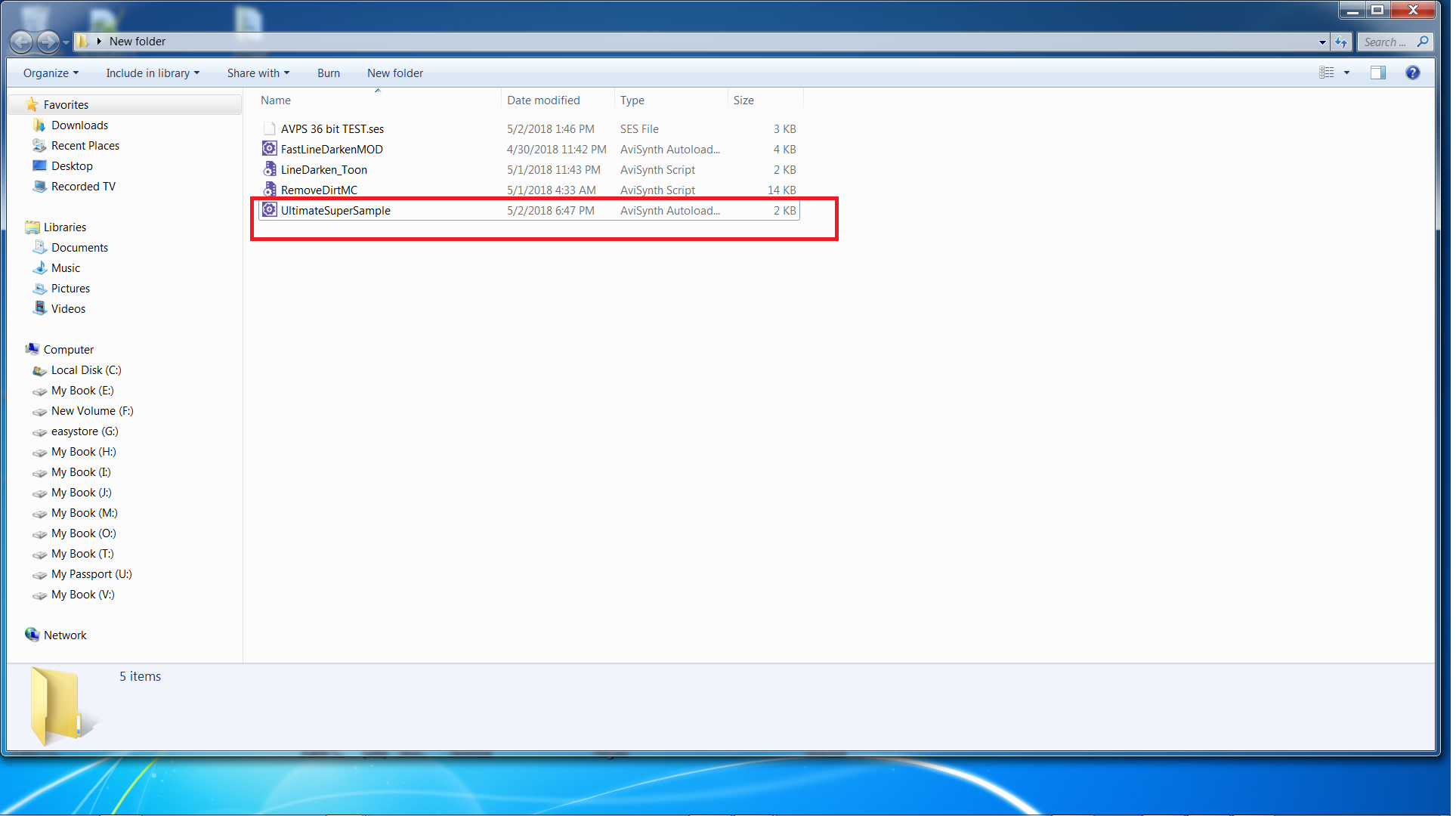

    As far as this "folder" is concerned, it's more of a temporary reminder of sort. I'm just keeping those in there so I remember which ones I copied and pasted into the 32bit Avisynth folder. If it doesn't work, I'll just delete them from the 32 bit folder plugin Avisynth program folder.

  24. Originally Posted by strawberryshortcake View Post
    AVSMeter will most likely point out the missing runtimes. Just run it with the "-avsinfo" switch.

    VOB original (DVD source)
    [Attachment 45513 - Click to enlarge]
    Avisynth
    [Attachment 45514 - Click to enlarge]
    VOB original (DVD Source)
    [Attachment 45516 - Click to enlarge]
    Avisynth
    [Attachment 45515 - Click to enlarge]
  29. Originally Posted by strawberryshortcake View Post
    If my VOB is already 720x480, the following would be pointless right?
    Yes. It might smooth out some edges and sharpen a bit.
    I realized people look kind of plastic with complete grain removal.
    For example, after your processing the guy's hair in the first pair shots looks like painted plastic, not hair. It's also over-sharpened with halos around all sharp edges.
