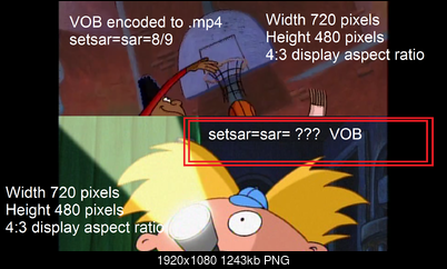

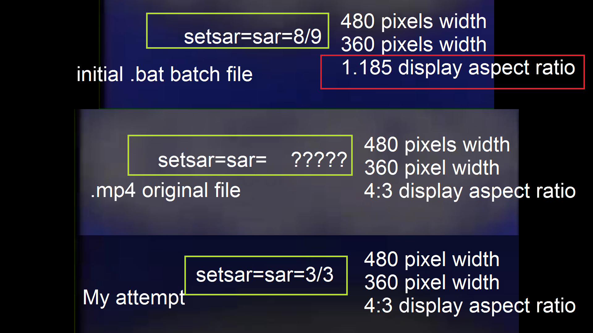

    Jagabo. Fantastic work. Absolutely Thank You. Is there something like this for .mp4, .mkv, etc.?
    The second code that you wrote for the time being is working like a champ. That's exactly what I wanted for .VOBs. And to add any filter I simply had to add "echo" to the beginning line and ^ before the closing parenthesis and "%%~A.avs" to the end of the line.
    Now I just have to figure out one of these automated processes for .mp4, .mkv, .avi, using Avisynth, or do you already have something working in place?

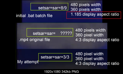

    Also, how do I interpret the syntax
    %%~dpnA.d2V
    CPU2="ooooxx"
    Info=3^
    %%~A.avs
    etc. etc

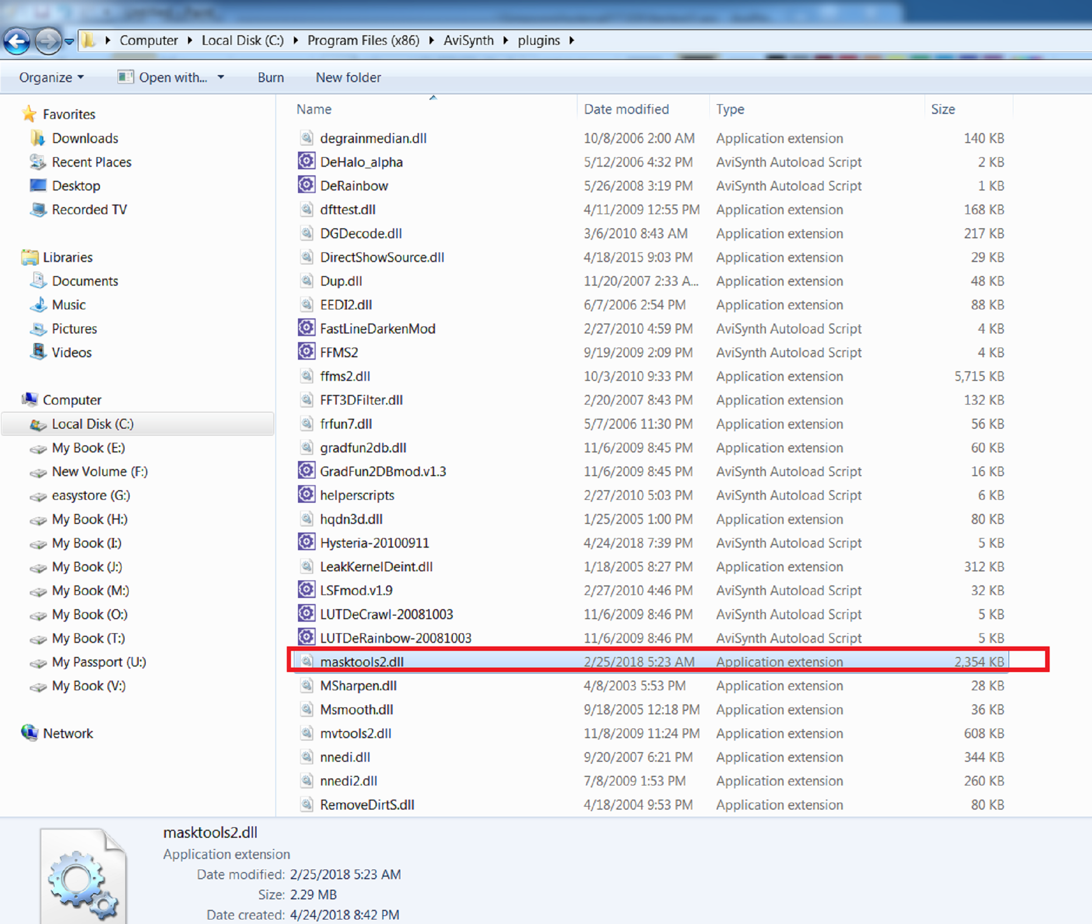

    Unfortunately the first code didn't really do anything. I also copied and pasted as much of it down below
Name:	Jagabo Script M.png

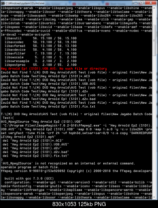

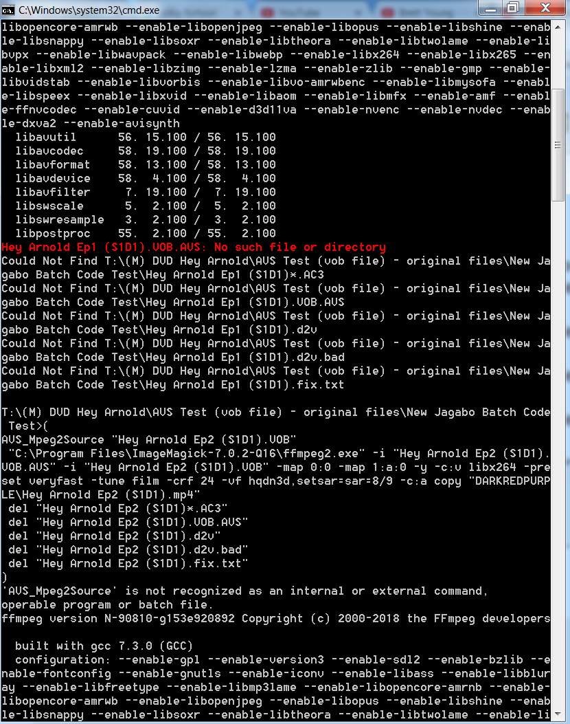

     del "%~nA.fix.txt"
    T:\(M) DVD Hey Arnold\AVS Test (vob file) - original files\New Jagabo Batch Code
     Test>(
    AVS_Mpeg2Source "Hey Arnold Ep1 (S1D1).VOB"
     "C:\Program Files\ImageMagick-7.0.2-Q16\ffmpeg2.exe" -i "Hey Arnold Ep1 (S1D1).
    VOB.AVS" -i "Hey Arnold Ep1 (S1D1).VOB" -map 0:0 -map 1:a:0 -y -c:v libx264 -pre
    set veryfast -tune film -crf 24 -vf hqdn3d,setsar=sar=8/9 -c:a copy "DARKREDPURP
    LE\Hey Arnold Ep1 (S1D1).mp4"
     del "Hey Arnold Ep1 (S1D1)*.AC3"
     del "Hey Arnold Ep1 (S1D1).VOB.AVS"
     del "Hey Arnold Ep1 (S1D1).d2v"
     del "Hey Arnold Ep1 (S1D1).d2v.bad"
     del "Hey Arnold Ep1 (S1D1).fix.txt"
    'AVS_Mpeg2Source' is not recognized as an internal or external command,
    operable program or batch file.
    ffmpeg version N-90810-g153e920892 Copyright (c) 2000-2018 the FFmpeg developers
      built with gcc 7.3.0 (GCC)
      configuration: --enable-gpl --enable-version3 --enable-sdl2 --enable-bzlib --e
    nable-fontconfig --enable-gnutls --enable-iconv --enable-libass --enable-libblur
    ay --enable-libfreetype --enable-libmp3lame --enable-libopencore-amrnb --enable-

    Hey Arnold Ep1 (S1D1).VOB.AVS: No such file or directory
    Could Not Find T:\(M) DVD Hey Arnold\AVS Test (vob file) - original files\New Ja
    gabo Batch Code Test\Hey Arnold Ep1 (S1D1)*.AC3
    gabo Batch Code Test\Hey Arnold Ep1 (S1D1).VOB.AVS
    gabo Batch Code Test\Hey Arnold Ep1 (S1D1).d2v
    gabo Batch Code Test\Hey Arnold Ep1 (S1D1).d2v.bad
    gabo Batch Code Test\Hey Arnold Ep1 (S1D1).fix.txt
     Test>(
    AVS_Mpeg2Source "Hey Arnold Ep2 (S1D1).VOB"
     "C:\Program Files\ImageMagick-7.0.2-Q16\ffmpeg2.exe" -i "Hey Arnold Ep2 (S1D1).
    VOB.AVS" -i "Hey Arnold Ep2 (S1D1).VOB" -map 0:0 -map 1:a:0 -y -c:v libx264 -pre
    LE\Hey Arnold Ep2 (S1D1).mp4"
     del "Hey Arnold Ep2 (S1D1)*.AC3"
     del "Hey Arnold Ep2 (S1D1).VOB.AVS"
     del "Hey Arnold Ep2 (S1D1).d2v"
     del "Hey Arnold Ep2 (S1D1).d2v.bad"
     del "Hey Arnold Ep2 (S1D1).fix.txt"
    libopencore-amrwb --enable-libopenjpeg --enable-libopus --enable-libshine --enab
    le-libsnappy --enable-libsoxr --enable-libtheora --enable-libtwolame --enable-li
    bvpx --enable-libwavpack --enable-libwebp --enable-libx264 --enable-libx265 --en
    able-libxml2 --enable-libzimg --enable-lzma --enable-zlib --enable-gmp --enable-
    libvidstab --enable-libvorbis --enable-libvo-amrwbenc --enable-libmysofa --enabl
    e-libspeex --enable-libxvid --enable-libaom --enable-libmfx --enable-amf --enabl
    e-ffnvcodec --enable-cuvid --enable-d3d11va --enable-nvenc --enable-nvdec --enab
    le-dxva2 --enable-avisynth
      libavutil      56. 15.100 / 56. 15.100
      libavcodec     58. 19.100 / 58. 19.100
      libavformat    58. 13.100 / 58. 13.100
      libavdevice    58.  4.100 / 58.  4.100
      libavfilter     7. 19.100 /  7. 19.100
      libswscale      5.  2.100 /  5.  2.100
      libswresample   3.  2.100 /  3.  2.100
      libpostproc    55.  2.100 / 55.  2.100
    Hey Arnold Ep2 (S1D1).VOB.AVS: No such file or directory
    gabo Batch Code Test\Hey Arnold Ep2 (S1D1)*.AC3
    gabo Batch Code Test\Hey Arnold Ep2 (S1D1).VOB.AVS
    gabo Batch Code Test\Hey Arnold Ep2 (S1D1).d2v
    gabo Batch Code Test\Hey Arnold Ep2 (S1D1).d2v.bad
    gabo Batch Code Test\Hey Arnold Ep2 (S1D1).fix.txt
     Test>(
    AVS_Mpeg2Source "Hey Arnold Ep3 (S1D1).VOB"
     "C:\Program Files\ImageMagick-7.0.2-Q16\ffmpeg2.exe" -i "Hey Arnold Ep3 (S1D1).
    VOB.AVS" -i "Hey Arnold Ep3 (S1D1).VOB" -map 0:0 -map 1:a:0 -y -c:v libx264 -pre
    LE\Hey Arnold Ep3 (S1D1).mp4"
     del "Hey Arnold Ep3 (S1D1)*.AC3"
     del "Hey Arnold Ep3 (S1D1).VOB.AVS"
     del "Hey Arnold Ep3 (S1D1).d2v"
     del "Hey Arnold Ep3 (S1D1).d2v.bad"
     del "Hey Arnold Ep3 (S1D1).fix.txt"
    operable program or batch file.?

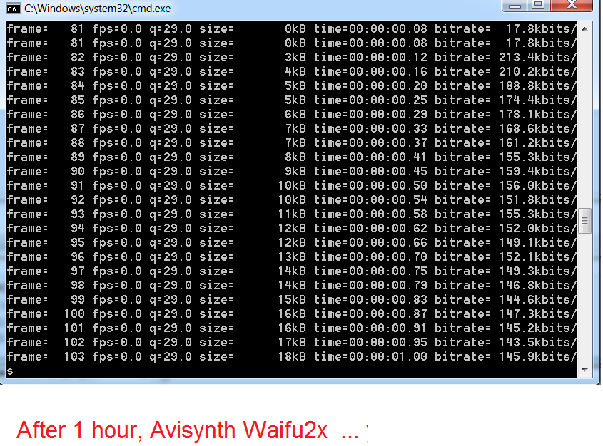

    Hey Arnold Ep6 (S1D2).VOB.AVS: No such file or directory
    gabo Batch Code Test\Hey Arnold Ep6 (S1D2)*.AC3
    gabo Batch Code Test\Hey Arnold Ep6 (S1D2).VOB.AVS
    gabo Batch Code Test\Hey Arnold Ep6 (S1D2).d2v
    gabo Batch Code Test\Hey Arnold Ep6 (S1D2).d2v.bad
    gabo Batch Code Test\Hey Arnold Ep6 (S1D2).fix.txt
     Test>pause
    Press any key to continue . . .

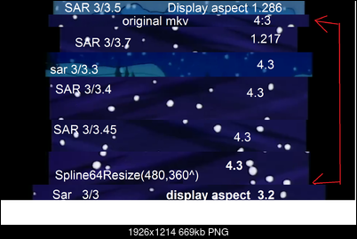

    Two concerns for this particular post:
    (1) Do my codes for .mp4 modified from your .vob .bat batch script look correct?
    (2) setsar=sar=8/9 value/expression and how it affects display aspect ratio.
    Just wanted to ensure the following are close to correct ...

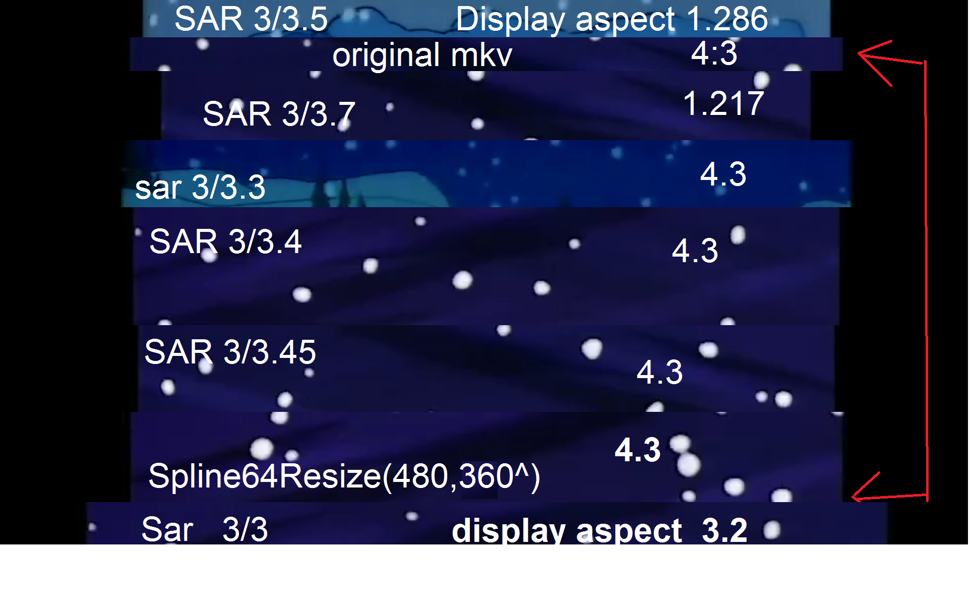

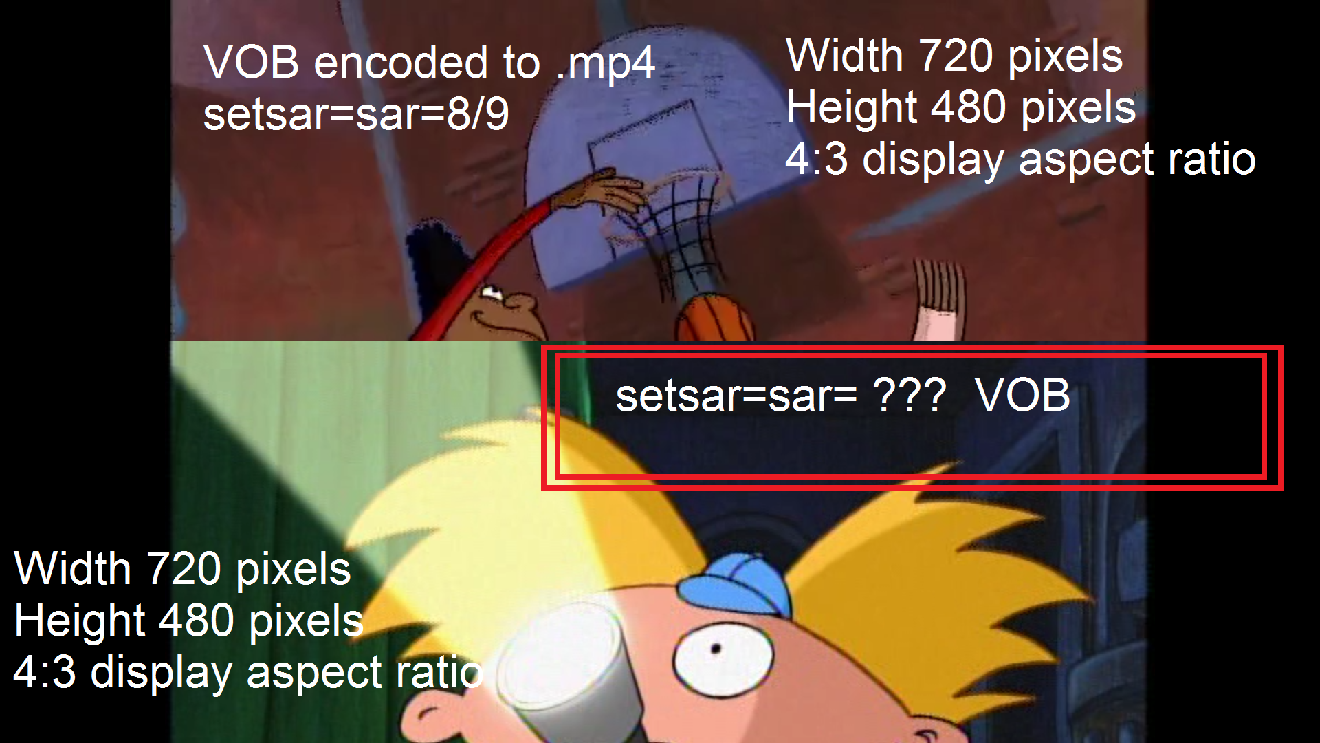

    Part 2:
    setsar=sar=8/9. That expression worked perfectly fine to keep the display aspect ratio the same for .vob files and the subsequently converted .mp4 output file. But setsar=sar=8/9 did not sit so well with the original .mp4 files; setsar=sar=8/9 converted the original .mp4 file to an output new .mp4 with a display aspect ratio of 1:1.85. I adjusted the value to setsar=sar=3/3. Visually it looks correct, but is it actually properly correct?
    The most important question/concern is how do I determine the proper setsar=sar=??? value. Obviously, I would simply run the batch .bat file on a couple .mp4 first to determine the result, and make adjustments if needed, prior to running the .bat script on a larger number of .mp4 of the same show.
    The width of the rectangle is the width of the video. There are three stacked side by side.
    Top rectangle - .mp4 converted to .mp4 setsar=sar=8/9
    Middle - .mp4 original (did not undergo conversion)
    Bottom - .mp4 adjustment (I tried fiddling around the the setsar=sar=sar value as much as I could and came to the conclusion that setsar=sar=3/3 help get me the closest to a display aspect ratio of 4x3 (fullscreen); which matches up to the original .mp4 file. sar=8/9 kept the aspect ratio the same for .vob file, at least in this one example.
Name:	Jagabox Aspect Ratio (SAR) f.png
Name:	Jagabox Aspect Ratio (SAR) e.png
  11. mp4 files are unlikely to contain telecined film so TFM().TDecimate() usually won't be needed. In you second script there is no AC3 file to delete. mp4 files are most likely to be square pixel, sar 1:1 (3:3 will work too). Or you can just leave out the setsar parameter and players will assume the videos are square pixel. Hysteria isn't appropriate for video other than cartoons. With cartoons you probably want -tune animation. Only use hqn3d if you need it. And consider changing the preset and crf.
    May 2016

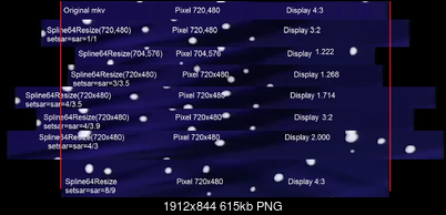

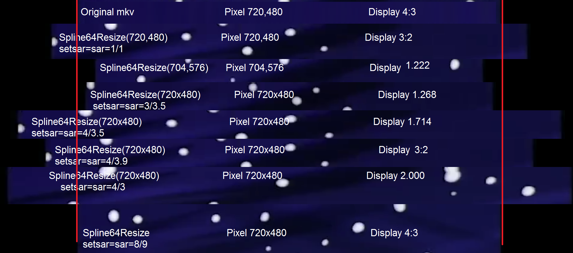

    EDIT: Disregard everything below for now, let me run a few more test. It should have been 720x480 not 480x360. Let me redo something.
    Update. Additional curiosity about the Sar and its effect on the display aspect ratio ... versus Spline64Resize.
    Doing several test runs using setsar=sar=?/? and nothing really completely "matches" the actual physical dimensions when played through VLC player. However, mediainfo does verify that certain setsar=sar=X/X do match the display aspect ratio of the test runs to the original mkv file. It's just that the visual inspection conflicts with mediainfo (picture below).
    On the other hand, using Spline64Resize (480,360) on first test run matches both the original .mkv file and the convert .mp4 DAR (display aspect ratio) for Mediainfo and on visual inspection when played through VLC player.
    Original mkv file 480/360 pixel (width/height); Display Aspect Ratio 4:3
    echo Spline64Resize(480,360^) >> "%%~A.avs" => Display Aspect Ratio 4:3
    Note: I did try to leave out setsar=sar=X/X but it didn't work. It's when I simply used Spline64Resize minus setsar did it finally work.
    Side Remark: I don't know if it's because the .mkv file was encoded with HVEC, but I had to add format="YUV420P8" to the code in order to get the picture right. Without format="YUV420P8", the picture was completely screwed up, green outline, purple,yellow, etc outlines everywhere. The only way I figured this out was when I dragged the original .mkv file into AVSPmod and in the script it show format="YUV420P8" immediately after the input file name.
    And yes, I'll fiddle with the different values such as CRF, tuning, etc depending on which video I want to convert. But just trying to get a "final blueprint" first for .vob, .mp4, .mkv files first.
Name:	SAR vs Spline64.png

  13. The HEVC video may have been 10 bit, not 8 bit, hence the need to specify the format.
    The equation for aspect ratios is:
    DAR = FAR * SAR
    DAR is the display aspect ratio, the final shape of the displayed picture
    FAR is the frame size aspect ratio, ie, width:height of the stored frame
    SAR is the sampling aspect ratio, the relative distance between samples horizontally and vertically,
        SAR sometimes call pixel aspect ratio, PAR, the shape of individual pixels
    So a 480x360 frames with a SAR of 1:1:
    DAR = FAR * SAR
    DAR = 480:360 * 1:1
    DAR = (480/360) * (1/1)
    DAR = 480/360 * 1
    DAR = 1.333... = 4:3
    With a 720x480 4:3 DAR DVD:
    DAR = FAR * SAR
    4:3 = 720:480 * SAR
    SAR = (4:3) / ( 720:480)
    SAR = (4/3) / (720/480)
    SAR = 1.333 / 1.5
    SAR = 0.888... = 8:9
    But there is a discrepancy between the MPEG 2 spec (used on DVD) and the ITU rec.601 video capture spec regarding aspect ratios. MPEG 2 directly supports only four aspect ratios: 4:3 DAR, 16:9 DAR, 2.21:1 DAR, and 1:1 SAR. Only two of those are allowed on DVD: 4:3 DAR and 16:9 DAR. And the spec says the DAR comes from the full frame size, 720x480 in our case. From that you can calculate the aforemetioned 8:9 SAR. But the ITU spec for video capture says the 4:3 picture in a 720x480 frame is in the inner 704x480 portion, meaning the SAR is 10:11 and the full 720x480 frame is slightly wider than 4:3. (The wider frame is captured in case the source or capture device is slightly off center.) When analog tape sources are captured for DVD they usually use ITU compliant devices. But the frame isn't reduced to 704x480 for DVD (even though DVD supports that size), it's left at 720x480 and flagged as 4:3 DAR, ignoring the difference between the MPEG 2 and ITU specs. So don't be surprised if you see people saying 4:3 DVD SAR is 10:11. Some software uses one, some the other.
    DAR = FAR * SAR
    DAR = FAR * SAR
    DAR = 480:360 * 1:1
    DAR = 480/360 * 1
    DAR = FAR * SAR
    4:3 = 720:480 * SAR
    SAR = 1.333 / 1.5
    Update. Everything is all good now. Not sure what happened earlier but retesting sersar=sar=8/9 works perfectly fine now. I don't know why the encoded video pixel size was 480x360, but now it's back 720x480, and the display aspect ratio is now the same as the original mkv when measured using vlc player (simply visual observation, copy paste onto paint program, overlay the image on top of one another). Guess I did more work than needed.
    Mediainfo also confirms that values are now correct using 8/9 sar for both the original mkv and the newly encode .mp4
    And yes the Hvec was a 10bit. The newly encoded .mp4 file is now 8bit after adding format="YUV420P8".
    Not sure if Spline64Resize(720,480) is necessary in the code/script but I guess I can leave it in there...
Name:	SAR vs Spline64 2.png
    EDIT: I'm surprise this forum doesn't have like a stickied list of avisynth code for specific encodes. The one that you created for me should be stickied somewhere and referred to as the jagabo code for _____
  15. If your video is already 720x480 Spline64Resize(720,480) will do nothing.

    Attempting to test out Waifu2x (32 bit) Avisynth plugin, but am getting an error message:
    Cannot load a 32 bit DLL in 64 bit Avisynth: 'C:/Program Files (x86)/AviSynth/Plugins/Waifu2xAvisynth.dll'
    I believe I have both Avisynth version (32 and 64bit installed). The following is my plugins folder for the (x86) 32 bit AviSynth. Disregard the red box. This picture is a screenshot I created a few days ago that pertains to something else.
Name:	Avisynth HYSTERIA fixmaybe b.png
    I doubled clicked on my personalization of a jagabo .bat batch blueprint file and get the error code above. How do I get my "code" to "use" or "point" to using the 32 bit Avisynth just for this code alone. Yes, the above Waifu2xAvisynth.dll plugin is in the (x86) 32 bit Avisynth plugin folder. I've already checked my Avisynth+ (64bit) plugin folder and Waifu2xAvisynth.dll is not in there.
    The code probably has redundant filters, maybe. And the order of the filters maybe incorrect, not sure yet.
    if not exist FLOWERPOWERsantig33andhysteria10___32bit2 md FLOWERPOWERsantig33andhysteria10___32bit2
    for %%A in ("*.mkv") do (
        echo Import("C:\Program Files (x86)\AviSynth\plugins\FastLineDarkenMod.avsi"^) >> "%%~A.avs"
        echo LWLibavVideoSource("%%A",format="YUV420P8"^) > "%%~A.avs"
        echo LoadPlugin("C:\Program Files (x86)\AviSynth\plugins\Waifu2xAvisynth.dll"^) >> "%%~A.avs"
        echo Waifu2x(nr=2, scale=1, jobs=1, models="C:\Program Files (x86)\AviSynth\waifu2xAvisynth-models\models"^) >> "%%~A.avs"
        echo FFT3Dfilter(sigma=1.5, bt=5, bw=32, bh=32, ow=16, oh=16, sharpen=0.4, plane=4^) >> "%%~A.avs"
        echo RemoveGrain(mode=1, planar=false^) >> "%%~A.avs"
        echo FastLineDarkenMOD(^) >> "%%~A.avs"
        echo Hysteria(strength=10, usemask=true, lowthresh=20, highthresh=50, luma_cap=250, maxchg=255, minchg=0, showmask=false^) >> "%%~A.avs"
        echo Santiag(3,3^) >> "%%~A.avs"
        "C:\Program Files (x86)\AMVpack\AMVtool64\ffmpeg.exe" -i "%%A.AVS" -i "%%A" -map 0:0 -map 1:a:0 -y -c:v libx264 -preset veryslow -tune animation -crf 24 -vf hqdn3d,setsar=sar=8/9 -c:a ac3 -ac 2 -b:a 128k "FLOWERPOWERsantig33andhysteria10___32bit2\%%~nA.mp4"
        del "%%A.AVS"
        del "%%~nA*.LWI"
    pause
  18. 32 bit plugins can't be used by 64 bit AviSynth, and vice versa.
    If you have both 32 bit and 64 bit AviSynth installed: if you open a scrip with a 32 bit editor/player you will end using 32 bit AviSynth, if you open a script with a 64 bit editor/player you will be using 64 bit AviSynth.
    By the way, the waifu2x plugin is very very slow. After a few test you won't end up using it.
    May 2016
    I guess I'll put this in the back burner for now and re-try it during the weekend because it didn't quite work. I downloaded notepad++ (32bit), reopened the .bat batch file, save it using Notepad++(32bit), double clicked on the .bat file and it still said
    [Fatal]: failed to avformat_open_input. (Hysteria (.mkv) FINAL - waifux test 32bit - Copy (notepad 32bit).AVS, line 1 Hysteria (.mkv) FINAL - waifux test 32bit - Copy (notepad 32bit).AVS: Unknown error occured

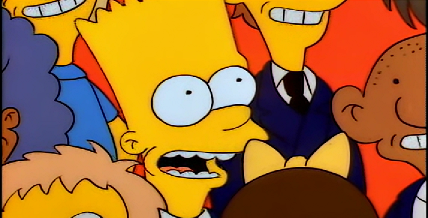

    But more important, I simply wanted to use Waifu2x or any filter that will clean up the "noise" around solid lines for animations.

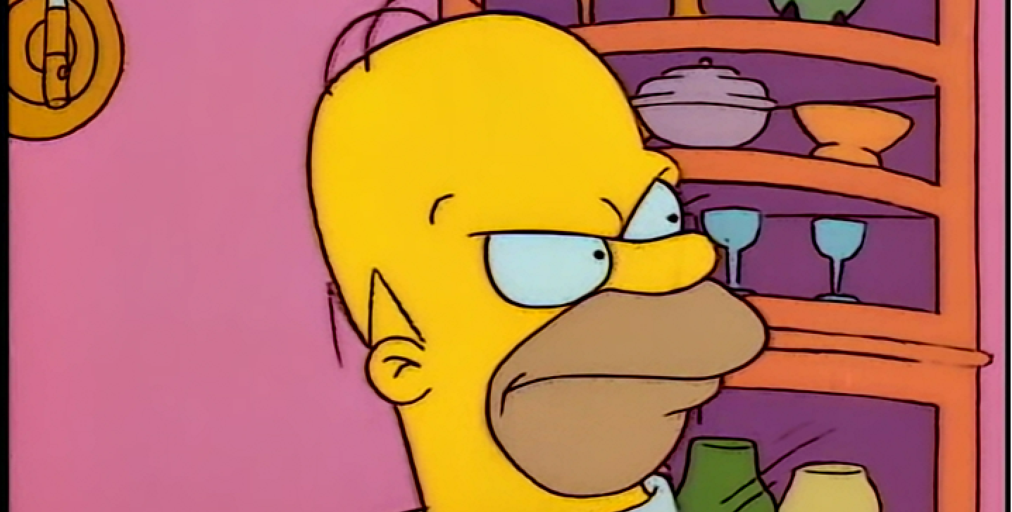

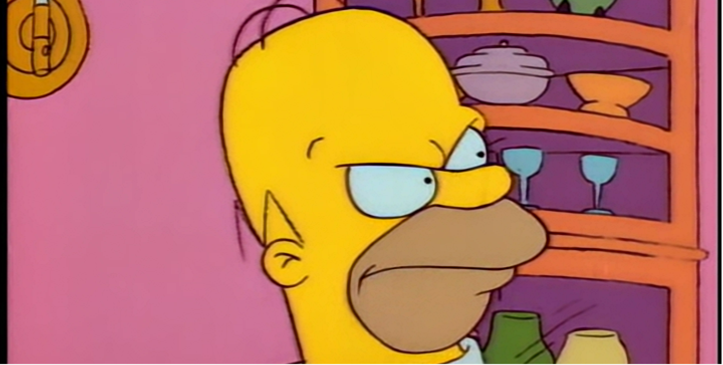

    What's the most effective way to denoise or remove noise around solid lines in cartoons/animation? Also what exactly are these "noise" "artifacts" called?
    Both of these have hysteria and fastlinedarkenmod applied and introduced a bit more of these noise/artifacts but ultimately my main goal was to darken the lines so that was achieved. But I want to know how to "remove" "eliminate" or "minimize" the noise.
Name:	Noise test a NOISE.png
ID:	45475Click image for larger version
Name:	Noise test a.png

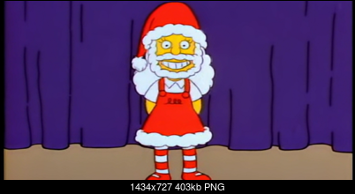

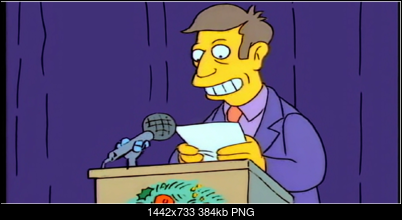

    TWO CONCERNS: how to minimize or remove noise around solid lines? Which filter to use?
    (1) Better denoise / noise removal (or minimize) tool
    (2) Connect the dots for solid lines that aren't quite solid (last set of images below; notice Bart's eyes on the top and Bart's eye on the bottom image. They are two different frames. Both frames already have the hysteria and fastlinedarkenmod applied)
    FIRST CONCERN
    Set of images below has two critical plugin filters applied (top image - filter applied, bottom image no filter applied):
    (A) Hysteria
    (B) FastlineDarkenMod

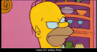

    Notice when you enlarge the top image of homer (hysteria and fastlinedarkenmod applied to just the top image), homer does have noise around the solid lines. Trying to get rid of these.
Name:	Noise test b (hysteria fastlinedarkenmod).png

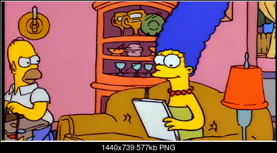

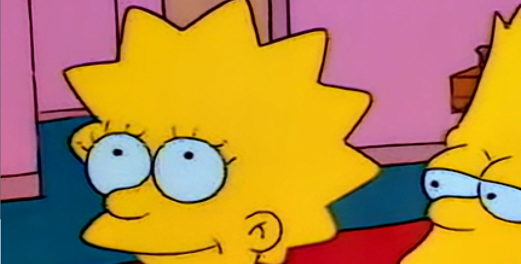

    SECOND CONCERN: connect the dots?
    Secondly, is there an Avisynth filter that will "connect" the dots. Notice the lining on Bart's eye is scattered/patches of disconnected dots. The same bart image below is a couple frames after and notice how the lines are solid. Is there a filter that can "connect" these dots?
Name:	Noise test g (disconnect).png
ID:	45468Click image for larger version
Name:	Noise test g (solid).png
  20. Originally Posted by strawberryshortcake View Post
    Those are DCT ringing artifacts. They come from lossy compression and are exacerbated by sharpening and line darkening filters. They can be reduced with noise reduction filter but you may loose detail in other parts of the picture. One way to reduce that is to use an edge mask so the strong noise reduction is only applied near edges. Something like:
    # YV12 video
    before = last
    UnDot() # removes some single dots
    TNLMeans(Ax=3, Ay=3, Az=1) # general 3d noise reduction
    edgemask = mt_edge().mt_expand().mt_inpand().mt_inpand().mt_expand().mt_expand().mt_expand(chroma="-128").BinomialBlur(3.0) # a mask of edges, expanded and blurred
    Overlay(before ,last, mask=edgemask) # only apply TNLMeans near edges, preserves detain in other parts of the picture
    TNLMeans is slow but far faster than Waifu2x.
    One hint: in your batch files remove the line that deletes the AVS script. Then you can examine the script to be sure it contains what you intended.
  21. The last one, the "disconnected dots" looks like a deinterlaced frame (deinterlacing artifacts, aliasing) . Frame is resized so it's difficult to say for certain.
    It might be from a bad IVTC (missing match), or it might be bad source . The batch says "mkv" so if that was from makemkv, it might be from that (mpeg2 in mkv has potential for lots of problems)

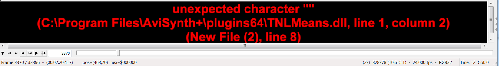

    I ensured the .dll was 64bit. I tested out both KNLmeans.dll and TNLmeans.dll. Both came back with the unexpected character "" error. I opened both .dll files with Notepad++ but that failed miserably. They were basically giberrish symbols.
    Import("C:\Program Files\AviSynth+\plugins64\TNLMeans.dll")
    Question: Also how do I know when to use IMPORT vs LOADPLUGIN?
    Does it have anything to do with the extension?
    Import (.avs) vs. Loadplugin (.dll)
      echo Import("C:\Program Files (x86)\AviSynth\plugins\FastLineDarkenMod.avs"^) >> "%%~A.avs"
        echo Import("C:\Program Files (x86)\AviSynth\plugins\Santiag.avs"^) >> "%%~A.avs"
    According to the following website, Santiag doesn't have a 64bit plugin...
    http://avisynth.nl/index.php/AviSynth%2B_x64_plugins
    http://avisynth.nl/index.php/Santiag
    Also for some reason, in AVSPMod, I don't have F5 works when the Santiag value changes and I didn't use Import or Loadplugin.

    Managed to get Waifu2x to work, and
    [Attachment 45481 - Click to enlarge]
    [Attachment 45482 - Click to enlarge]
    19KB finished after 1 hour. Almost 1 second of video.
    [Attachment 45483 - Click to enlarge]
    That's going into the "to never do again pile". Waifu2x is not going to work until I upgrade my computer.

  24. Regarding tnlmeans, post your entire AVS script.
  25. Member
    May 2016
    Now, it works. Had to dig a bit deeper to find the treasure.

    Haven't added all the filter, but this is just a test run in AVSPmod 64 bit to see if it works using the preview F5 function (or simply mouse clicking the preview screen will automatically preview the changes)
    LWLibavVideoSource("U:\( Folder ) External\-----------Simpsons @@@@  (4 x 3 versions)\The Simpsons S01E01 - Simpsons Roasting on an Open Fire.mkv", format="YUV420P8")
    FastLineDarkenMOD()
    FFT3Dfilter(sigma=1.5, bt=5, bw=32, bh=32, ow=16, oh=16, sharpen=0.4, plane=4)
    RemoveGrain(mode=1, planar=false)
    Hysteria(strength=50, usemask=true, lowthresh=20, highthresh=50, luma_cap=250, maxchg=255, minchg=0, showmask=false)
    Santiag(3,3)
    LoadPlugin("C:\Program Files\AviSynth+\plugins64\TNLMeans.dll")
    TNLmeans(Ax=3, Ay=3, Az=1)
  26. Member
    May 2016
    On the other hand, I might have to find something else other than undot seeing as how there's not a 64bit version. I could move everything over to the 32bit AVSPmod though. That would be my last resort.
  27. Originally Posted by strawberryshortcake View Post
    RemoveGrain(1) is the same as undot, except faster
  28. Member
    May 2016
    Is it the one I'm already using? Even though I don't see the RemoveGrain.dll in my plugin 64bit folder but for whatever reason it works in AVSPMod.
    I did see a RemoveGrainHD though.
    FastLineDarkenMOD()
    Santiag(3,3)
  29. For waifu2x - the avisynth version never got optimizations , and was abandoned. No SIMD , nothing like SSE2/AVX support. No GPU support. It's basically unusable
    It's available in vapoursynth with optimizations. The caffe (cuda) version is much faster (depending on nvidia card, maybe 20-200x faster) . But even the w2xc version is probably 10-20x faster than the avisynth version because it can use SSE2/AVX , even OpenCL (both AMD and Intel).
    But its not fun using vapoursynth at first unless you're familiar with python. More difficult to learn than avisynth. I'm a good test subject because I don't have any programming knowledge
  30. Originally Posted by strawberryshortcake View Post
    For x64 it's available through RgTools . It's a re-write of the original RemoveGrain . But you still call it in the script RemoveGrain(whatever settings) ; it's just that the .dll is RgTools.dll
